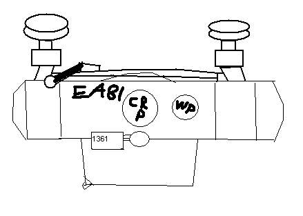

why not make a manifold...one for each intake port, and set a little webber on top of it.
DUDE! ive been thinking exacly that. you could do it with any motor. your sketch is just what i was thinking. my dual carb manifold the mounting points are too close together for a weber 32/36 and it would be overcardberated anyway. i'm looking into a couple of 28/36 or some weber one barrells. but with little mini manafolds on each side, you would have more options.
i hae a 28/32 i will trade you for a 32/36 DGV series, this is a DFAV
