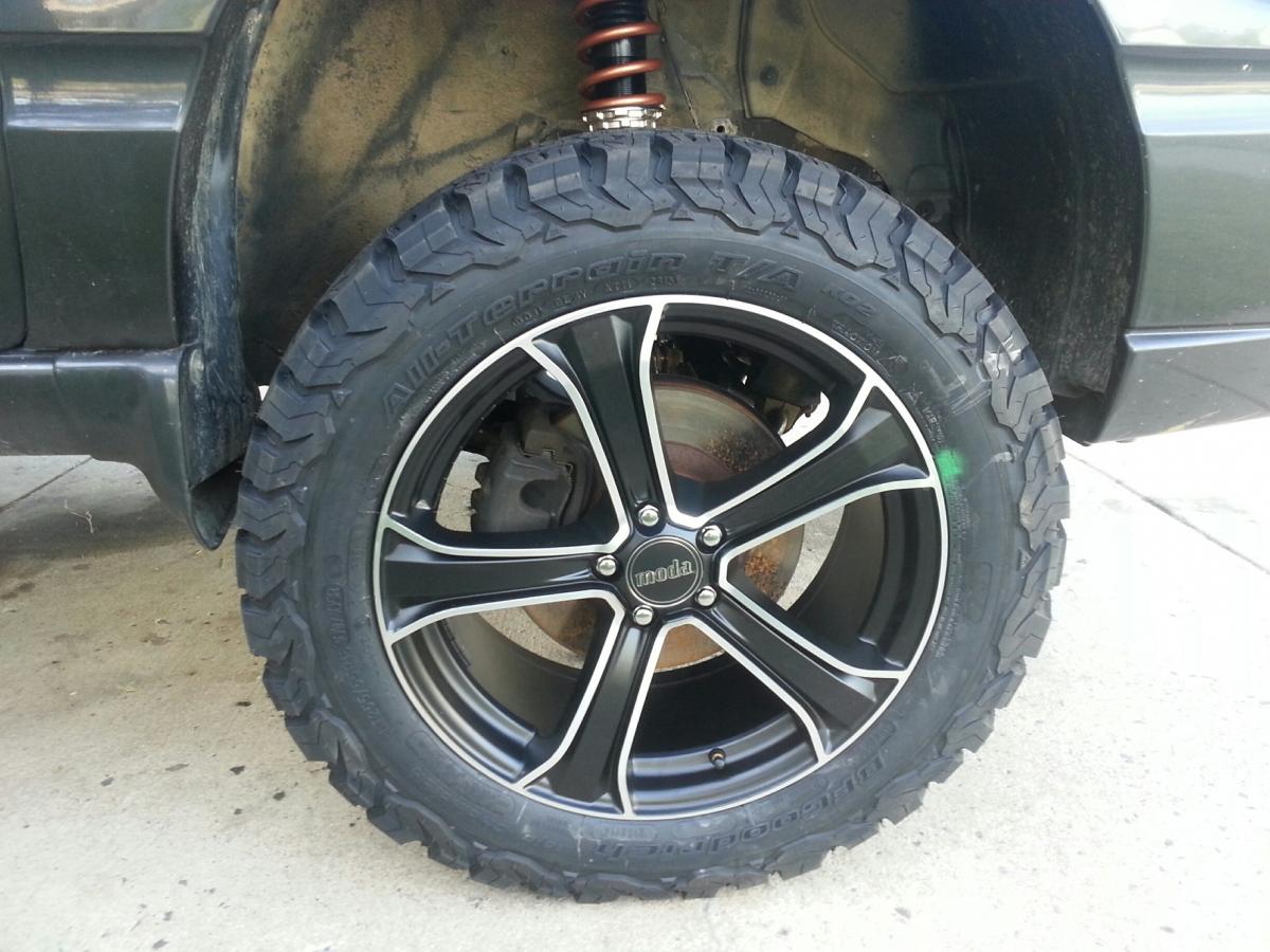

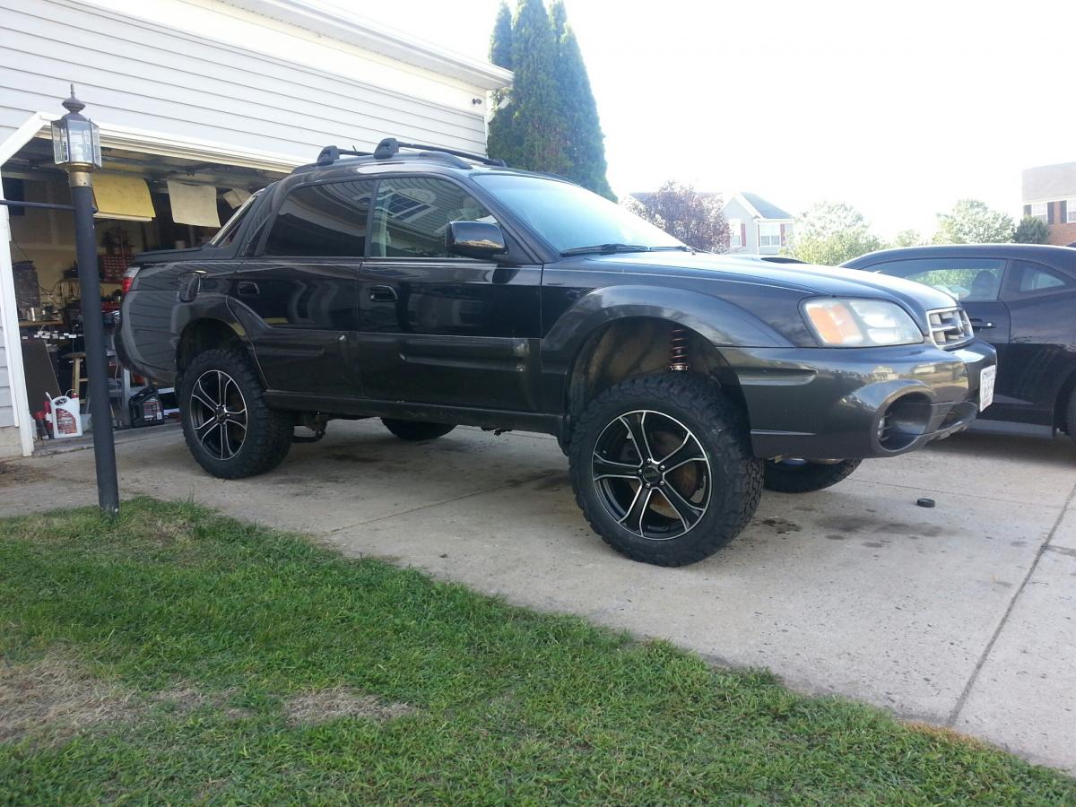

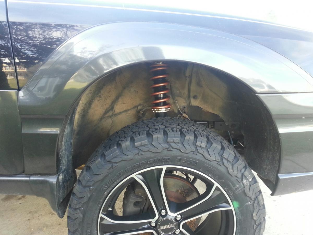

Finally some progress to report. I had been sitting on the lift and suspension waiting till closer to the predicted time that the 255/55/18 KO2 tires would be available and started in on the lift last week. Much to my surprise the tires showed up as in stock at tirerack about 2 days ago and they showed up today! As it sits now the 5in lift is installed and coil overs are set to the same height as stock, I can adjust about 1.5 in up or 1.5 in down from how it sits now. The big metal bits of the lift are in and if all goes well I should have the various hoses and linkages etc all done this week. Then I have to sort out the intercooler and an air plenum for it, so maybe drive it next next week after the exhaust is done too? Then it is STi brakes, tube bumper, and then a dip job. The engine was finished about 2 months ago.

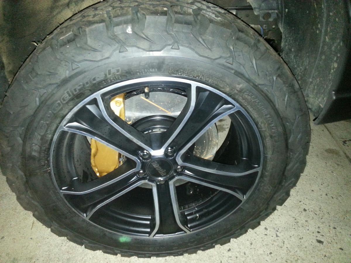

On to the brakes, an interesting project for sure. The fronts are STI 2004 rotors with STi Brembo calipers and Hawk brake pads. The rears shot the cost up a bit, caliper adapter brackets and special DBA rotors that have the STi outer diameter and the WRX(Baja) parking brake with adapters upped the total swap from $1600 t0 about $2200 but stopping this thing as fast as it goes is important.

Haven't driven it to test full lock under travel yet, but it looks good. I can dial in more height on the coilovers and can do the same re-profile of that inner rear corner that I did on the other lifted Baja so I have plenty of wiggle room. Funny thing though, of all the work done the one question asked by anyone is do they rub. the only thing holding up progress now is waiting on the stupid caliper paint, I overhauled these 04 calipers and no point in assembling the brakes until they are painted since it is easier to paint off the truck.

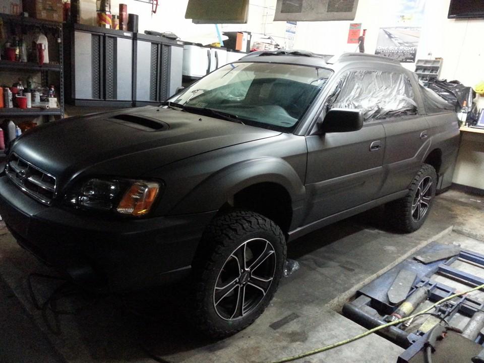

Speaking of paint, I decided to do a matte black dip job, if you scratch it you can peel it off and respray, should be perfect for slinging gravel. The dip kit arrived and I will be prepping the truck and painting it as soon as I get the brakes finished up. If you haven't seen this system it is a really neat process. You can do some interesting finishes, a bunch if videos can be found here: http://www.dipyourcar.com/Videos-and-Guides.html

The short version is that you clean the car and remove wax, then mask windows, lights etc. and spray about 5 layers of thinned plasti-dip like material onto the car. Lasts about 4 years and you can peel and respray when you like. $200~$300 to do a car if you have a spray gun. It started off as just ordinary plastidip like you use for tool grips but now it is a huge range of specialized products.

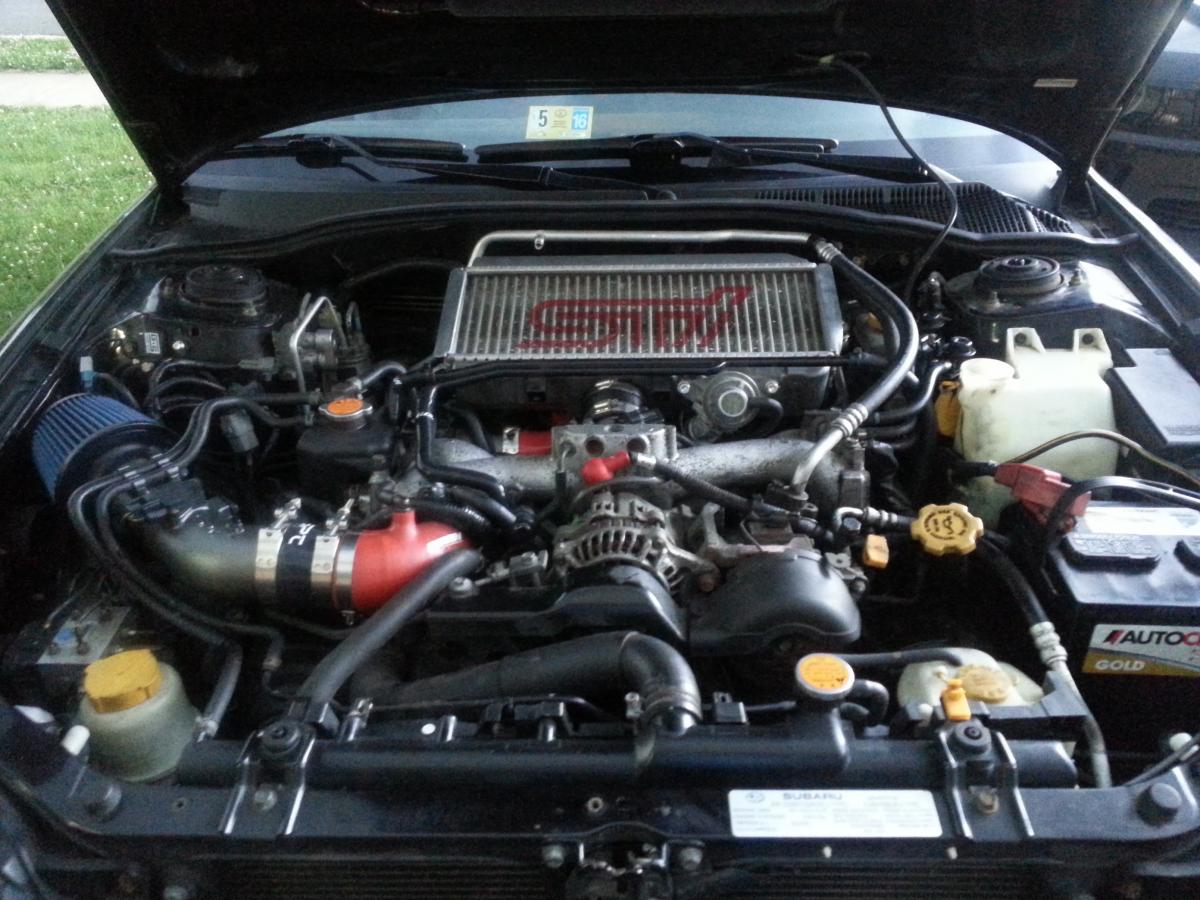

I finished up some details last night; pitch rod mount, rear wheel well trimming, refilled the coolant, re-installed the intercooler and took it for a spin around the cauldesac and it feels very solid. The STi front brakes are on but I ran into a glitch on the rears so they are stock for now. The issue is the hub carrier is present exactly where the adapter bracket for the Brembo needs to go, that part is not present on a WRX which is what the adapter is intended for. So Brembo rears are not a bolt on. I am going to have to pull the hubs and fabricate a caliper mount so that will likely get bumped to the end of the project. Next up is front wheel well mods and then drop it at the exhaust shop to get a 3in to the tail bent up.

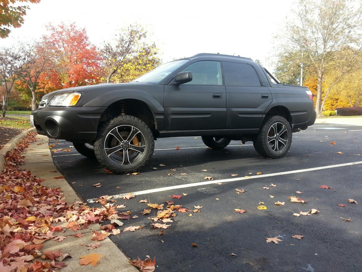

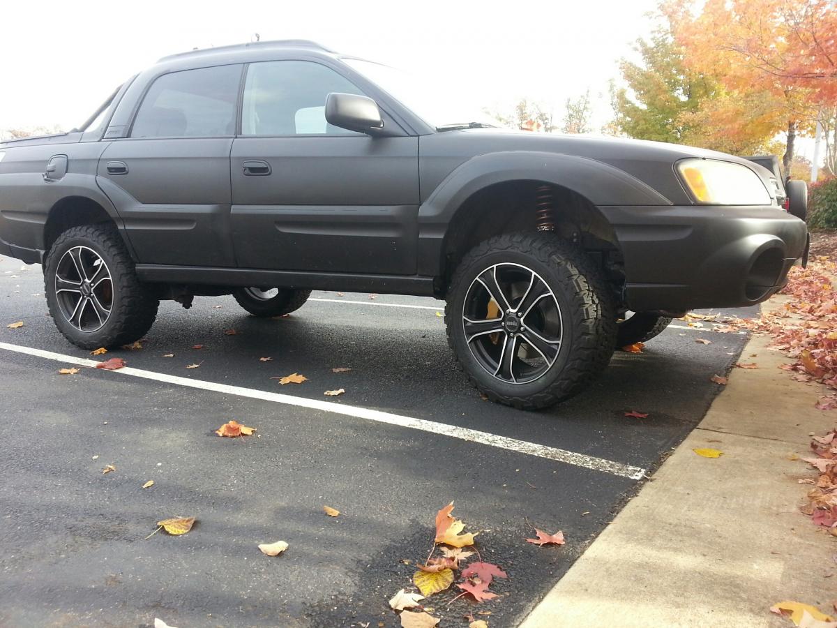

Two pics of it in the parking lot at work today. The performance is amazing, as fast as my STi was with some of the first mods like a turbo back 3in, tune, and such, so a bit more punch than a stock STi even with the larger tires!

The problem isn't so much the parking brake size, but the actual suspension layout, the WRX uses struts in the rear so the rear hub looks allot like the front hub. The Baja uses a multilink suspension that places a large steel vertical hub carrier right where the bracket needs to be. I have a set of STi rear hubs with backing plates and it may be more trouble than it is worth to cut those off and then see if they align before welding them on, might just be easier to fab one up. But since I need the truck for the winter it will be a spring project, right now it stops WAY better than stock with STi fronts and EBC reds in the rear.
