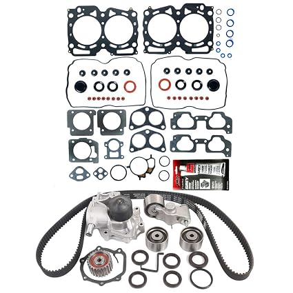

May 20, 20196 yr My call is the early signs of a dead head gasket. If you got to them early enough you’ll not have warped heads - saves on having them skimmed. These engines are known for leaking oil through the bottom of the head gasket. Read up on the recommended replacement part number. I’ll be pulling my sister’s Gen3’s EJ251 for a head gasket replacement due to the oil leaks. Cam belt etc will be done as well. Get on it early, this way you can choose when to do the HGs, not be forced to deal with them at the most inconvenient time possible which is usually the case! Cheers Bennie

May 21, 20196 yr Even 5 quarts in 3400 miles is pretty bad. You're changing your oil before it's time to change your oil. You don't need to replace the head bolts. I have heard of people using turbo gaskets, there should be all kinds of information on the internet about what are the best gaskets to use. I've just used the name brand gaskets (e.g. Fel-pro) from Rock Auto and they've worked well. Normally I would say while the engine is out you should replace the timing belt, idlers, tensioner, water pump, valve cover gaskets, intake and exhaust manifold gaskets. If it's never been done (and it probably hasn't on yours) replace all the coolant pipes and hoses (the little ones on the engine, heater hoses, radiator hoses). The steel lines rust out and the rubber hoses crack. Some of those little lines and hoses are very difficult to replace with the engine in the car and the intake manifold on. However, I still think your car is badly rusted and you should spend as little money and time on it as possible and buy something rust free. If it's only overheating with extreme use, check the radiator, fans, etc, run the heat occasionally if you need to, and save your money for something that's not rusty.
