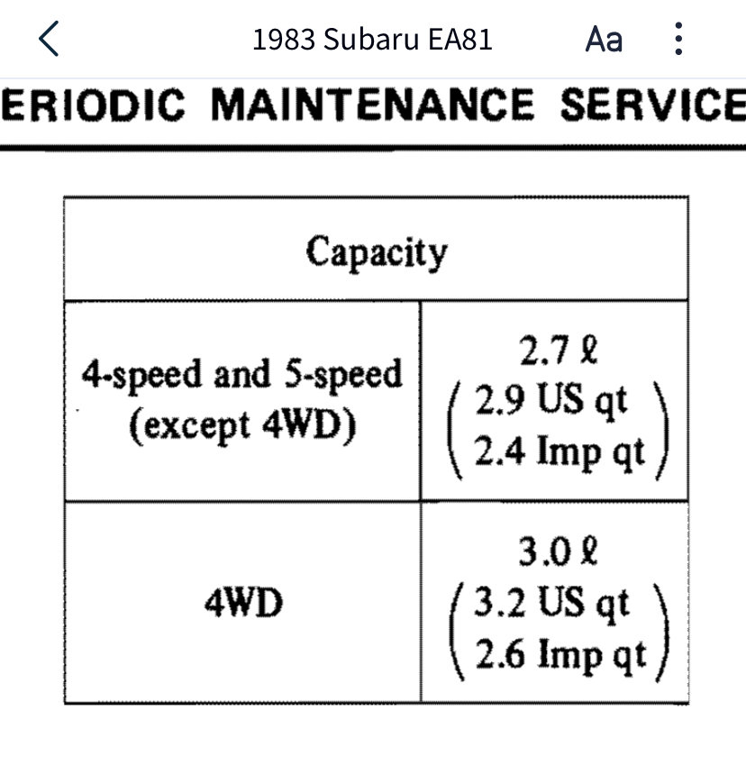

About to do something nice for my ‘83 GL 4spd, but can’t seem to find capacity anywhere in my manual or on here. It’s a D/R 4x4 if that makes a difference.
Anyone have access time that kind of top secret information?
