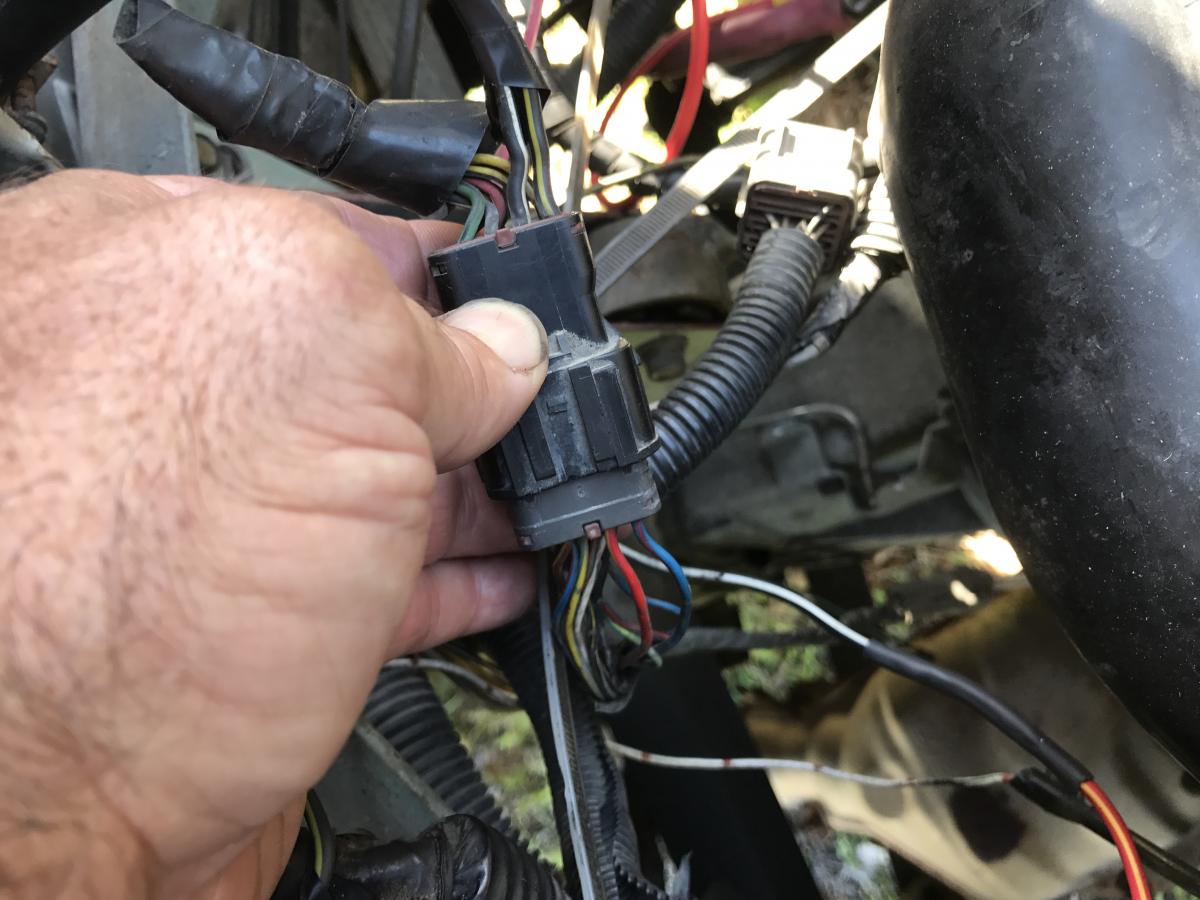

So I get intense the next day to fix this problem for good. I get the meter out and start checking voltages. I have battery voltage at the Ignition switch, but only 8-9 volts at the start wire, so there is bad resistance somewhere. But I hear the starter solenoid moving and clicking against the high amp contacts, so that can't be the problem. Right??  WRONG!!  The click, click, is the sound of the solenoid pushing the bendix out to the flywheel, but not quite all the way to engage the contacts because of the pressure of the return spring. So I start tracing the start circuit. I check the jumper I made with the plug of the old neutral switch when I switched the auto trans to manual. It looks ok, but these wires to the transmission are way too small to carry full start current. They're like 16-18 ga. whereas the other wires in the circuit are 10 ga. So there has to be a relay, right?
WRONG!! As you can see in the pic in the last post, the upper part of the plug is from the old automatic safety switch, where I jumped the two starter wires together. And the lower part is the wires that run back to the main harness. The red and blue are the key wires to and from the switch, and as you can see, they are quite small. Even though the wires on the old switch plug that I jumped together are 10 ga. And there is NO RELAY! What. The. Hell. Subaru. REALLY?!? I've only stripped one EJ harness before, many years ago, and didn't pay any attention to the wires I didn't need. But somewhere in the main harness, the starter circuit switches from 10 ga. down to whatever this is, 16-18, then back to 10 to go to the starter...
I ran a 10 ga. directly from the ignition switch to the starter, and BAM, like it's never started before!! no lag at all, like there always was even when it was working "right." I know others have posted on this problem before and recommended installing a relay to handle this problem. I think that's a great solution, maybe even the best. But I am curious to know where these wires are downsized, (not enough to actually dig into mine) but others of you who have stripped many harnesses must surely have seen.

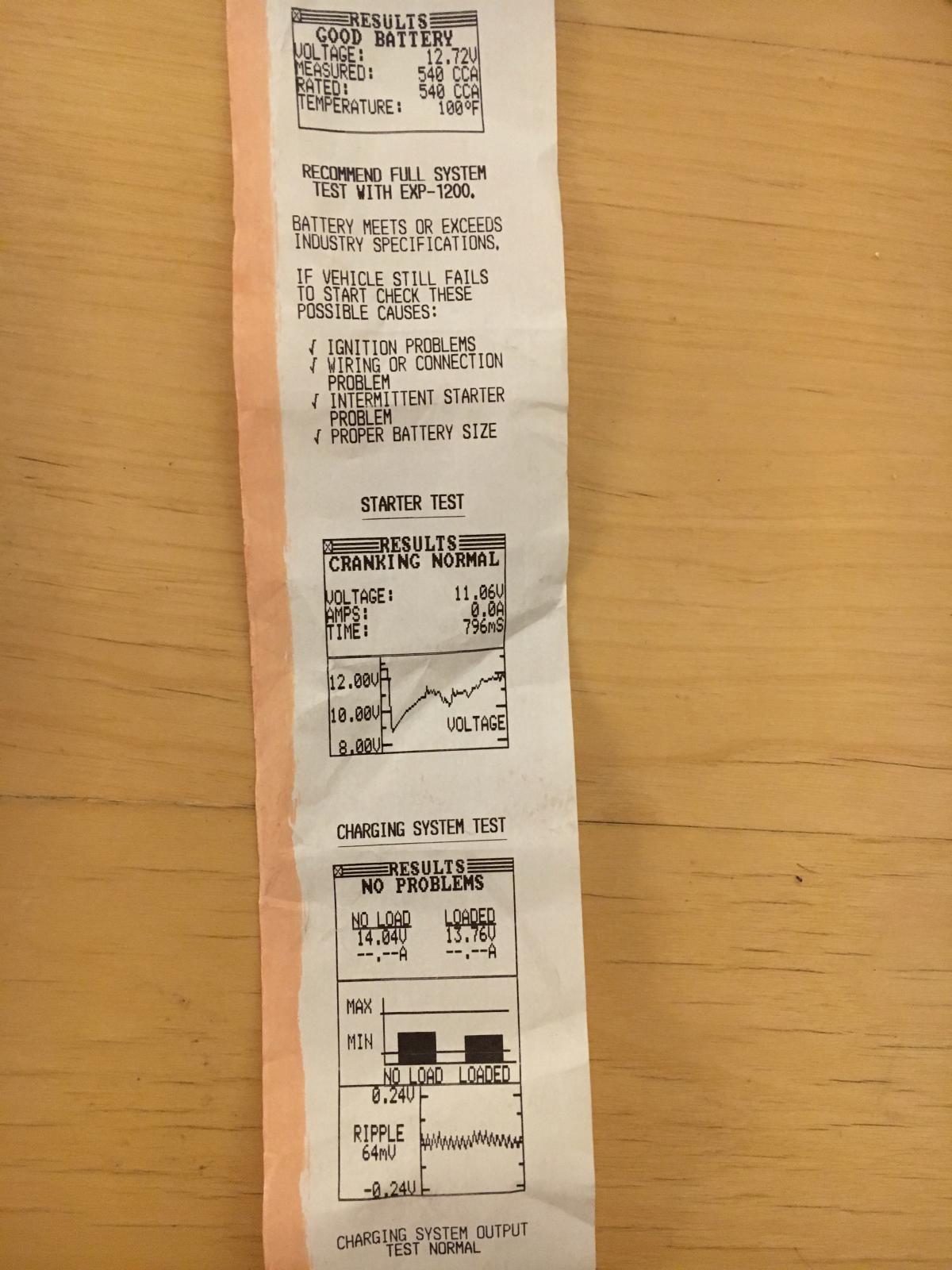

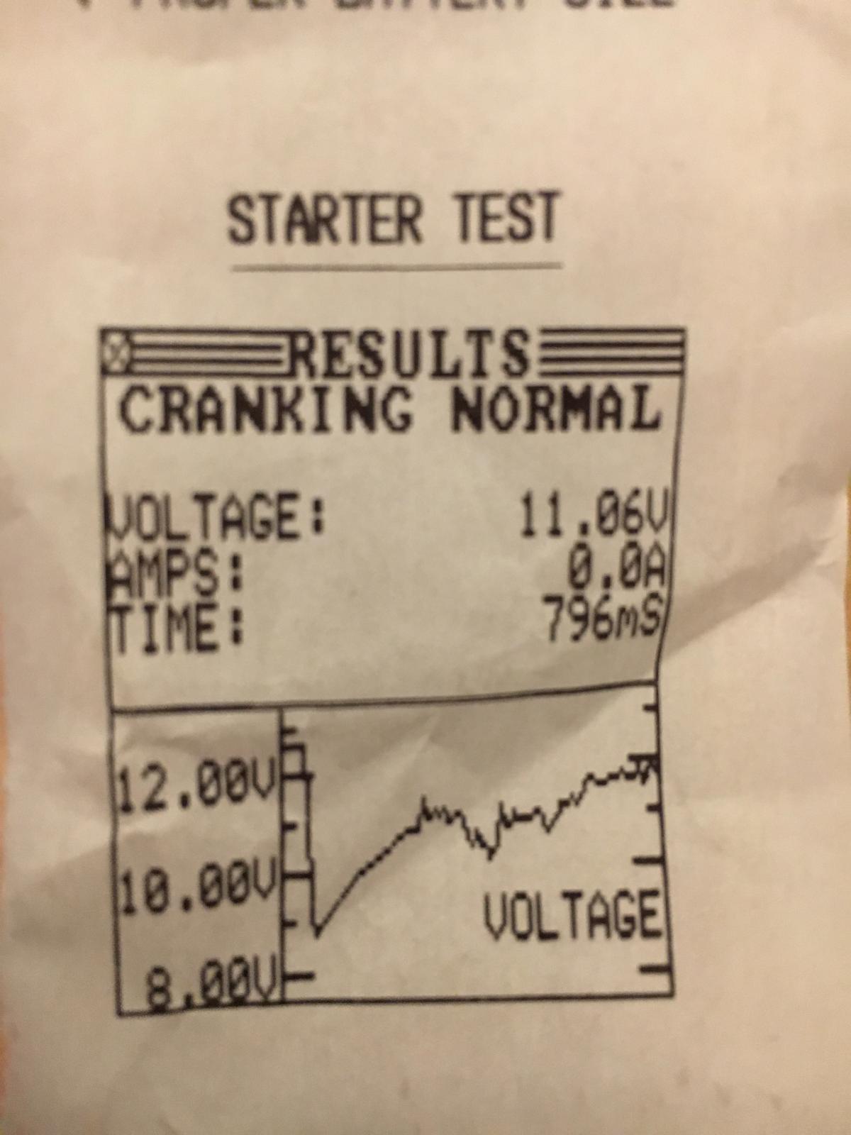

I'm a big fan of getting data and trying to repair based on that information. I just came back from Advance Auto Parts and attached are the screenshots of their charging system analysis. Look at the massive voltage drop on the starter! It also got zero amps for a while. Thoughts?post-27176-0-81818100-1495587927_thumb.jpgpost-27176-0-72488200-1495587941_thumb.jpg

You clearly missed the post above which shows the starter voltage.
