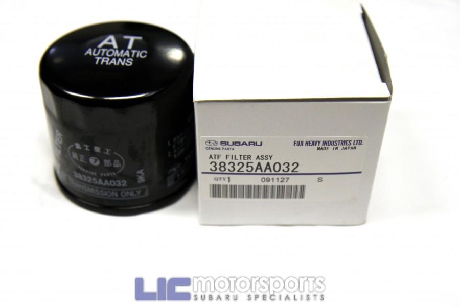

June 22, 20178 yr We replace them all the time. It's accessible so might as well. I'm an Amsoil dealer and Amsoil calls out the same filter for the trans as for the engine, and so we use those. They are $16 but that's half the price for twice the filter compared to the OEM one's. We have had zero issues. The Amsoil EA filters are full synthetic media. Very, very strong casing (I cut them open with a filter cutter on the regular) and so can easily handle the increased pressure of the trans pump. GD

June 22, 20178 yr We replace them all the time. It's accessible so might as well. I'm an Amsoil dealer and Amsoil calls out the same filter for the trans as for the engine, and so we use those. They are $16 but that's half the price for twice the filter compared to the OEM one's. We have had zero issues. The Amsoil EA filters are full synthetic media. Very, very strong casing (I cut them open with a filter cutter on the regular) and so can easily handle the increased pressure of the trans pump. GD interesting I thought the OEM trans filter was internally built differently from an oil filter? First I heard of anyone using an oil filter there.
June 22, 20178 yr interesting I thought the OEM trans filter was internally built differently from an oil filter? First I heard of anyone using an oil filter there. I believe the difference is the can structure due to transmission fluid pressure generally being 2x - 3x higher than engine oil pressure. The Amsoil can is rated for the pressure. Otherwise it's just like any other filter AFAIK. I'll cut one when I get a chance but I'm sure they are just normal filters. We started using them when we realized they were rated for this because I stock them anyway and they are half the price but much better built than stock. GD
