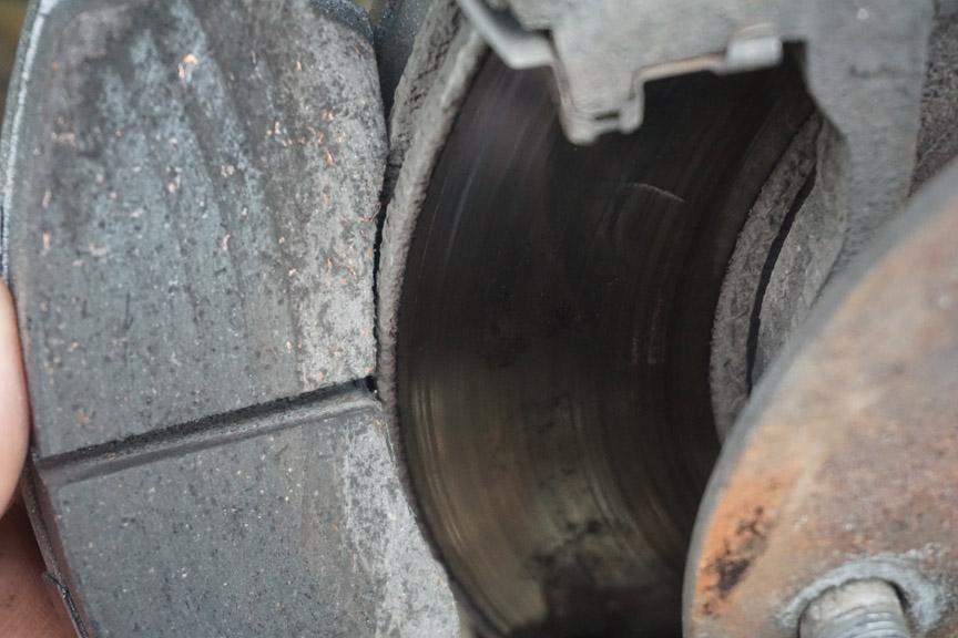

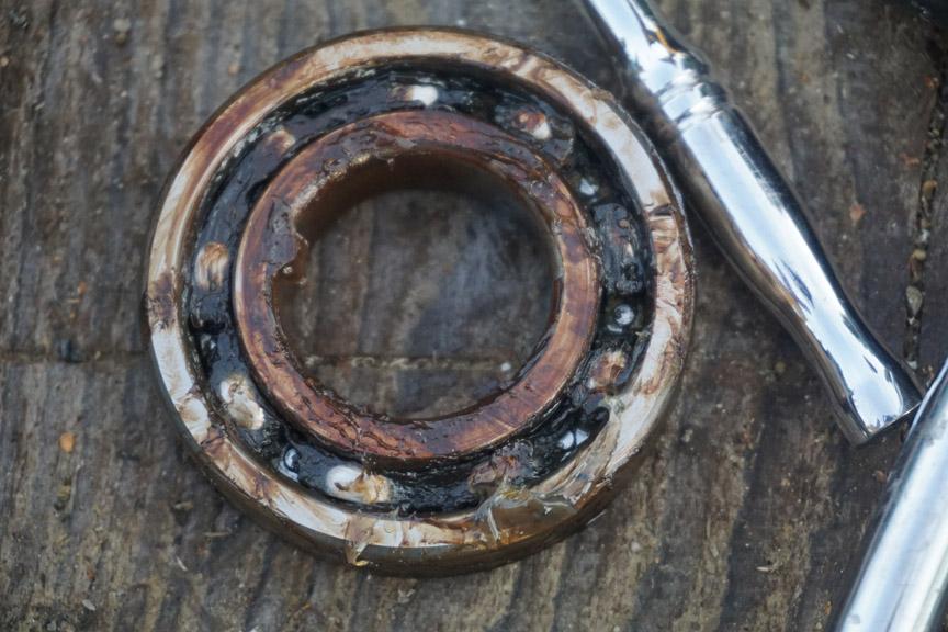

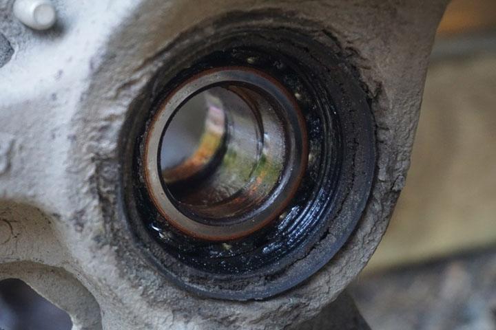

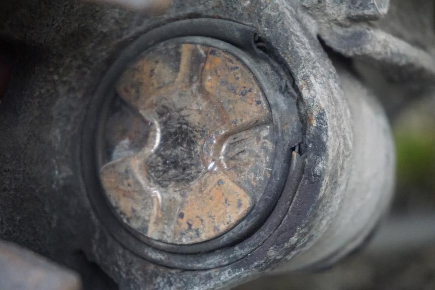

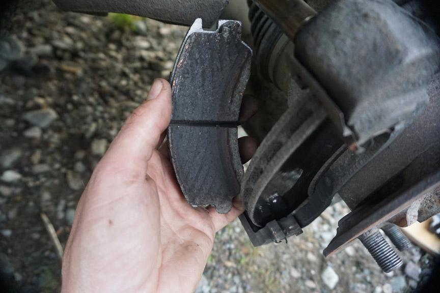

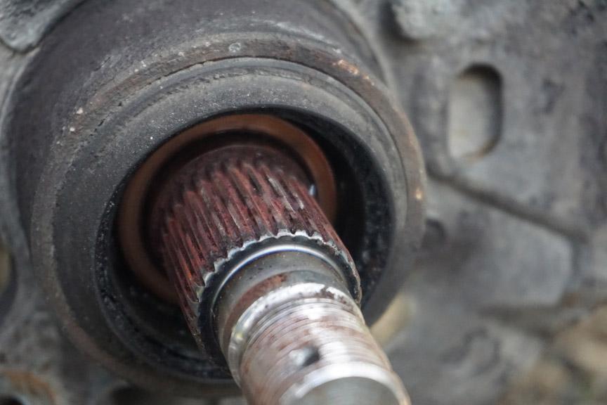

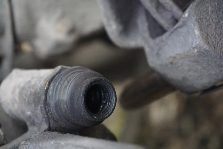

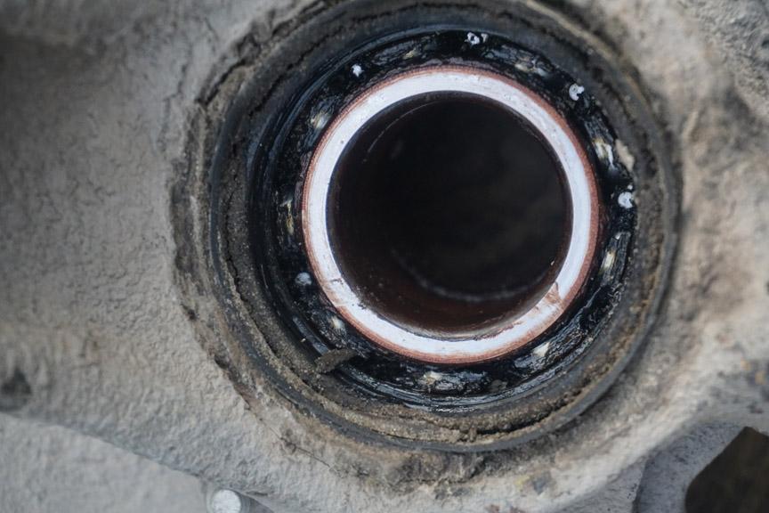

August 3, 20178 yr Author New Mid Work Update: I checked out and took apart the front pass hub assembly. Definitely need that lube on the caliper slide pins. I decided to go ahead and (attempt to) punch out the bearings, which took way longer than expected -- in fact, the inner bearing is in there pretty good, so I'm going to have to take it to a friend that has some extra tools to help pull that bearing. Good lord, I hammered away with a giant socket for .... 2 hours? I'm sure the neighbors weren't happy about it. I attached photos of a few things -- first, photo is the caliper piston and torn boot. Then the caliper slide pin boot. Next are the brakes. I put them on probably 60 to 100 miles ago. The inside brake seems to have a gouge already. The outside brake looks ok, but I think it's wearing a little uneven. For point of view, the outside brake is upside down in the photo, and the inside brake is right side up (not rotated). Followed by the axle / spline. There was some red dust that came out when I removed the rotor. I assume it was rust, but I am not positive. You can see the red on the splines. Axle removed, you see the outer seal and bearing, followed by the opposite inner seal and bearing (all the particles were a result of the operation, and were not inside the bearing). Outer bearing out of the knuckle. Oil seal looks fantastic (not pictured). I couldn't get the inner bearing out, so I'm headed to the bus mechanic shop at the national park nearby where I have some friends working. With their proper tools, I should easily get the old bearing out and new seals and bearings in. I had to borrow my girlfriend's truck to get to work. Yep, I got the Subaru, she has the 1994 4wd pick up. Any thoughts on these photos? Edited August 3, 20178 yr by Tony Cortado
August 4, 20178 yr Author Got the bearing replaced, thank goodness for friends in high places, I was able to use bigger beefier hammers and c-clamps, and I got some silicon lube for the caliper rod. The squeaky sound I recorded in the original post is gone, but the brake drag sound still exists on either side when I turn. Once I'm back from a short road trip, assuming the brakes don't catch fire , I'll try to figure out why that is happening. Thanks, everyone for your responses! Edited August 4, 20178 yr by Tony Cortado
