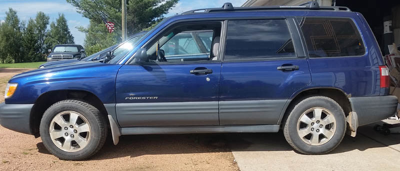

heartless Posted June 27, 2018 Share Posted June 27, 2018 don't go just by what you see online.. actively look around - we found my 2002 Forester locally (other half saw it while he was working) and we got it for $1400 cash. Being in Northern Wisconsin this car is in very good shape for its age. The picture was taken shortly after I got it 2 years ago 2 Quote Link to comment Share on other sites More sharing options...
