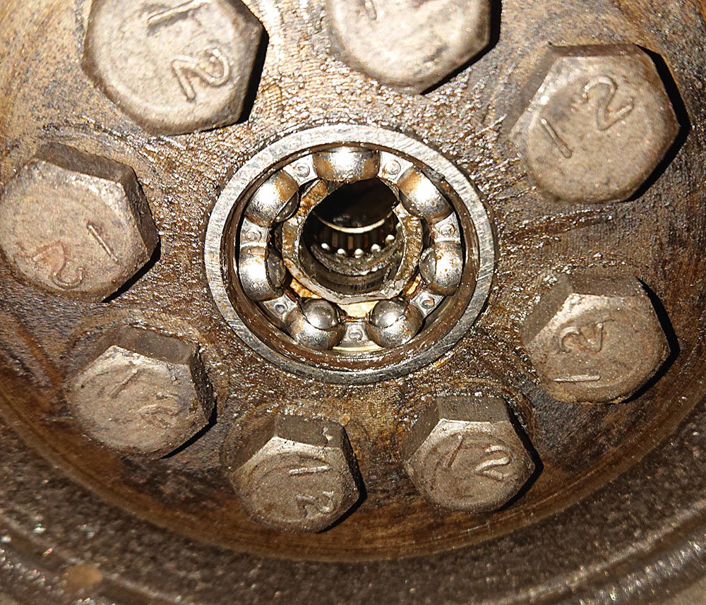

Late update here, but I've been doing a lot of traveling recently and only today got this problem solved. I thought I'd update here for the sake of closure. The flywheel pilot bearing had partially come apart; all the ball bearings were still in place but the 'side' wall that covers the bearings was missing and a fragment of inner bearing race had broken off and wedged itself between the friction disc and pressure plate, preventing the two parts from being able to move independently, effectively making the friction disc and pressure plate into a single joined part. Therefore my symptom of pushing the clutch pedal, and seeing the cable move the top of the release fork, but it never actually releasing and letting me shift. I had a new clutch kit on hand today because I wasn't sure what I'd find in there, so I replaced the shattered pilot bearing and threw the new friction disc / pressure plate in as well, and she drives beautifully now.
