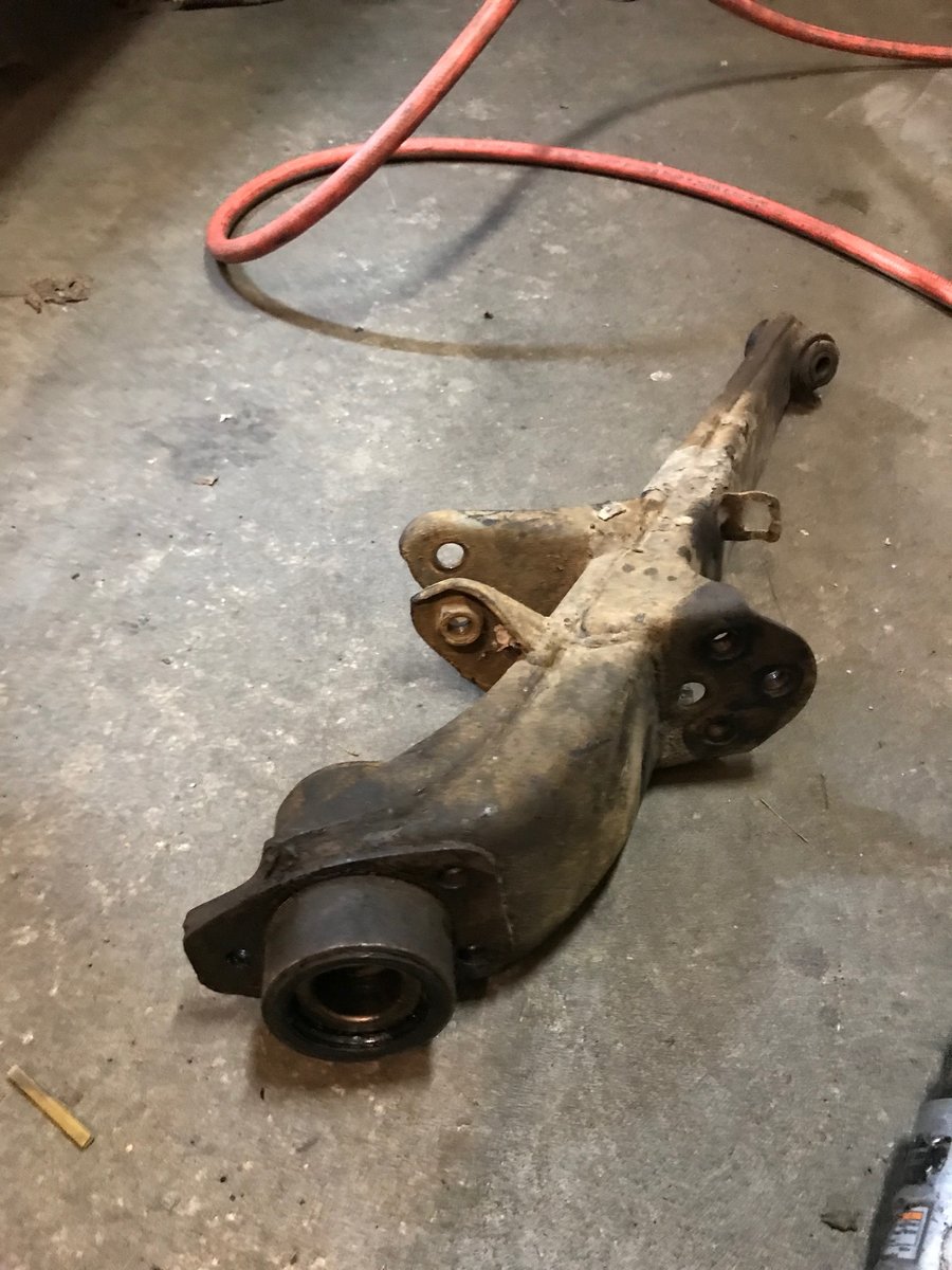

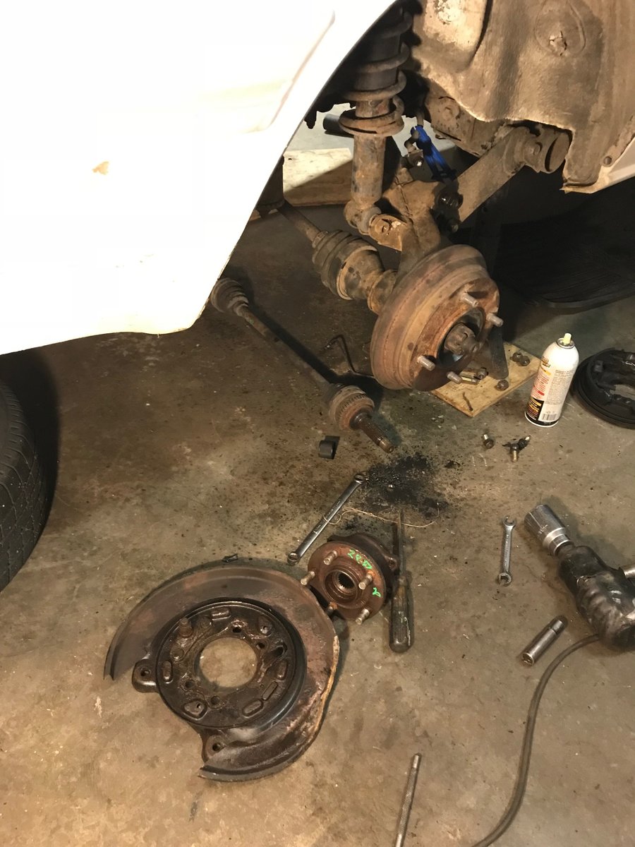

Below I removed the wheel and just looked at this dated setup and thought about mating a newer bearing setup to replace the old axle and drum.
All of the 2nd gen stuff uses pressed in bearings which is way more work than its worth. Then I remembered the 3rd gen stuff (legacy) uses a more modern bolted on hub bearing!

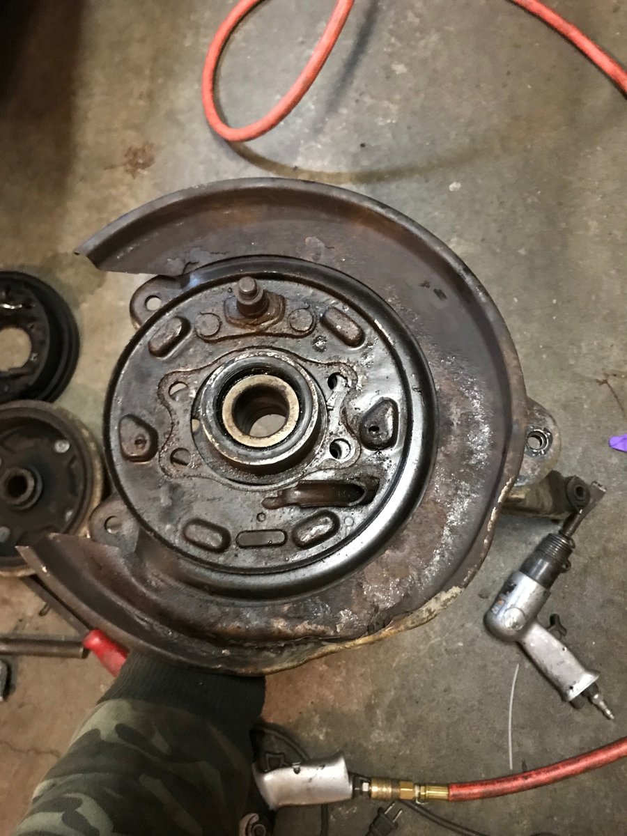

Off to the junk yard  I went to grab a 3rd gen legacy rear axle, backing plate and hub bearing to start this transformation.

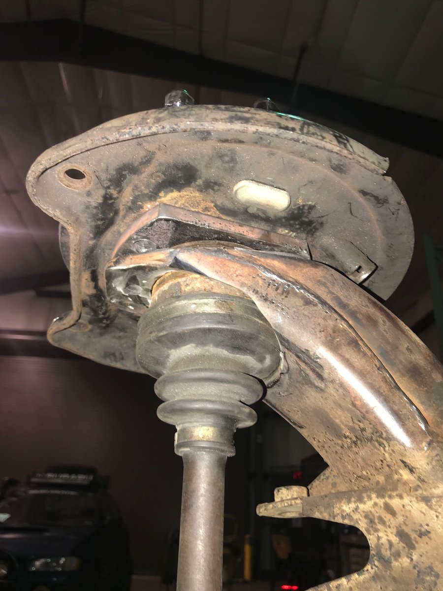

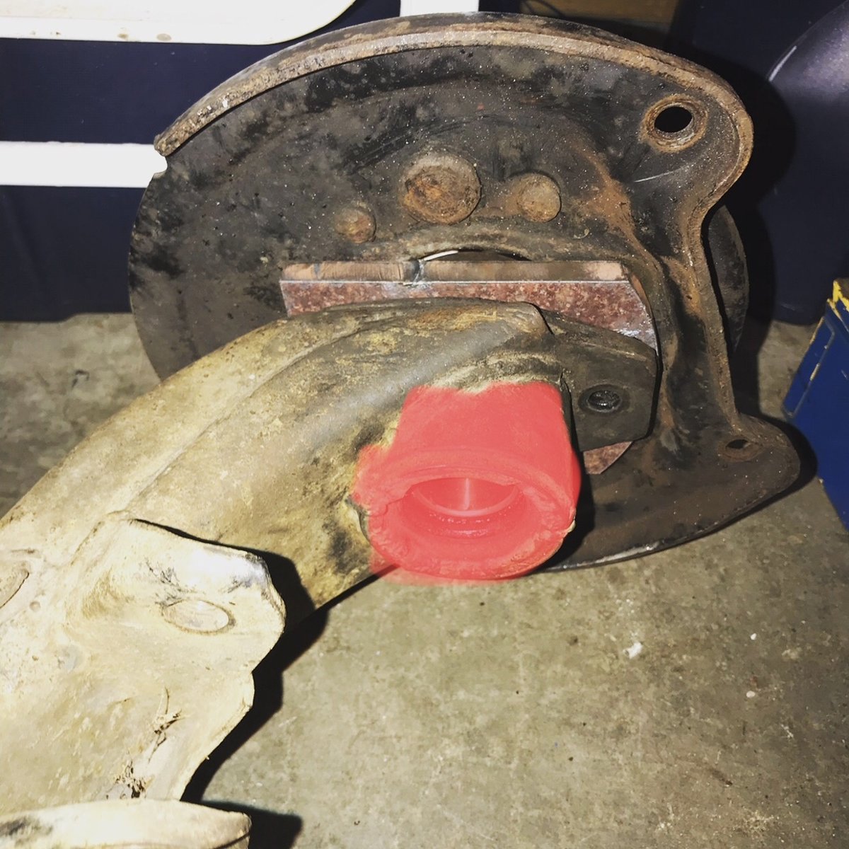

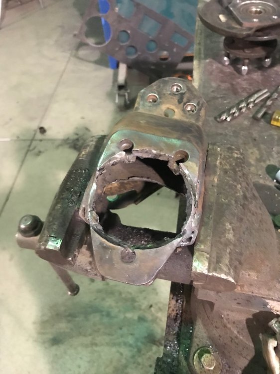

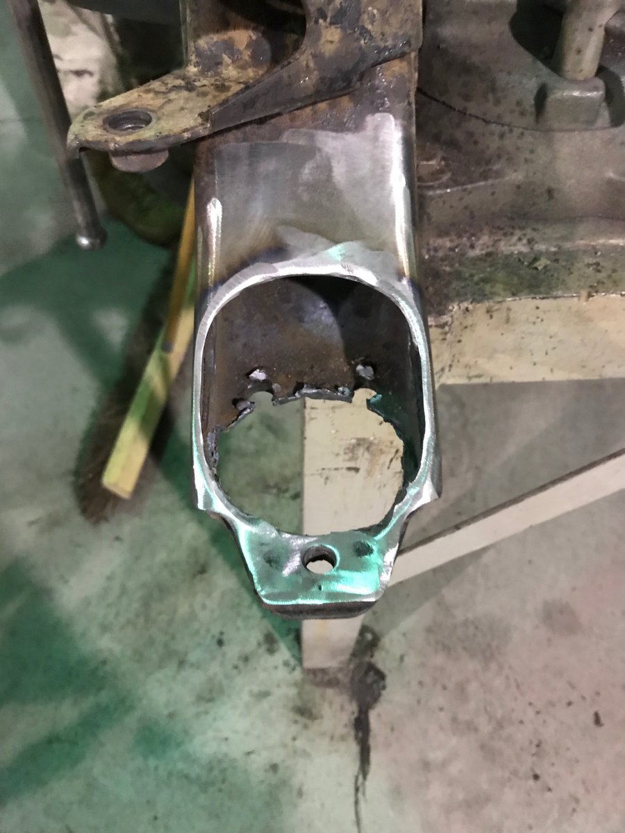

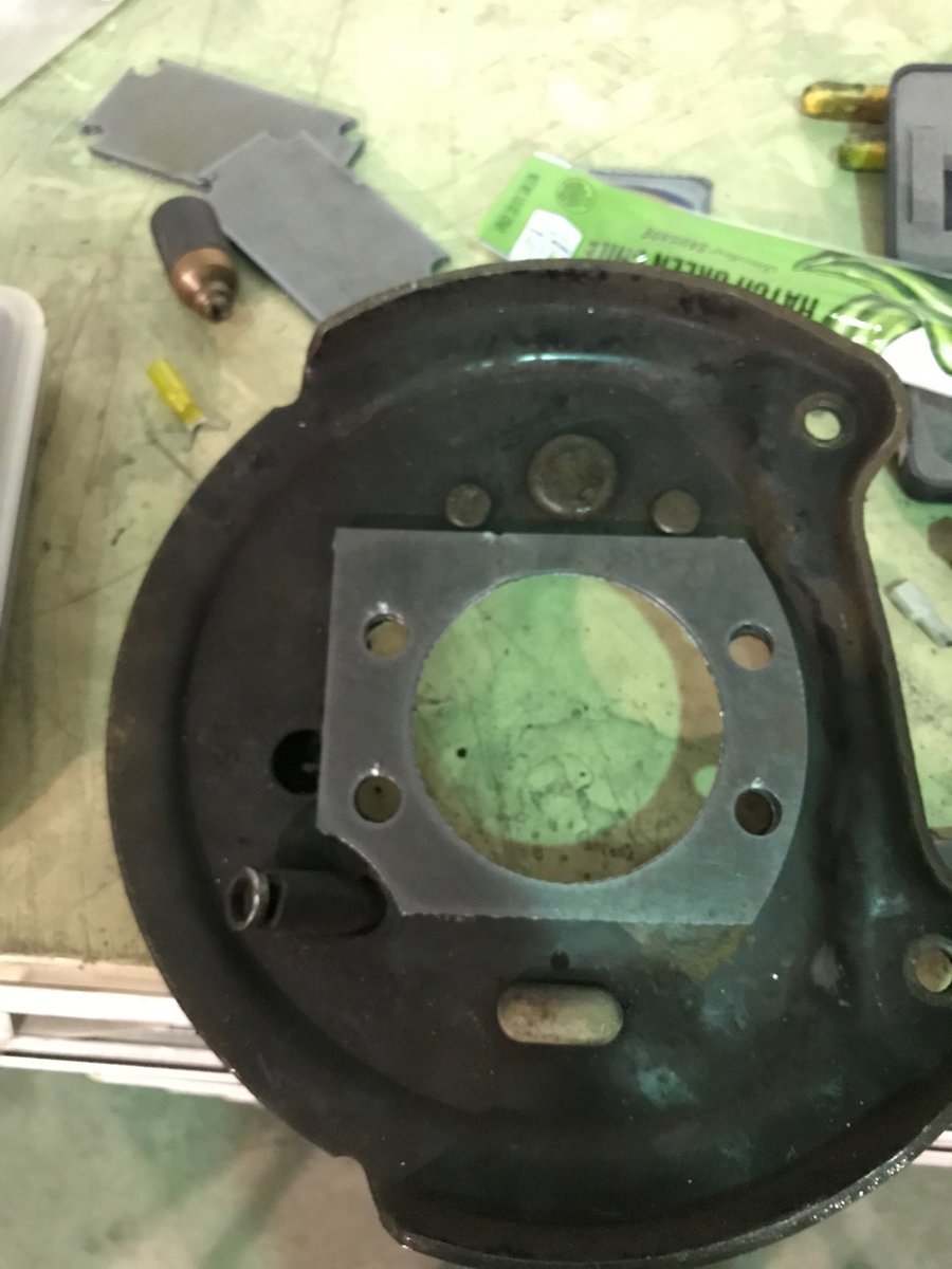

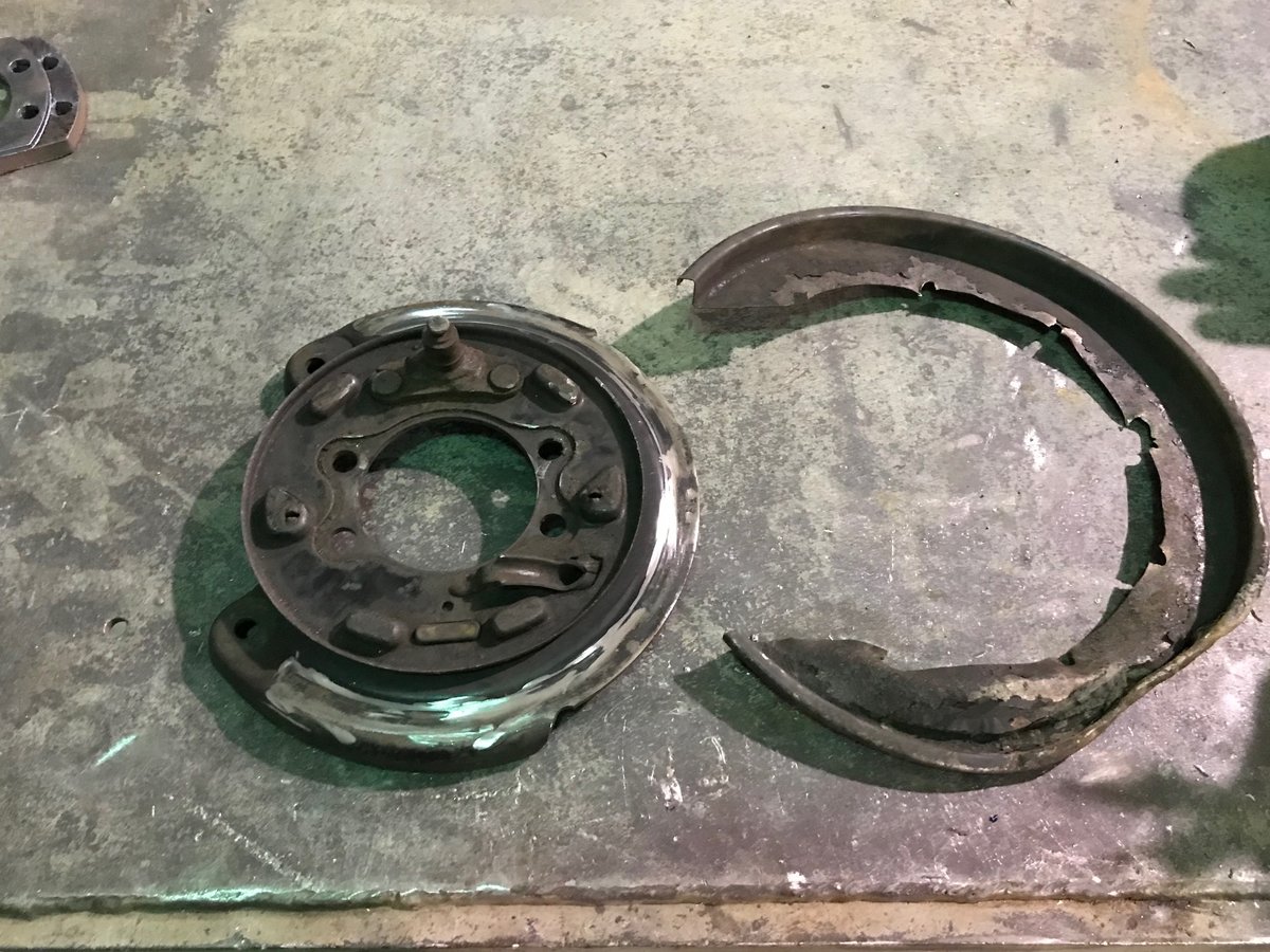

I test fir the axle length and made sure it wasn't going to be way off seemed super close so I mocked up the backing plate to see how it would look and went to work. First I had to clean up the backing plate a little, then I made a proto of my mounting plate that will be welded to the loyale control arm. I've indicated in red what will be gutted and removed.

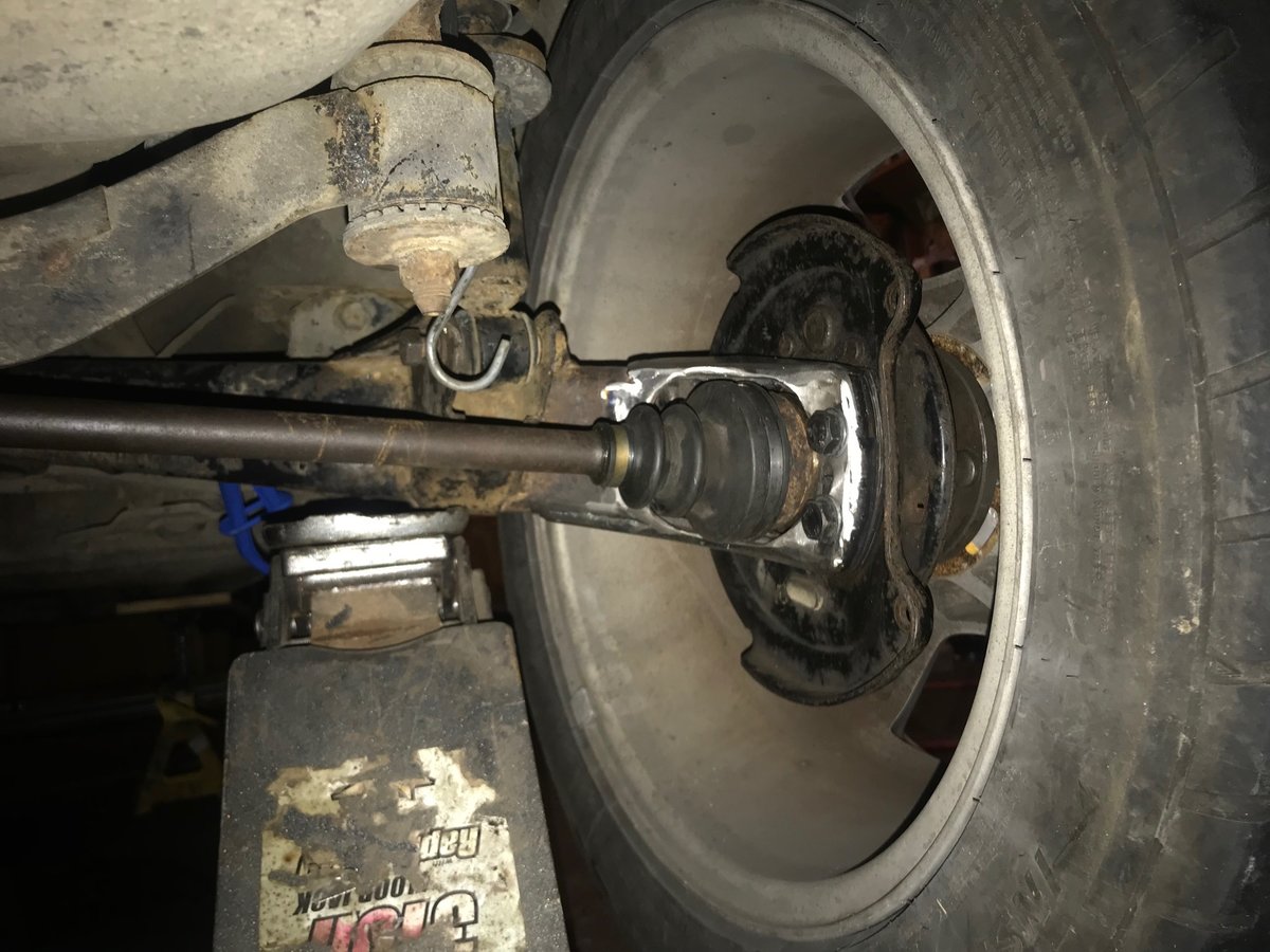

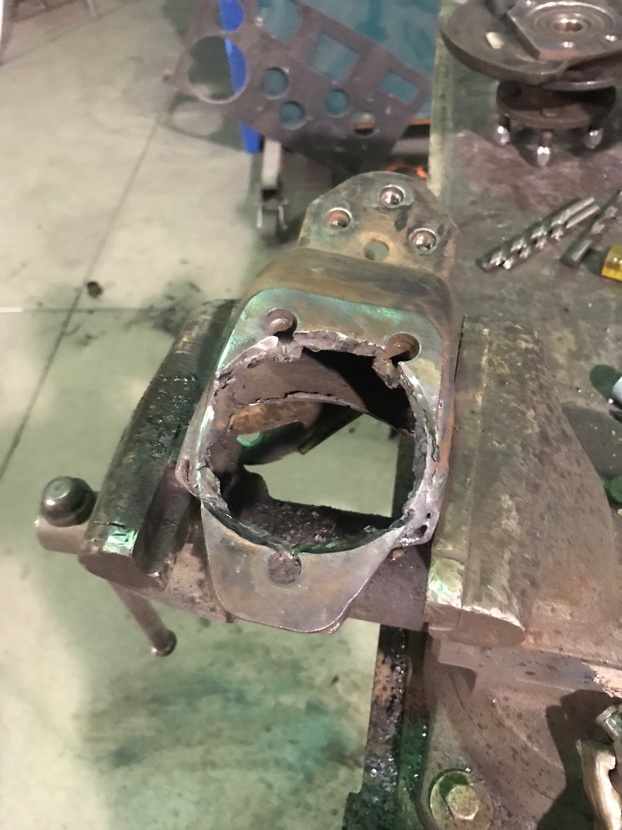

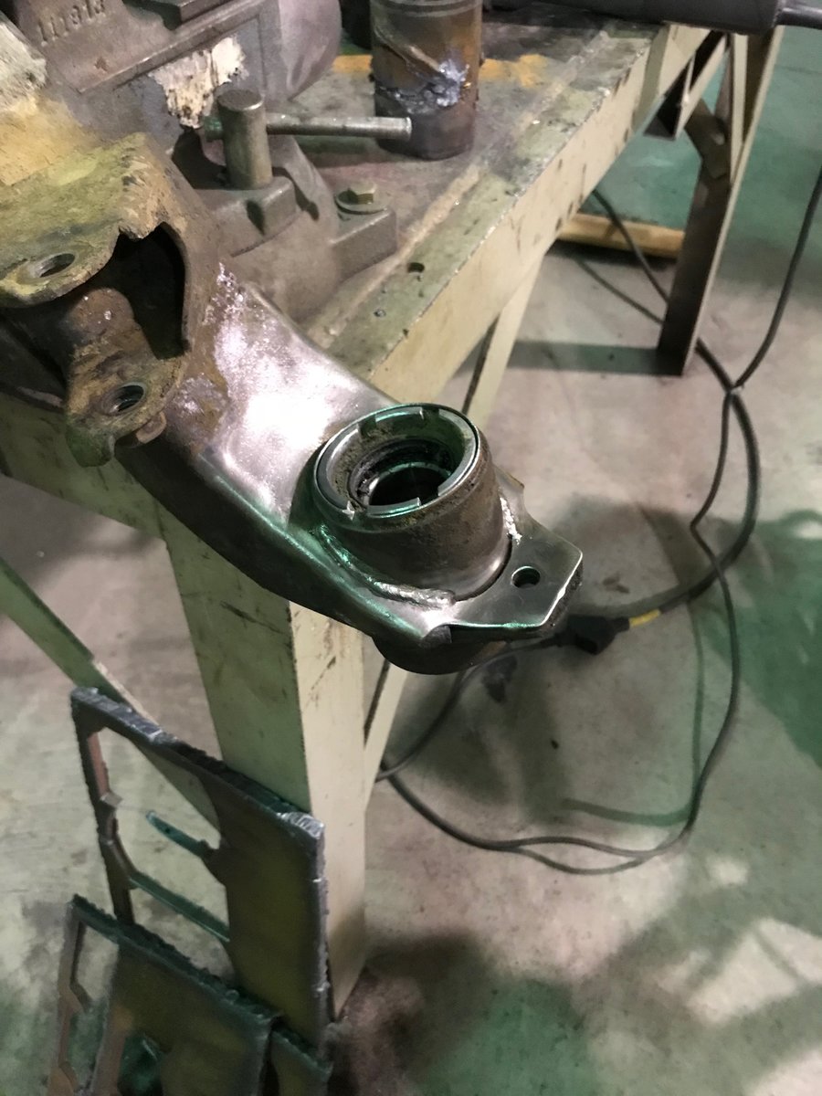

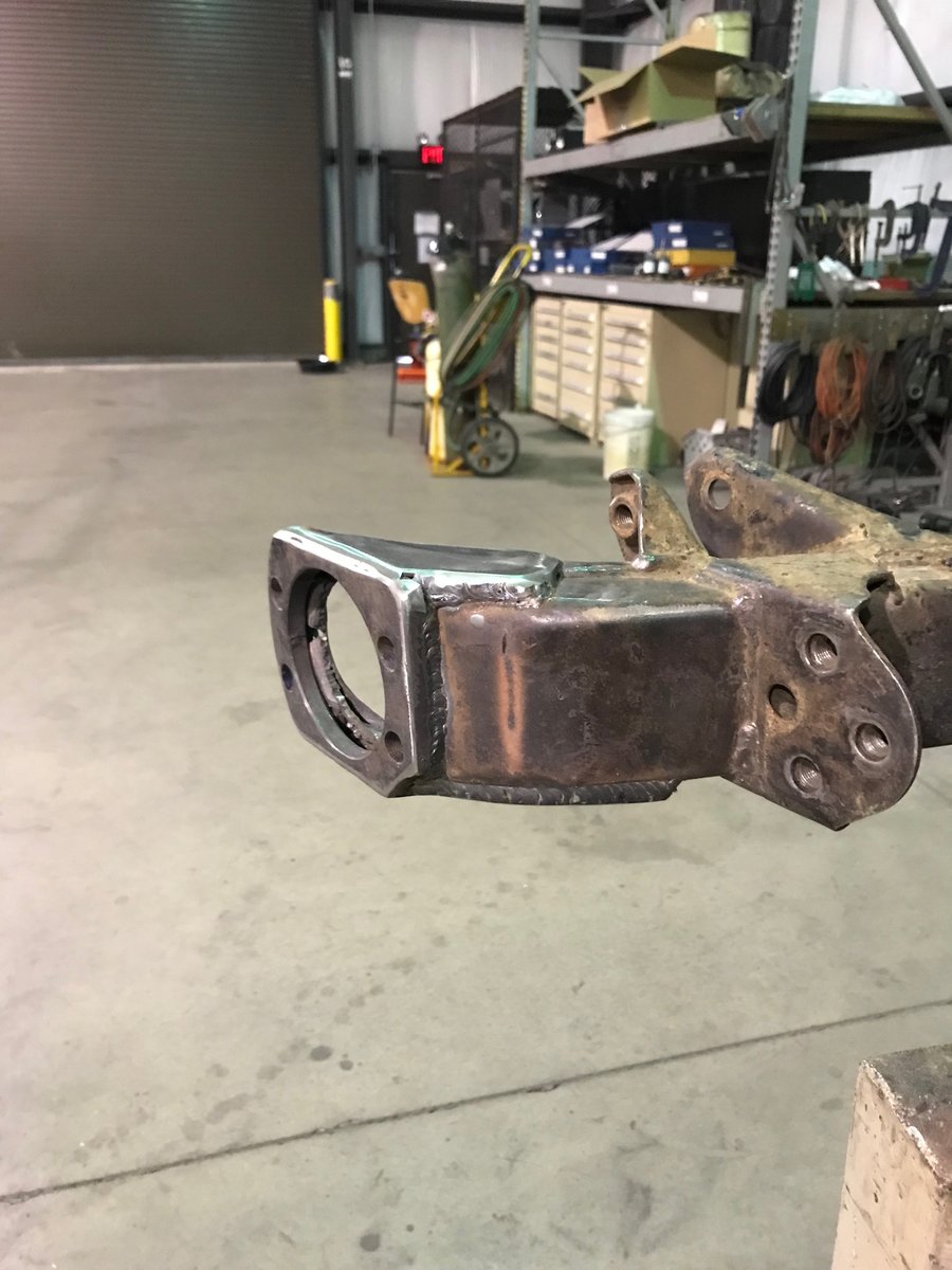

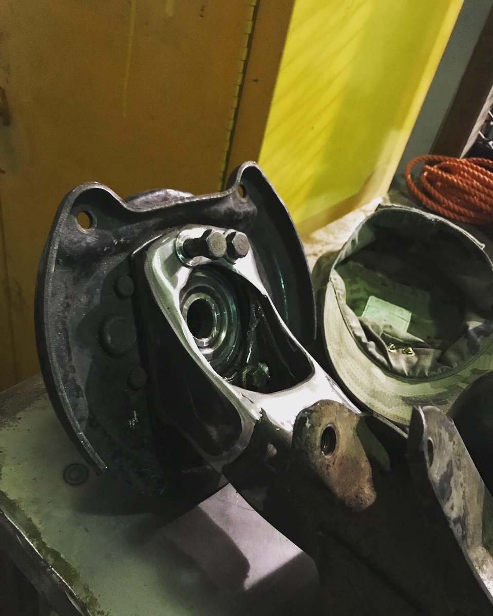

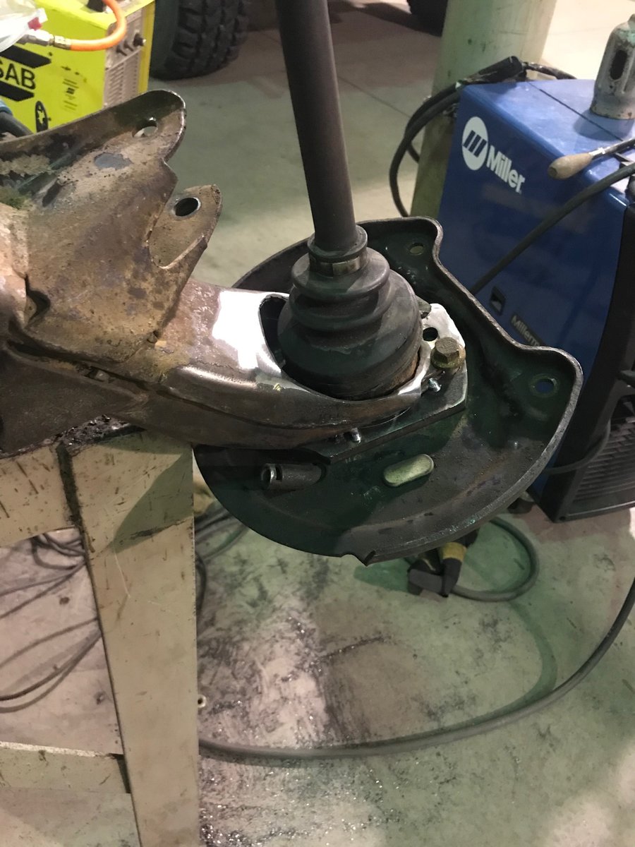

I  plasma cut out the loyale bearings out and the Mrs.'s cleaned up and test the hole that remained, once I saw that this may work and the point of no return already passed I welded the plate onto the arm and headed home for a test fit!

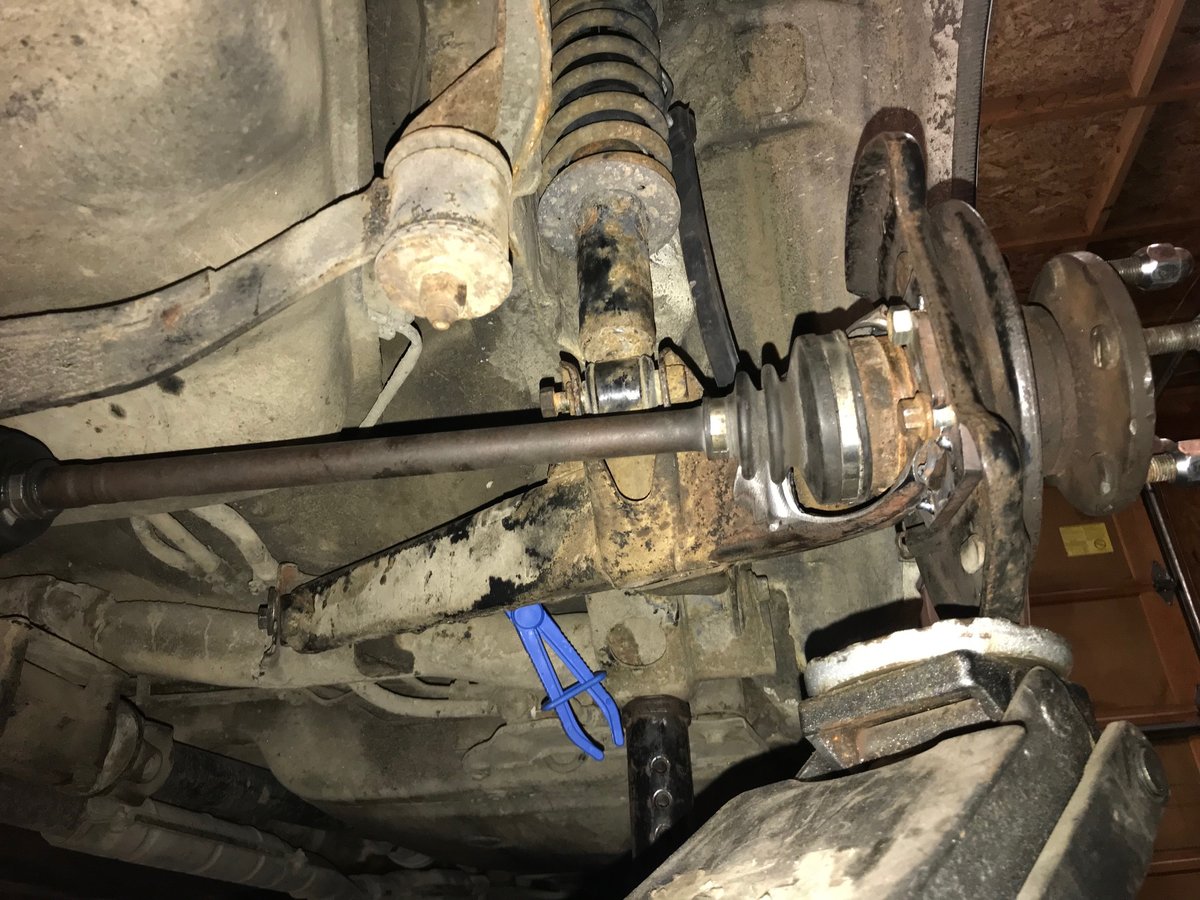

First test fit went well, I hadnd purchased longer hardware yet so please excuse the random bolts
How does the axle length work out? Are you making up some axles using EA82 inner and Legacy outer joints?

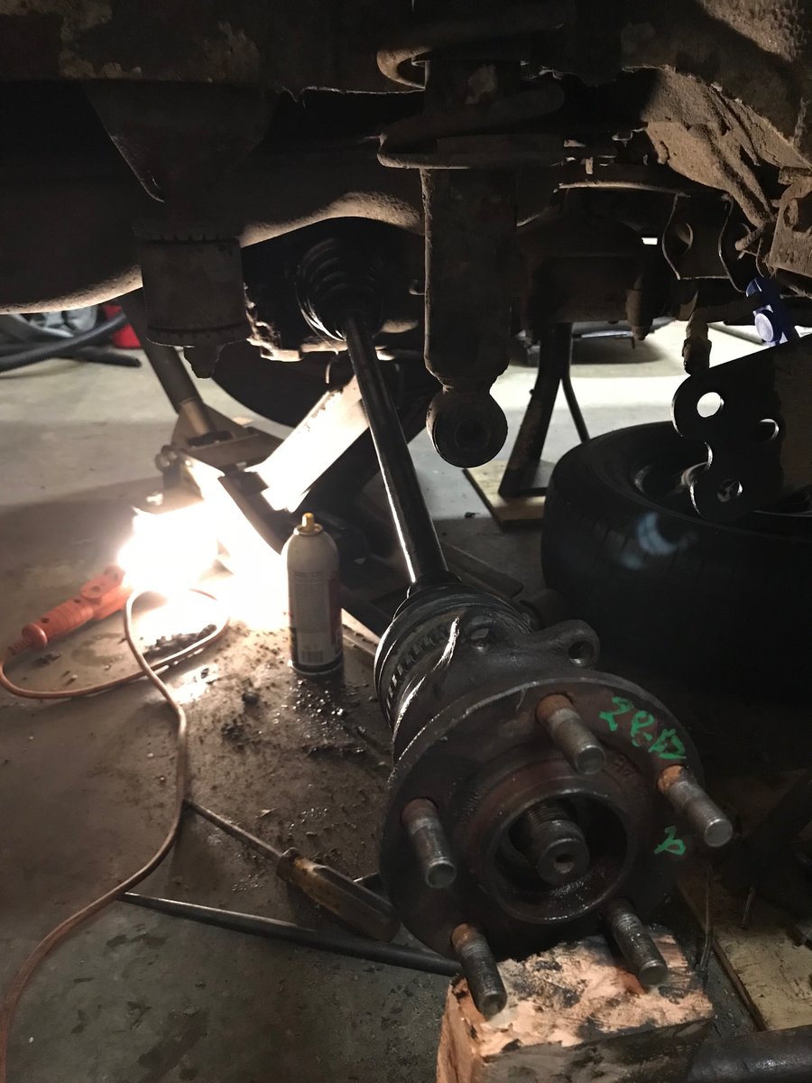

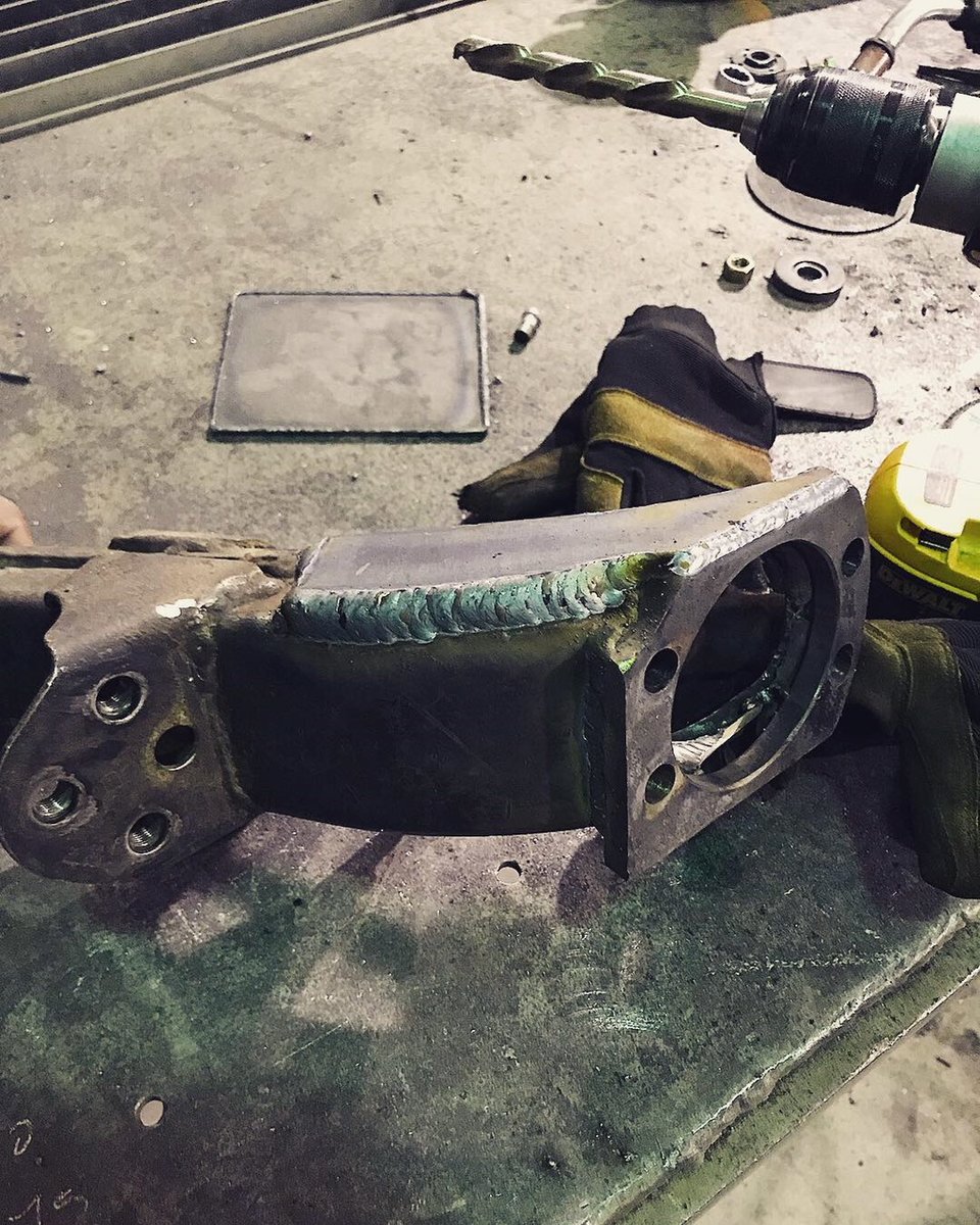

Seeing as the test fits went well I moved onto actually welding the plate onto the arm and bracing and capping the arm for a more professional look and function.
Fast forward to now! I smoothed out some of the welding, not to degrade the integrity of course and went home for the other arm to start all over again. I finally got matching and correct length hardware this time! (granted only 2 of 4 can be seen in this photo)

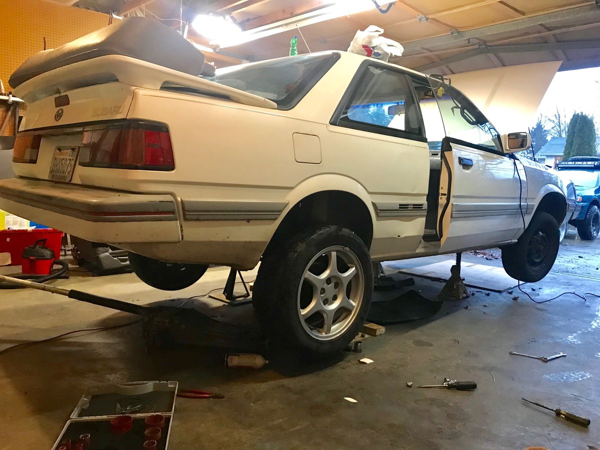

Axles are a combo for now, if I decide to go full ej driveline I would use stock 3rd gen legacy rear axles through and through. The axles are longer of course as the legacy track with is wider than the loyale but considering the 1/4 mounting plate it comes out pretty close. With the RS wheels on they are basically flush with the rear fenders, and ive tested the axle rotation at ride height ( as I know the distance closes) using the jack as you've seen in photos to load the suspension.
