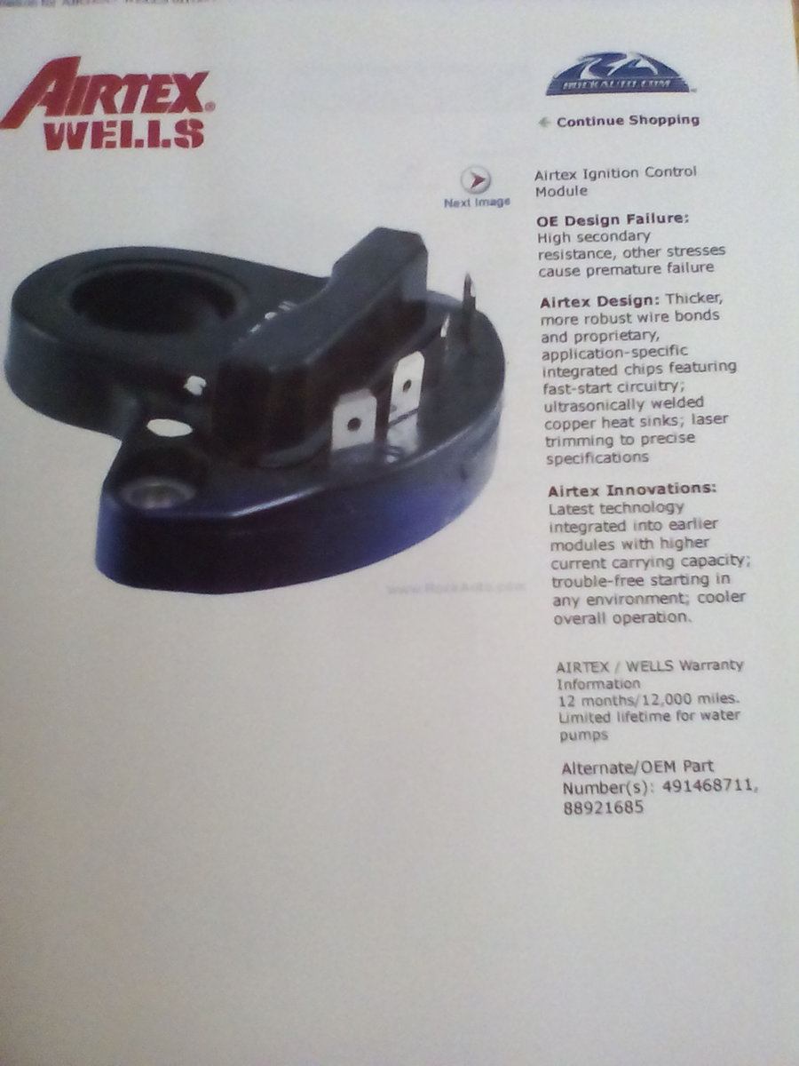

January 13, 20197 yr There must be some good ones of these improved aftermarket ones floating about wrecking yards or Subject enthusiasts no longer loved or cared for. Just the module no need for the entire dizzy contact me or my also known as Jono
January 14, 20197 yr Oh, good luck. I've been looking for the four-pin EA81T version for the last 4 years. All I ever see is the two-pin carby versions...
January 14, 20197 yr 1982-83 Nissan 200SX, (maybe?): These cross over to 88921540 not 88921685. who knows but the pinout may be in different order(?) https://www.rockauto.com/en/moreinfo.php?pk=49874&cc=1208562&jsn=942 https://www.rockauto.com/en/catalog/nissan,1983,200sx,2.2l+l4,1208573,ignition,ignition+control+module+(icm),7172 1984 & up NA & turbo Nissan 200sx is same module as optical EA82, Std Prod #LX653. https://www.ebay.com/itm/Ignition-Control-Module-WVE-BY-NTK-6H1206-fits-83-85-Nissan-720-2-4L-L4-/123276988099?hash=item1cb3e18ec3 https://www.ebay.com/itm/Ignition-Control-Module-WVE-BY-NTK-6H1217-fits-83-85-Nissan-720-2-0L-L4-/263839904510?hash=item3d6e1572fe Maybe go look into the NGK/NTK search for crossover to 88921653... Edited January 14, 20197 yr by czny
January 14, 20197 yr Those Nissan modules support dual plug heads,not knock control.They are like 2 modules in one. I doubt the aftermarket modules are any more robust anyway.Just beware loose plug wires. Edited January 14, 20197 yr by naru2
January 14, 20197 yr 28 minutes ago, naru2 said: Those Nissan modules support dual plug heads,not knock control.They are like 2 modules in one. I doubt the aftermarket modules are any more robust anyway.Just beware loose plug wires. Show us all your documentation if you really want to help. I say to you Naru - prove it! Until then here's more info for you Jono: https://www.yoyopart.com/oem/11184923/airtex-6h1250.html#interchange
January 14, 20197 yr You have the right modules this time, Notice the difference in the Airtex part nos. Correct one is 1250,Nissan one is 1206. I don`t need to prove anything.Waste your time if you like. I say to you-Take a look at the distributor caps that go w/your Nissan modules,The extra pins on the Nissan module are to support a second coil,not a phase correction signal from the knock control computer. Connections on the nissan module are: Power,intake coil,exhaust coil, and exhaust coil cutoff switch. You may even damage your knock control computer by trying to use the nissan module. I had one of those elderly nissans,There was no knock sensor Edited January 14, 20197 yr by naru2
January 15, 20197 yr Naru, You're right about those distrib caps for Nissan. What a cluster F of coil buttons etc inside. 8 plugs to foul & wires to go bad on an L4. Was wasting my time waiting for freight delivery of a new hood & rear bumper for my 73 Chevy Nova. Steptoe, Might be easier to find a later distrib to mod for that EA81T knock control(?) Those Subaru modules might be NOS somewhere......only a maybe.

January 16, 20197 yr Author On 1/15/2019 at 5:44 AM, czny said: Show us all your documentation if you really want to help. I say to you Naru - prove it! Until then here's more info for you Jono: https://www.yoyopart.com/oem/11184923/airtex-6h1250.html#interchange Thanks CZ, have seen this before and as soon as I see it fits Brats and Brumbies I suspect they have it wrong. But OK maybe turbo brat. I have been in touch with both Standard Motor Products and AirtexWells - both were suppliers of this module but no longer. Both companies were good enough to reply
January 16, 20197 yr Author On 1/16/2019 at 1:54 AM, czny said: Naru, You're right about those distrib caps for Nissan. What a cluster F of coil buttons etc inside. 8 plugs to foul & wires to go bad on an L4. Was wasting my time waiting for freight delivery of a new hood & rear bumper for my 73 Chevy Nova. Steptoe, Might be easier to find a later distrib to mod for that EA81T knock control(?) Those Subaru modules might be NOS somewhere......only a maybe. I am hoping someone finds that haul of NOS or someone bought spare by Airtex and never installed
