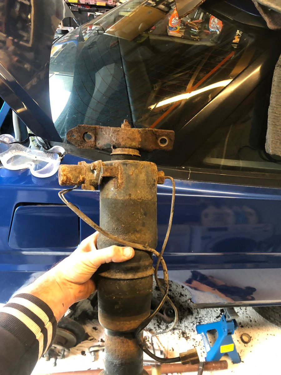

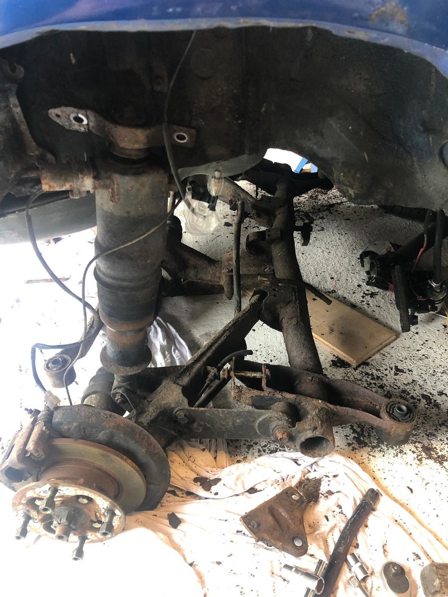

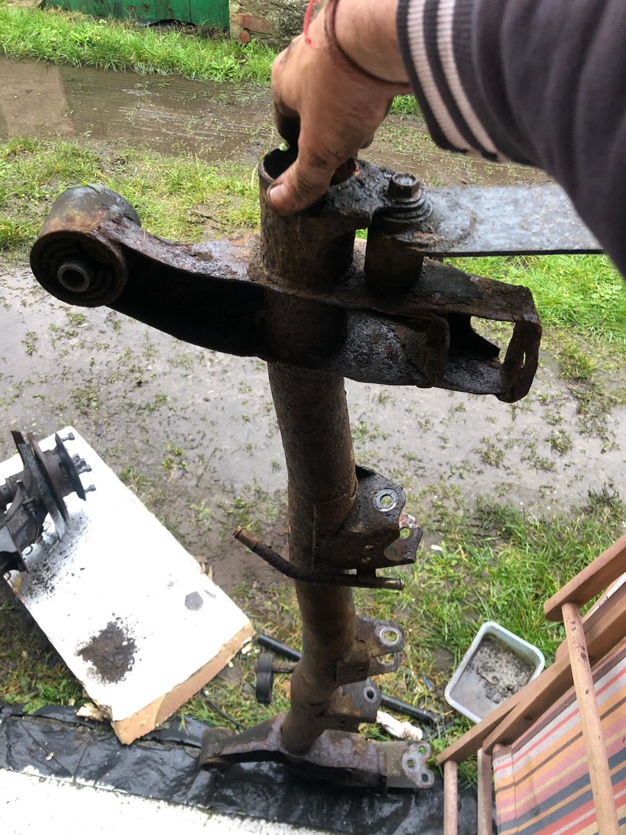

March 16, 20197 yr Author Morning guys. i will keep as much as I can.. original components..most rubber is excellent. i have new cambelt ‘kit’ and fan belt. I’ll fit when I reach that area of car. what I mean, I’m working back to front on car. Biggest jobs first. structual rust is around rear subframe mounts to car body. i took off entire rear suspension yesterday..that was a fight with rusty botls, but I managed with plenty of penetrating oil, heavy hammer and 4 ft socket handle extension! its almost down to individual components. hubs i’ll strip today. ill rebush the entire back end... I hope the are all available.. ( advice please) ill acid dip and galvanise the subframe, trailing arms and ‘T’ piece. ill electroplated all nuts and bolts too. and epoxy paint the rest. ill paint diff too. Here are some pics.

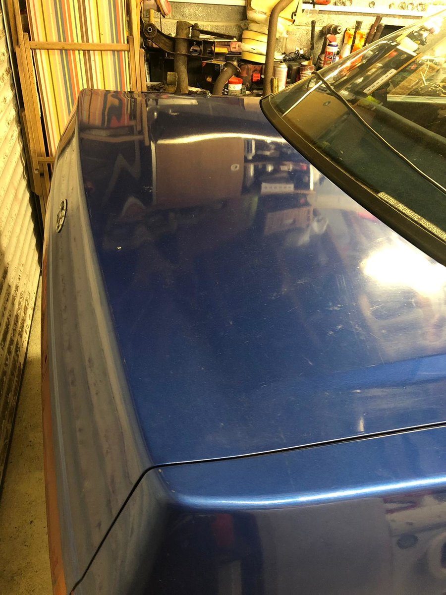

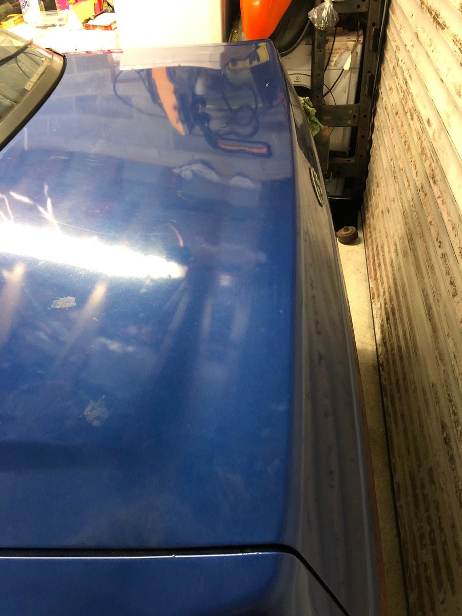

March 16, 20197 yr Hooray for air shocks! Wow man solid work! That's elbow deep with the elbow grease! To answer your question, no unfortunately ghost is still languishing at my parents but I'll get you those pics of the inside! I need to see her and she is a perfect distance to walk my dog on this beautiful Colorado day! She's coming out soon, after about 9 months, poor girl! She's with the family project, a beautiful 53 bel air...been back there 17 years!! It makes me mad I've been ready to restore her, she runs and drives! my dad is retiring soon and my bro is at a good place with his projects so what's up? @Giles would you mind getting a close up pic of your trunk lid? I am curious if i have to slightly flatten the holes for the luggage bars...would you be interested in those? Where is your spoiler? If you 3d print your front emblem, maybe I can try my hand at fiberglass molding my spoiler for you! I hope its a moot point cause you have the factory one! Cheers mate keep up the good work! 53 Chevrolet bel air "Belle" All original 235 inline six, and powerglide trans (2 speed auto) She did not come with the optional 12 volt electrical system or seat belts! Edited March 16, 20197 yr by sparkyboy

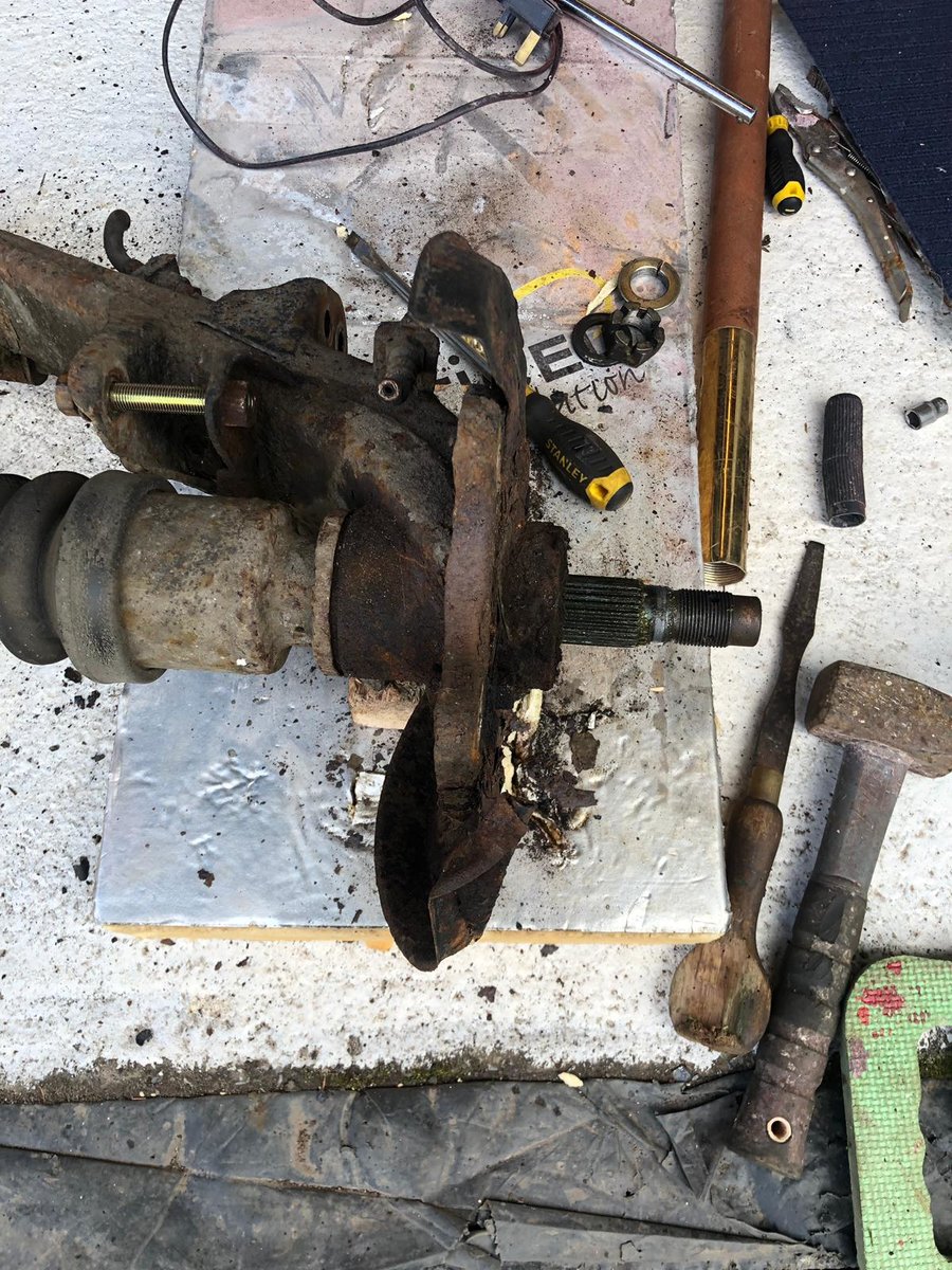

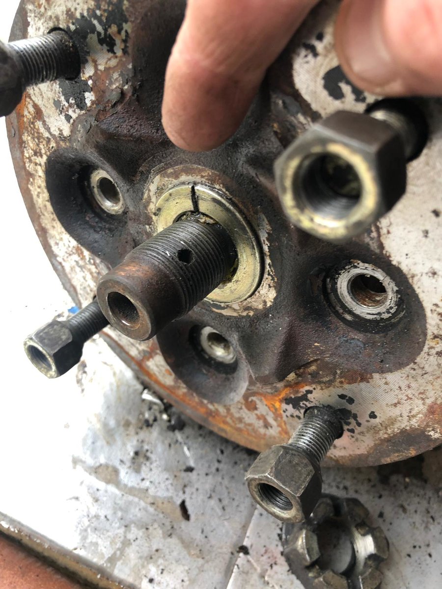

March 17, 20197 yr Author Boys: im trying to strip down rear axle. im stuck. how do I remove the Rotor ( disc) assembly. seams to be some kind of ‘split washer’ see pic please
March 17, 20197 yr I've had the best luck with a flat faced punch or bar stock, at least 1/4" in diameter. Hold it perpendicular to the flat face, give it a couple of good raps with a mid size hammer, and it should get loose. It is a cone washer. Don't hammer on the end of the axle. When I put them back together, they get anti seize. Edited March 17, 20197 yr by DaveT
March 17, 20197 yr Author Got it out the little bas***d! can you advice on rest of strip down please. as I want to get the trailing arm off.. something is stopping the trailing arm coming off, there is 1-2 mm of lateral play before it hits something both ends and stops me pulling the trailing arm off the driveshaft... I’m nearly there! Edited March 17, 20197 yr by Giles
March 17, 20197 yr There should be a roll pin through the axel, holding it onto the stub. The axle stub has tapered roller bearings, held in by a special nut on the backside of the bearing housing. There are a couple of threads with details of the wrench, etc.

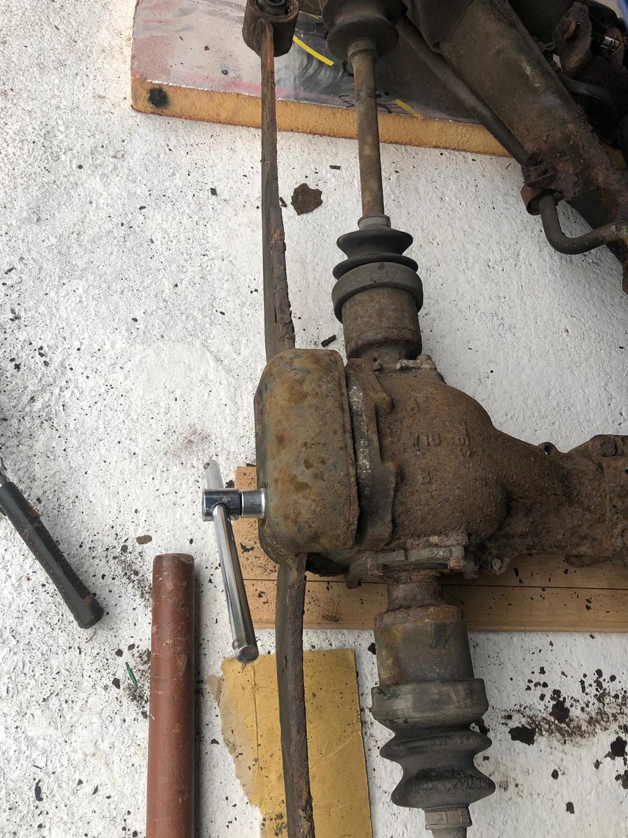

March 18, 20197 yr Author Morning boys. thanks for the information and links provided by you both yesterday, i naively assumed to axle was a one piece unit from diff. to wheel and the trailing arm would pull off now I realise it’s a little moe complex. ive taken than pin out now I need to pull the housing from the shaft.. that could be a problem... i don’t want to hammer and hammer...
March 18, 20197 yr Take joint pin out from diff end & see if you can pull the joint off the diff stub. You'll have to collapse the drive axle some & it may take some hammering on the joint cup to free it. Don't worry about hammering on the joint cups. Those cups are really tough steel alloy. They have to be to survive all the action going on while propelling the car. Once you get axle off at diff end, remove boot cover, band clamps & boot then fish for wire retainer at top edge of cup. Pry it loose with small screwdriver then innards with come free. Tapping the stub out won't take too much hammering if you use that square head sledge but protect the stub end with a block of wood.
