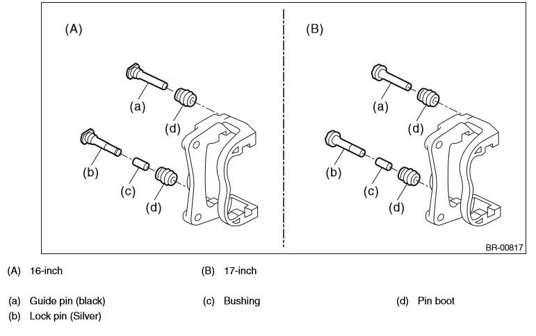

I'm not sure what these bushings are.  Are they inside the holes the guide pins go through?  Is there an exploded diagram of the caliper that I can see them on?

thanks for the diagram, a big help, and all the other advice.  I have to work outdoors  so when I get a nice day I will try what has been suggested.
