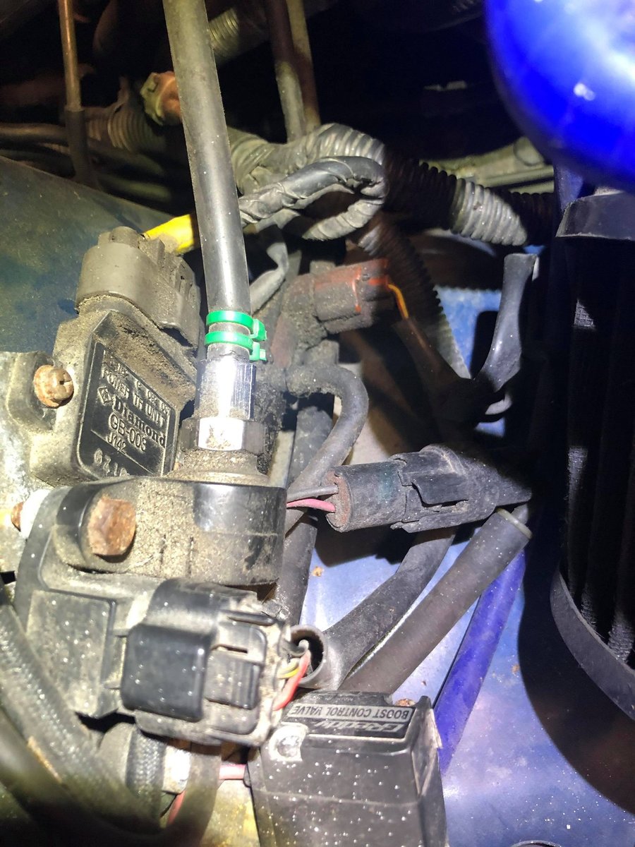

January 9, 20215 yr Author 14 hours ago, Rampage said: You said you replaced the coil pack. Is it mounted on top of the intake? Yes. 9 hours ago, GeneralDisorder said: Could be a bad external ignitor. The 97 and 98 turbo engines were wasted spark - they typically have an external ignitor mounted on the firewall. GD Could the piece saying Diamond on it be the ignitor?
January 9, 20215 yr That is it. Upper left corner in photo. The ECU sends signals to it and it controls the coil. There are two power transistors inside of it that act like high speed switches. One transistor controls the front coil in the coil pack (cyl 1 and 2) and the other one controls the rear coil (cyl 3 and 4). They seldom go bad, but 95% chance it is your problem.

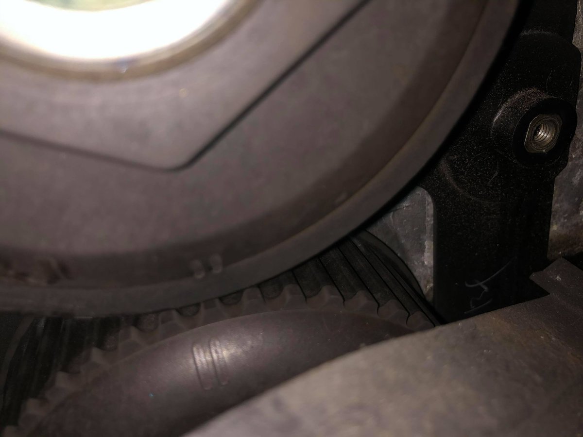

January 21, 20215 yr Author Okay, so I checked the timing today and it looks like its skipped a tooth, but only on one side. See picture below. Could this cause the no spark on two cylinders? And can anyone confirm that it is out of timing?
January 21, 20215 yr Could be normal with a loose belt or tensioner. Either way, if it's off by one tooth won't cause misfires you're seeing. Get a marker and count the teeth, if it all matches the belt is set correctly.
