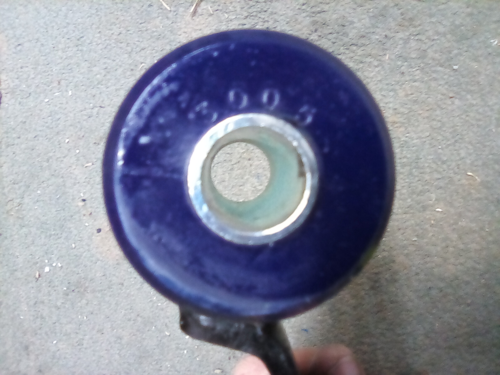

Fitting poly bush to diff hanger pic
Used a spring clamp. About the safest I have ever felt using these things!That is install grease, not stress fractures

Thanks. I used the same method for removing the old bush - the same method I have always had to resort to, that being - remove rubber surrounding crush tube, remove crush tube then fit hacksaw blade and cut through the original bush outer shell, then belt it out starting with a chisel to loosen things up. This time, I used a recipro saw, saving sweat and bent what was a new blade. I then trimmed up the cut line of the old outer shell, closed it up in a vice and welded it up in order to make a press tool to remove the moustache bar bushes , in a vice. Vice power even in my big Russian vice was not enough. They will go out same hacksaw cut method I think

What's the part number steptoe?
SPF3005K you get one in each packet

Requires the old bush outer steel shell to be removed, somehow... whatever way is your choice.

With moustache bar out for safety, I use a propane torch to burn the rubber out, again in a safe location, bang out centre crush tube. With hacksaw blade mounted through hole, I cut into the outer tube, to make a 10mm wide tear strip to knock out with a cold chisel

it is a Superpro SPF3005K , and yeah, looks like this Aussie company has a US site

I have a pic showing the same SPF3005K in the end of the moustache bar.
I sort of like doing one improvement at a time to assess things.
I had a torque wiggle in my rump on gear changes with a little giddy up. I asked on FB , got suggestion of moustache Bar ends , I think, as the cause of this. Another suggested to replace all three is good practice.
I noticed that the bush above the diff no longer had the bolt dead centre, so did this first. Reversing out and down the drive gutter, was a special sort of smooth silence, yet I never had noises or clunks reversing before. I did have a clunk turning in,  that sounded more left side rear, not centrally. Central bush fixed this.
With mo bar done, things are just smoother again
