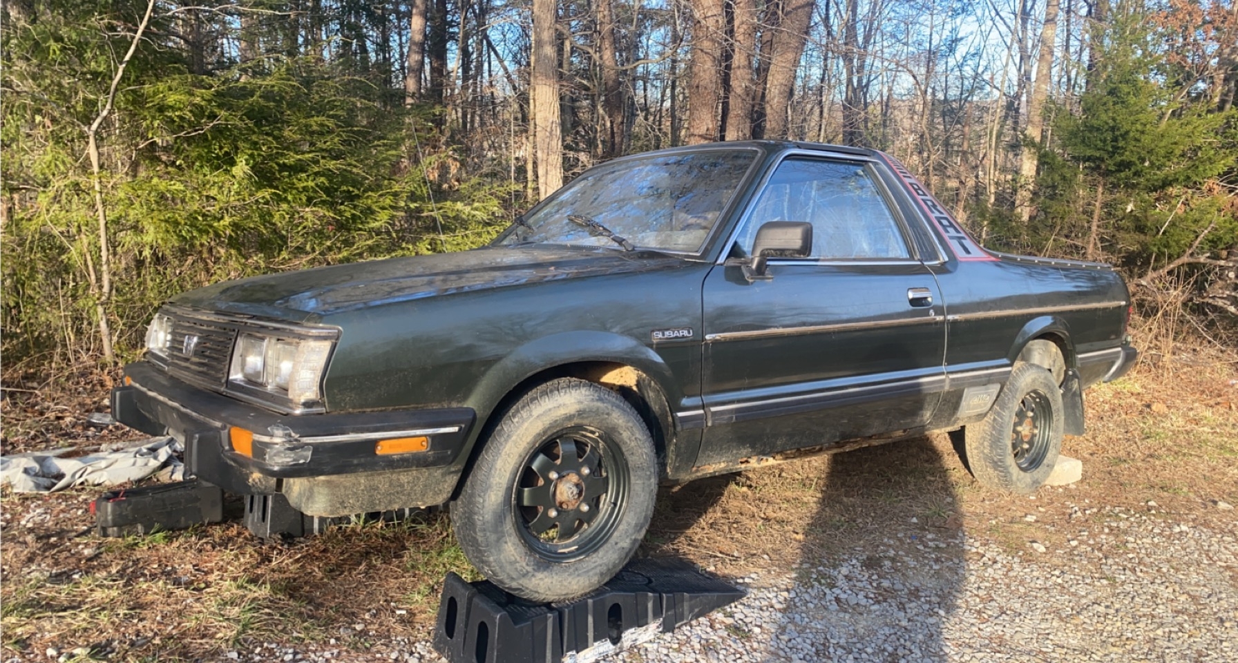

October 30, 20223 yr I’ve had my brat which is a ‘83 for about 2 years now this December last year my engine went out on me. Before I do anything apart from take out the ea81 I’m wondering if this dream I have of a 300whp brat can become a reality if anyone can give me an idea if this is even realistically possible I’d be very appreciative. Edited October 30, 20223 yr by Subiedude.12
October 30, 20223 yr That's at the upper end of a WRX EJ257 can handle, above that you'd be going to a brand X engine and a whole new drivetrain to support it. By which stage there isn't much BRAT left... Why 300whp though ? A BRAT is a light-weight vehicle, and even half that power will be enough to make the vehicle fairly twitchy.
October 30, 20223 yr Author Well it’s more of a competition see my buddy has got himself a ‘07 mustang gt and I’d like to be able to compete with him but the issue is not many build brats so I’m not sure what figures I’m really looking at to be able to compete, 300whp honestly just seems like a safe bet. I may just be ignorant tho

November 14, 20223 yr Author Yeah she’s got rust I basically ain’t got no rockers but apart from that and the where the battery goes I don’t have an issue with it.
November 16, 20223 yr On 11/14/2022 at 1:32 PM, Subiedude.12 said: Yeah she’s got rust I basically ain’t got no rockers but apart from that and the where the battery goes I don’t have an issue with it. That's all structural and further limits the viability of the chassis for performance purposes. Go buy an STI if you have lots of money to burn and actually want results. Or buy a 4th gen Camaro with an LS1, or a Cadillac CTS-V, etc. Plenty of good budget performance options without throwing money at a Subaru..... but you go die on that sword if you must. Many have and many more will. GD
