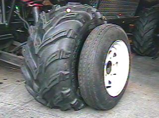

December 6, 200421 yr I had custom rims made for the buggy They weren't that pricey (more than a junkyard and less than most new Aluminum) Here's some pics... http://usmb.net/gallery/albuo21/PIC4 Or.... This guy used the core out of his existing 13" and placed them in the center of a 15", aligned and welded. Here is the article. http://www.rhinobuggies.com.au/clients_gallery.htm Further down the page you'll see folks running "dualies"... My .02 Glenn 82 SubaruHummer--Custom 12" rims 01 Forester--Factory steel rims
