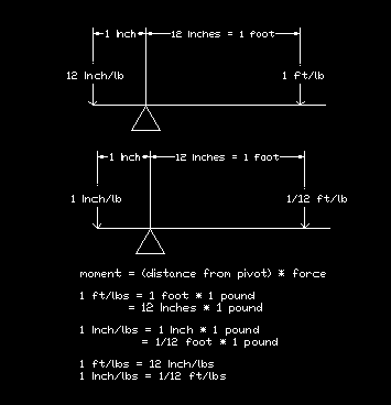

mikeshoup Posted August 11, 2006 Share Posted August 11, 2006 1 ft 12 in 12 in----- ----> ------ ----> -----------1 lb 1 ft 1 lb A little bit of unit conversion for you 1 ft/lb = 12in/lb Sorry for a bit... future math teacher, and I wanna use some of that physics I've learned in college: Actually, your unit conversion is wrong. Torque is a cross product of Force X Distance, or the vector multiplication of the moment of Inertia * Angular Accelration. As such, the units are Force * Distance. So, the correct unit conversion should be: 1 (ft*lb) * 12in/1ft = 12in*lb Pretty simple. But yes, essentialy multiple by 12 to go from feet to inches. Quote Link to comment Share on other sites More sharing options...
Manarius Posted August 11, 2006 Share Posted August 11, 2006 Sorry for a bit... future math teacher, and I wanna use some of that physics I've learned in college: Actually, your unit conversion is wrong. Torque is a cross product of Force X Distance, or the vector multiplication of the moment of Inertia * Angular Accelration. As such, the units are Force * Distance. So, the correct unit conversion should be: 1 (ft*lb) * 12in/1ft = 12in*lb Pretty simple. But yes, essentialy multiple by 12 to go from feet to inches. Blah, future math teacher as well. I'll give you that torque isn't a quotient derived unit. I hated unit conversion for a reason. [/hijack] Quote Link to comment Share on other sites More sharing options...
