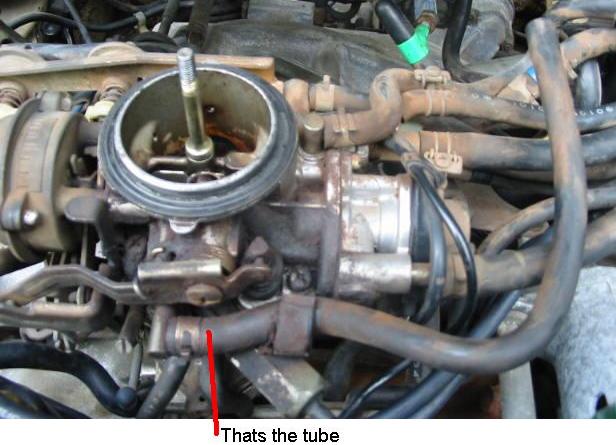

BobBrumby Posted April 2, 2004 Share Posted April 2, 2004 I have a line runnin from the front of the carb that is about 6 inches long that goes to nothing. The place where the tube connects onto the carb is near to this hexagonal prism with a wire coming from it that screws into the carb. And is possioned on the front of the carb(closest to the radator) and rather high up on it. When I put my finger over the tube when the car is running it increases its idle by about 100-150 rmp. I also blew into the tube and could hear a hissing sound from inside the carb (i think). Could anyone tell what this line mite do or way to find out? Any help would be great. And I could take a photo tomorow if that would help identify it. Quote Link to comment Share on other sites More sharing options...

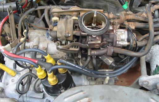

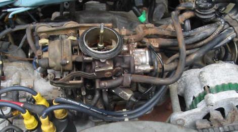

BobBrumby Posted April 2, 2004 Author Share Posted April 2, 2004 All pictures taken from infront of car with the air cleaner pushed back. The offending line is only marked on the first pic. Quote Link to comment Share on other sites More sharing options...
Aldoat Posted April 2, 2004 Share Posted April 2, 2004 That line is supposed to connect to a GREEN T-fitting just like the one pictured at the top of the pic. There are two of those. It connects to the mid port on the T and one of the cross ports is capped off. The other T fitting hase both cross ports connected to medium/large hoses and the mid port is connected to the small hose from the air cleaner Idle Compensator (valve on right side of air cleaner as you look at it from front of engine). Went outside and looked at my 86 EA81 Brat. Quote Link to comment Share on other sites More sharing options...
BobBrumby Posted April 3, 2004 Author Share Posted April 3, 2004 Aldoat on mine both the green t pieces are on tubes that goto air control valve, one t peice is complety blocked (one in pic u refered to) cept the line running to air control valve and the other runs from carbi to air control valve with the extra fitting blocked. This seems to be a little diff from what u described as none of em goto the air cleaner valve. Yeh the air preheat has removed cause its never cold enough here if this has anything to do wif it. Should i plug this line on the carb or is it not doing any harm leaving it in the open air? You have goto love previous owners Quote Link to comment Share on other sites More sharing options...

GeneralDisorder Posted April 4, 2004 Share Posted April 4, 2004 You can safely just plug that sucker. I've got that line plugged on my Brat. It's part of the vacuum system for the evaporative emmissions system. I would just plug the port, and forget about it. The RPM increase is because you are "fixing" your vac leak when you plug it off. GD Quote Link to comment Share on other sites More sharing options...

Aldoat Posted April 4, 2004 Share Posted April 4, 2004 OK, wasn't able to get pics but that line goes to a T-connector that also runs to the black vac valve that sits over the driver side Air suction Valve. It's all part of the emmissions system. Cap it off if you don't have to worry about passing emmissions/under hood inspection. I have emmissions testing here in NJ so I still have everything hooked up. Quote Link to comment Share on other sites More sharing options...
