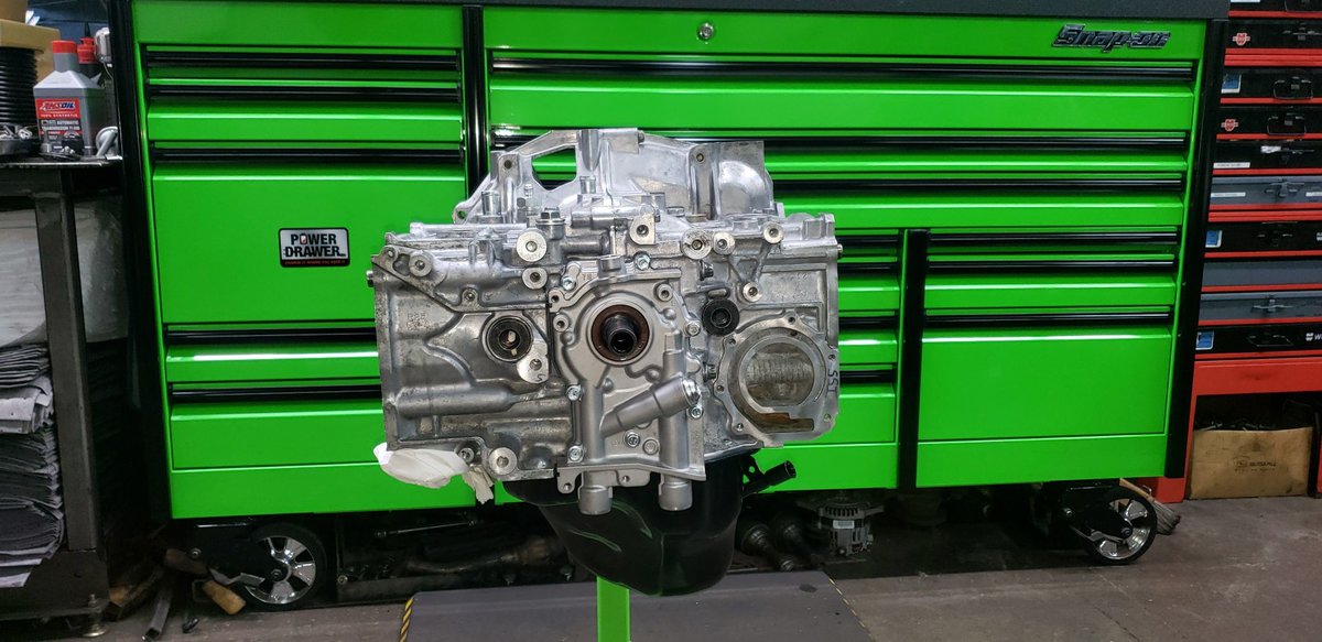

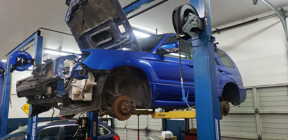

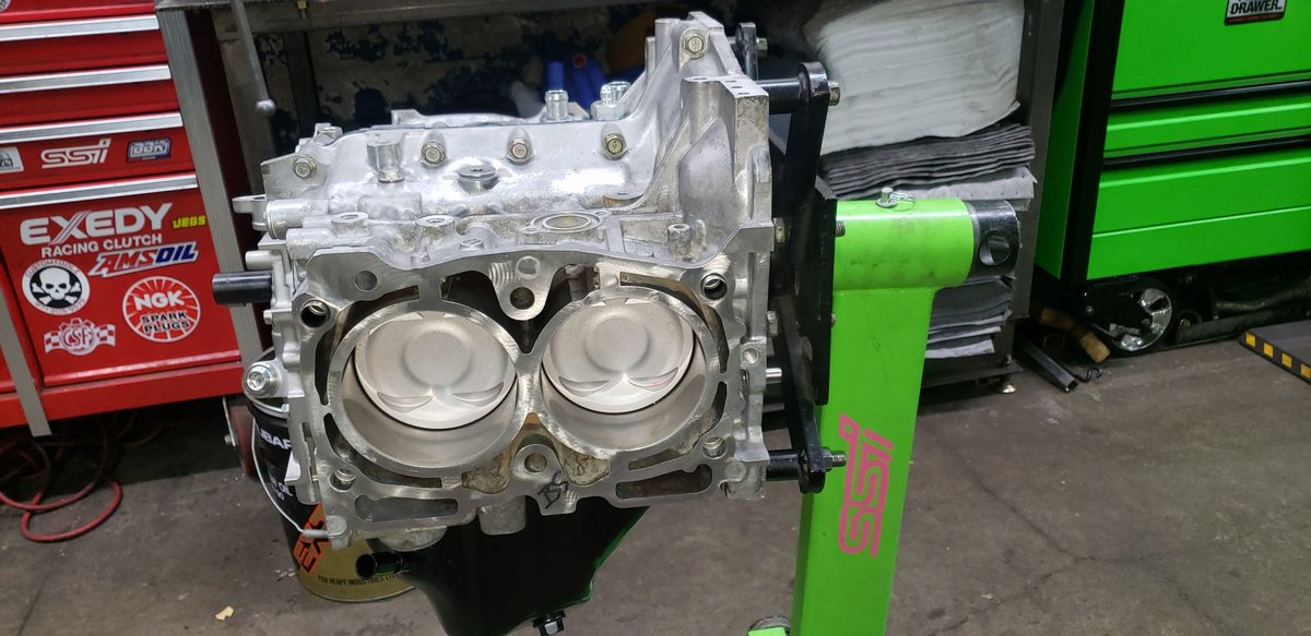

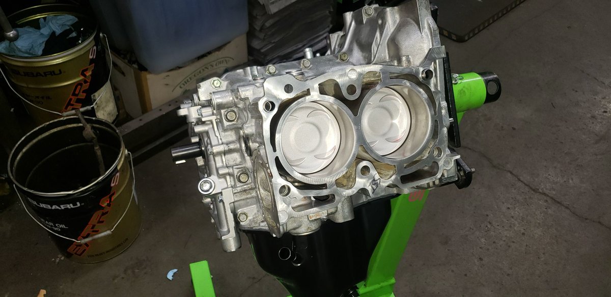

    a little update that GD gave me. car is having some paint done this weekend. next week the engine get dropped in , tuned and tested! Guess the headlights had moisture in them so they took care of that and are putting 2011 wrx heads on it. he was also able to get a rear spoiler for it! Just wanted to say that General Disorder has been awesome to work with. <------cant say this enough on a side note i kind of had a freak out moment. i got a 1 way ticket through frontier and the other night i got an email saying that the ticket had been changed. when i called i got a messege saying that it was a computer glitch, to check online and that call wait times were over 60 minutes. when i checked online everything was fine. I used to like flying when i was younger, now it just seems like a huge hassle countdown: roughly 312 hours give or take a few
