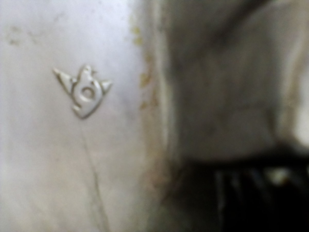

Well it is obviously a bird of some sort and I immediately thought of Robin but looks more dove or pigeon

Took time to scribe is all thanks
