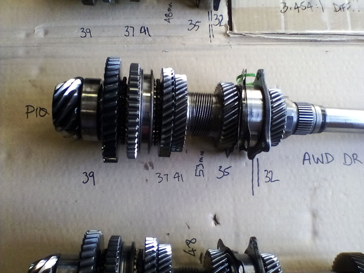

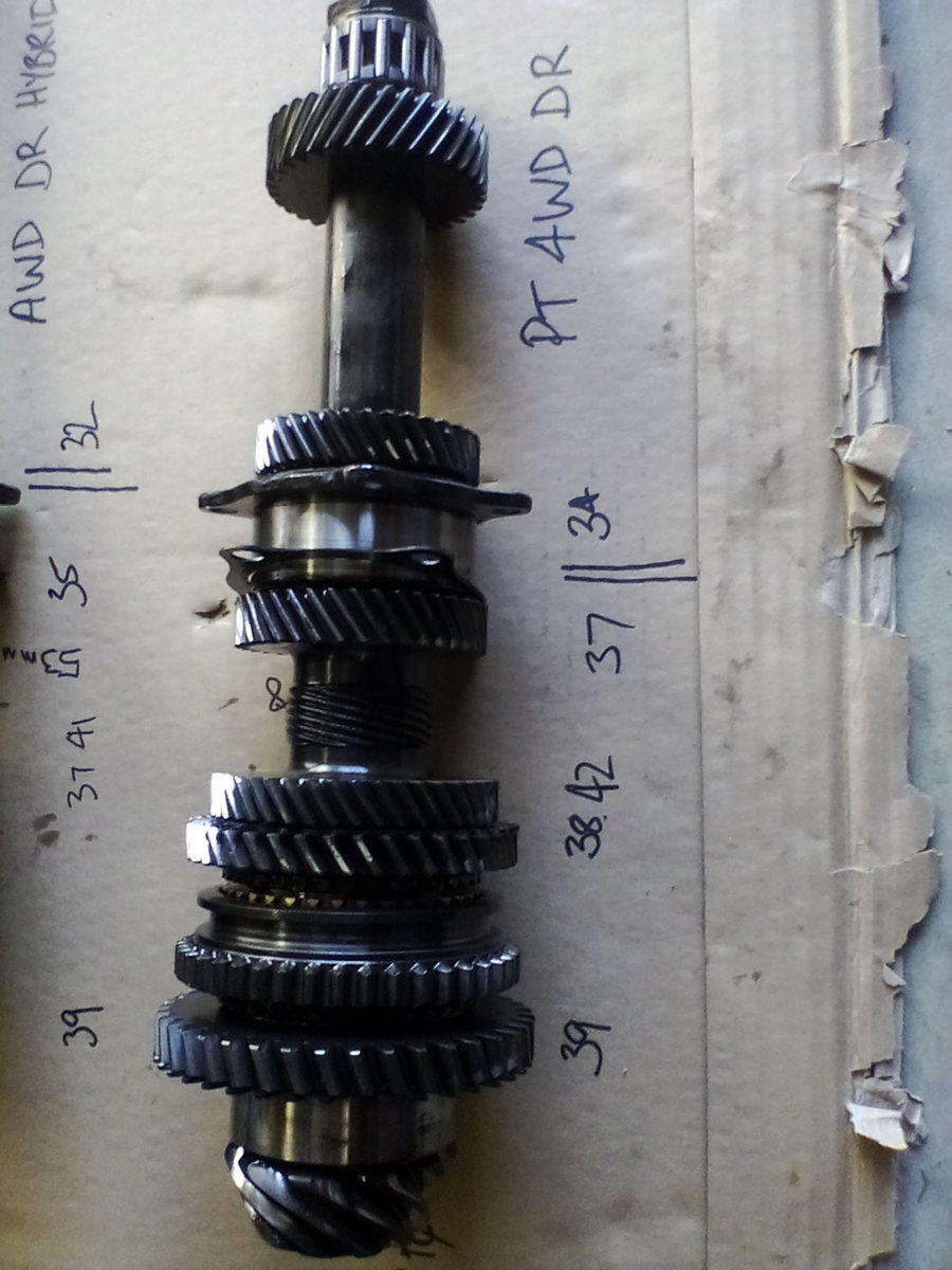

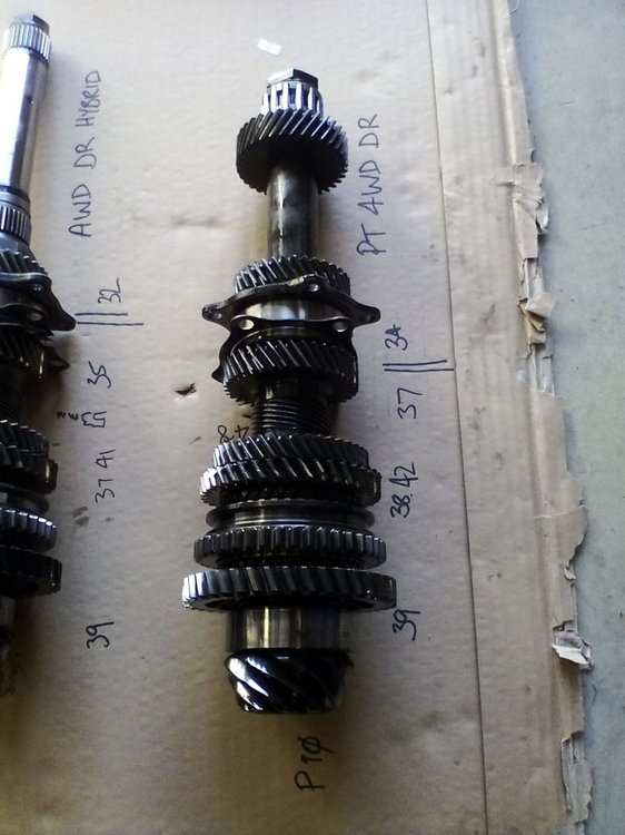

I like your handle ausubaru92. No idea where you got that from Next thing iI guess I need to count teeth on the other side.... coming up I've done gearbox repairs and rebuilds before Subaru 4WD 4MT put me off. It is better notneeding to drive gearbox the next day Thought I'd compare the innards of my hybrid 5MT DR AWD EA82 box with standard box also in bits
I have the main shafts of two boxes side by side on some cardboard Looking at the cogs to line up with hi lo counter shaft cogs I have on std dr box 19 and 25 teeth My hybrid has 25 and 22 My std 5MT DR is from a 92 wagon. Teeth count First 11. Hybrid 11 Reverse 12. Hybrid 12 Second 18. Hybrid 19 Third 29. Hybrid 30 Fourth 34. Hybrid 36 Fifth 39. Hybrid 41 Both have 3.7:1 diffs Anyone know how to figure ratio of each cog for the two shafts?
