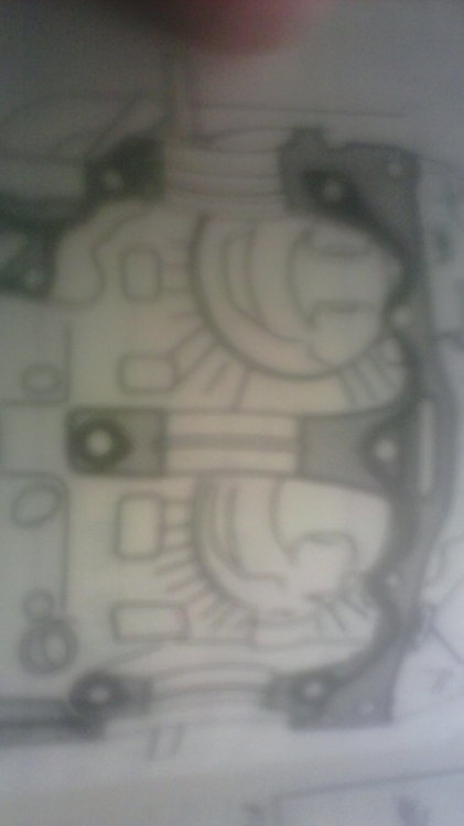

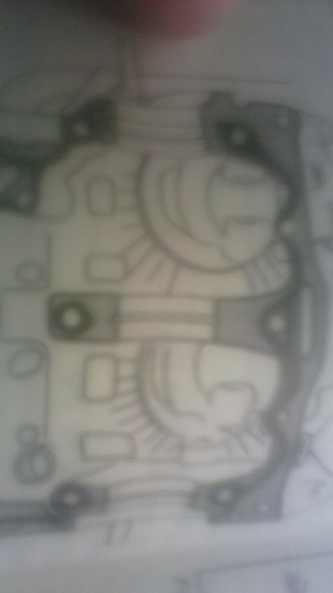

thrust side must alter left to right case?
I am reading piston ring install instructions advising ring gaps not be on thrust side. If our boxers operate clockwise from front thrust is said to be left side of bore So...this would make 1 & 3 thrust side the lower side of bore/piston and top side for 2 & 4 ? Correct?

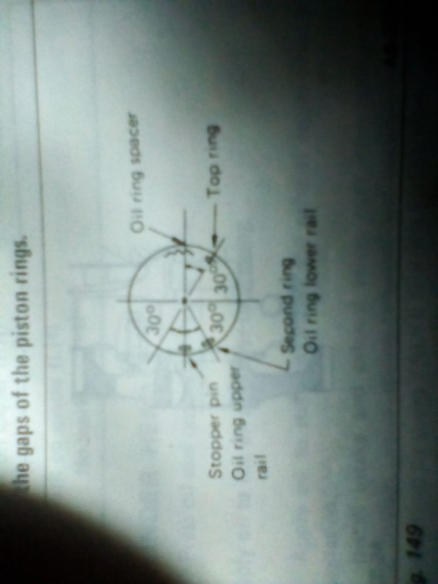

Who knows EA82 ring gap spacing?

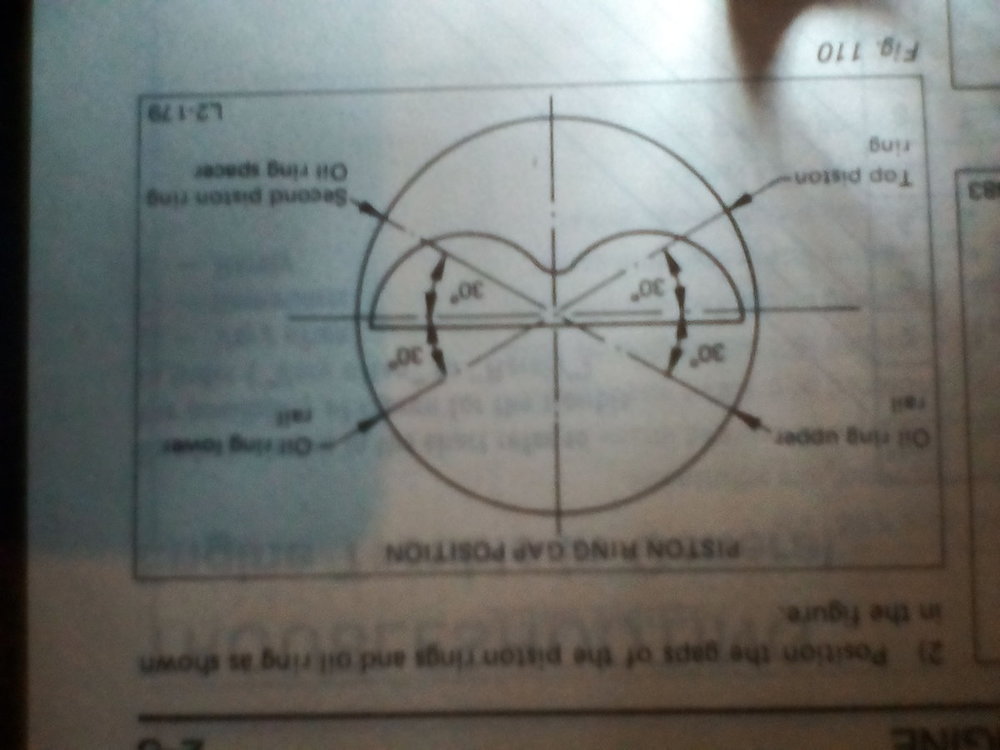

Thanks for the Gregory's input - totally forgot their opinion ! Looking at my factory manuals for Series One again the diagram with no gaps above centre line is in the ohv section. The ohc section has gaps above.the centre line and the diagram # in both books is the same L2-179 Fell for the old two engine models in the same manual trick The Series Two manual is XT specific so does not contain ohv stuff. Fortunately Fuji didn't do any ohv XTs. What a thought !!
The ring gap placement differs for the EA82 pistons for 85/86 models to 87 in the factory manuals. Pistons do also Anyone know if the 87 position ing is an upgrade on earlier method or just to suit piston change? I can make options wlorse if I read a general instruction sheet I kept from EA81 build and they were followed using Volvo spec rings. Earlier tends to keep all gap placements below the centre line whereas the latter are all 30° off the centre line
