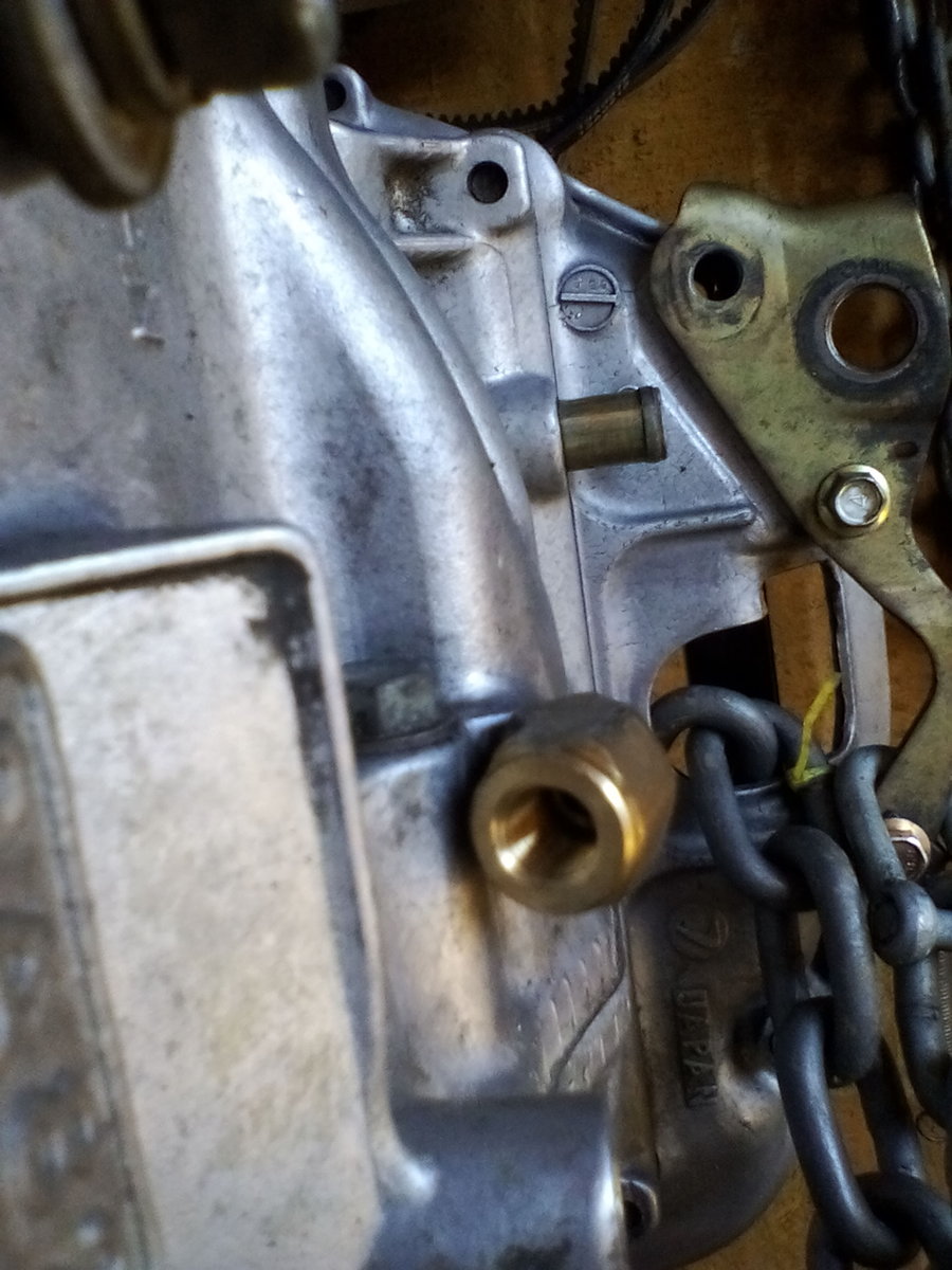

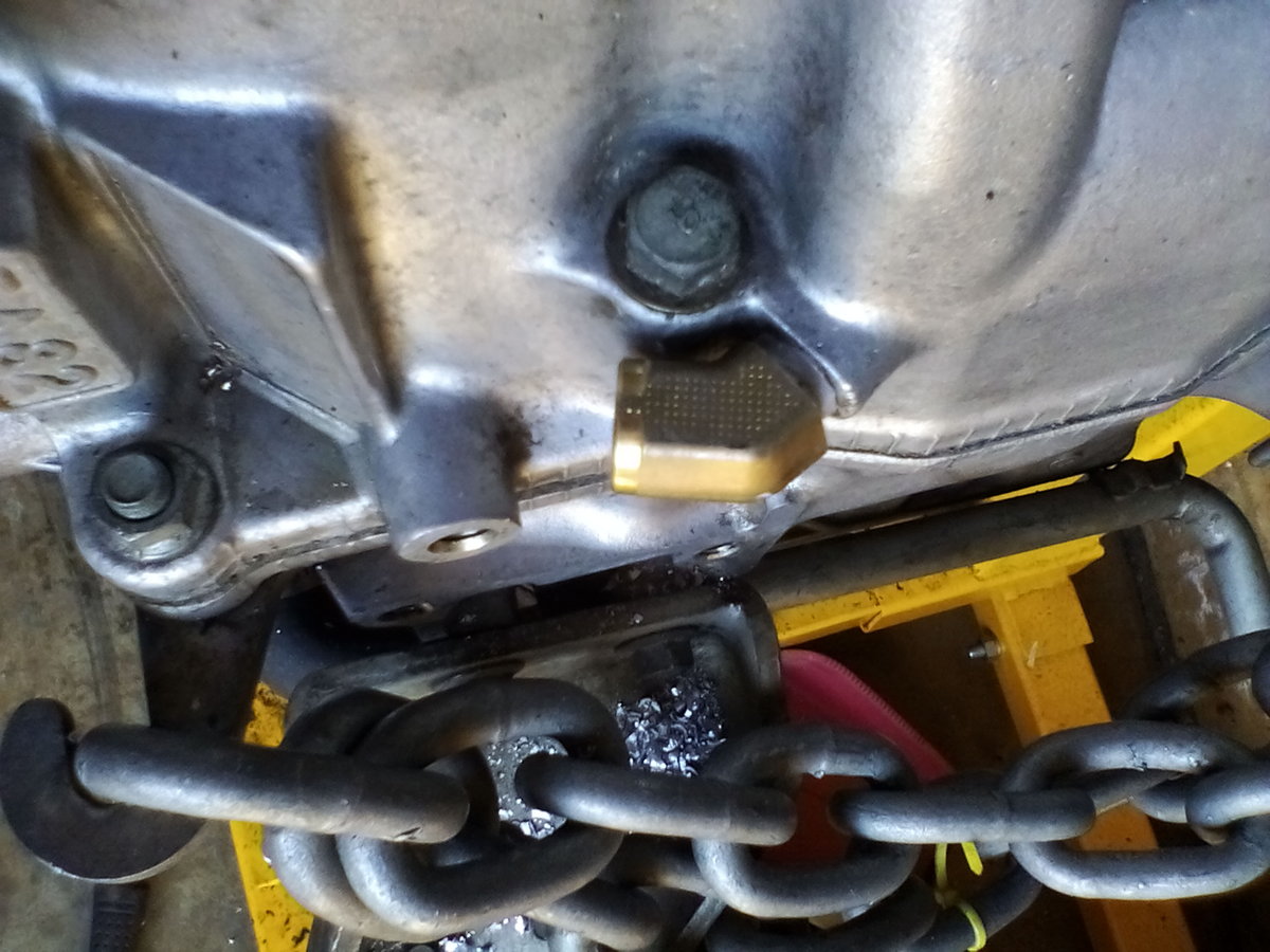

  20. Guess what readers. The pin is 6.00mm diameter. I don't think Fuji followed anyones rules .... I have tried rare earth finger clanging magnets to no avail. I did get the heat gun from its packaging and warmed up the casing , and figuring if you grabbed the metal pin with ice cold Vise Grips with really good teeth, it must shrink it enough to come out ...And I got the little sucker. Yee..bloody..HA ! Milwaukee'd the hole in the side, all on a spare gearbox casing 3/16 hole ....US not supply metric hex drive drill bits in Oz yet My supply of grease nipples is pre metric, probably before Australian threads made a stand against Whitworth, so popped into SCA and found someone had pilfered one of two M6 nipples in a two pack. Suited me ..needed one...paid for just one Giving credit to CZNY for this approach...it is a long time since I have used grease to hydraulic things out. This little sucker is 8.00 mm long. In practice unit I marked out 10mm below surface and drilled the 3/16 and like any seasoned tunneler - came up at perfect spot, tearing the dimpled bottom out of the locating pins hole !! More later, when things are done

  23. Yep czny , precisely but still need the rare genius to come up with knowing where to drill said hole. So far nobody stating the length of this little sucker I tried to order a new pin. No such part number. Dealer says in the day if you ordered a new case get the pin already installed I don't know, where have all the knowledgeable ones gone?
