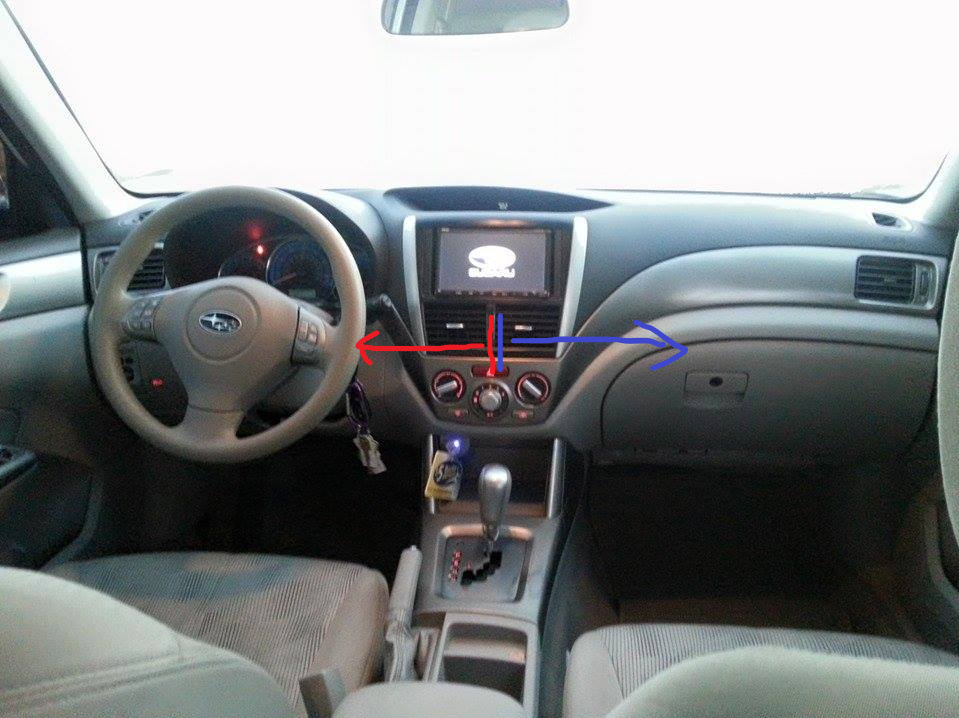

Dual climate on a not dual... forester?
crazyman03 replied to crazyman03's topic in 1990 to Present Legacy, Impreza, Outback, Forester, Baja, WRX&WrxSTI, SVXI'm still at a loss for this one. I pulled the center of the dash apart and verified that there is tension for both the blend knob and the mix knob. Both go to their appropriate doors - blend on passenger side, and mix on the driver. They move the door unobstructed, freely and all the way to the end of its actuation. I also verified that the center ducting is not shared. they divert off to their corresponding sides (L/R). Since the car is not dual zone, it would seem silly to have 2 heat/blend doors for each side when it doesnt call for it? -Justin
