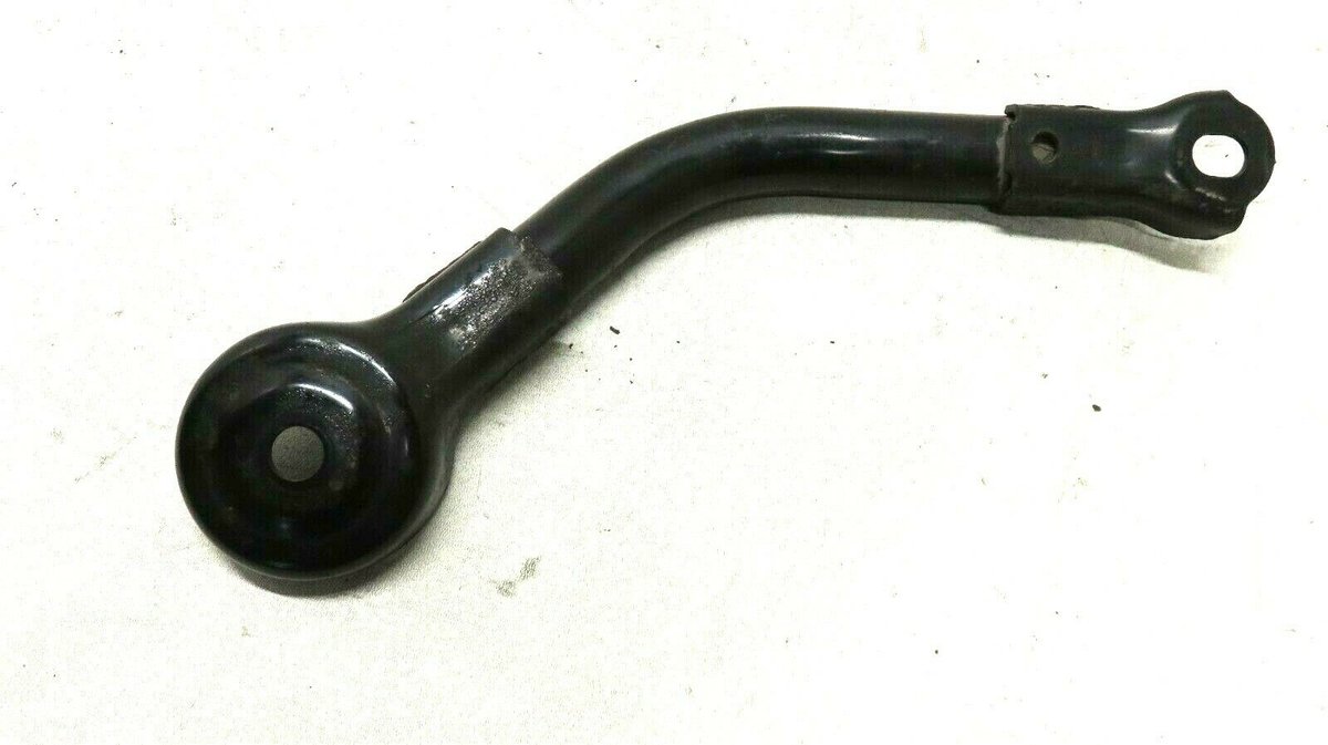

Outback torque value needed
SUBARU3 replied to SUBARU3's topic in 1990 to Present Legacy, Impreza, Outback, Forester, Baja, WRX&WrxSTI, SVXYou are the best!!! Thank you!
Would anyone know the proper torque for the rear support braces (2 bolts each) (left and right) on a 2005 Outback? These are the 2 curved bars left and right at the rear...(pic) One side has a VERY long bolt and the other side a shorter one. Thanks!
