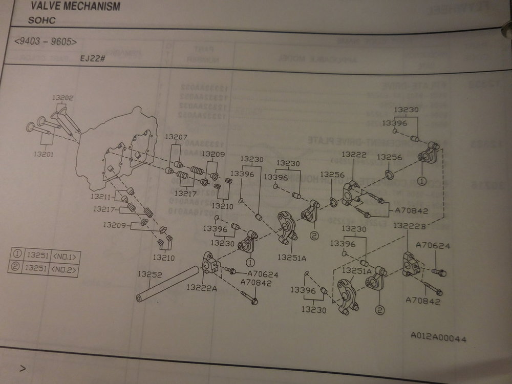

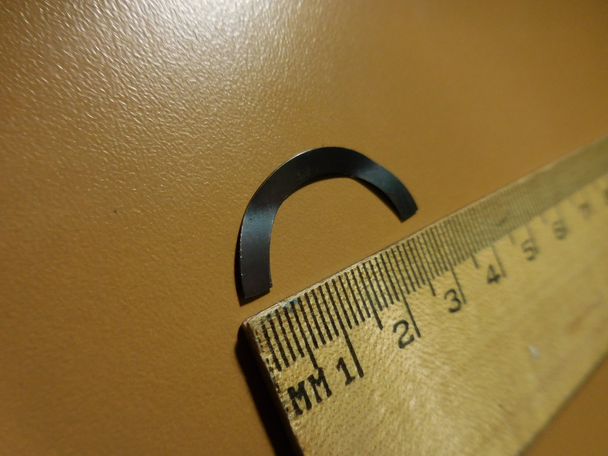

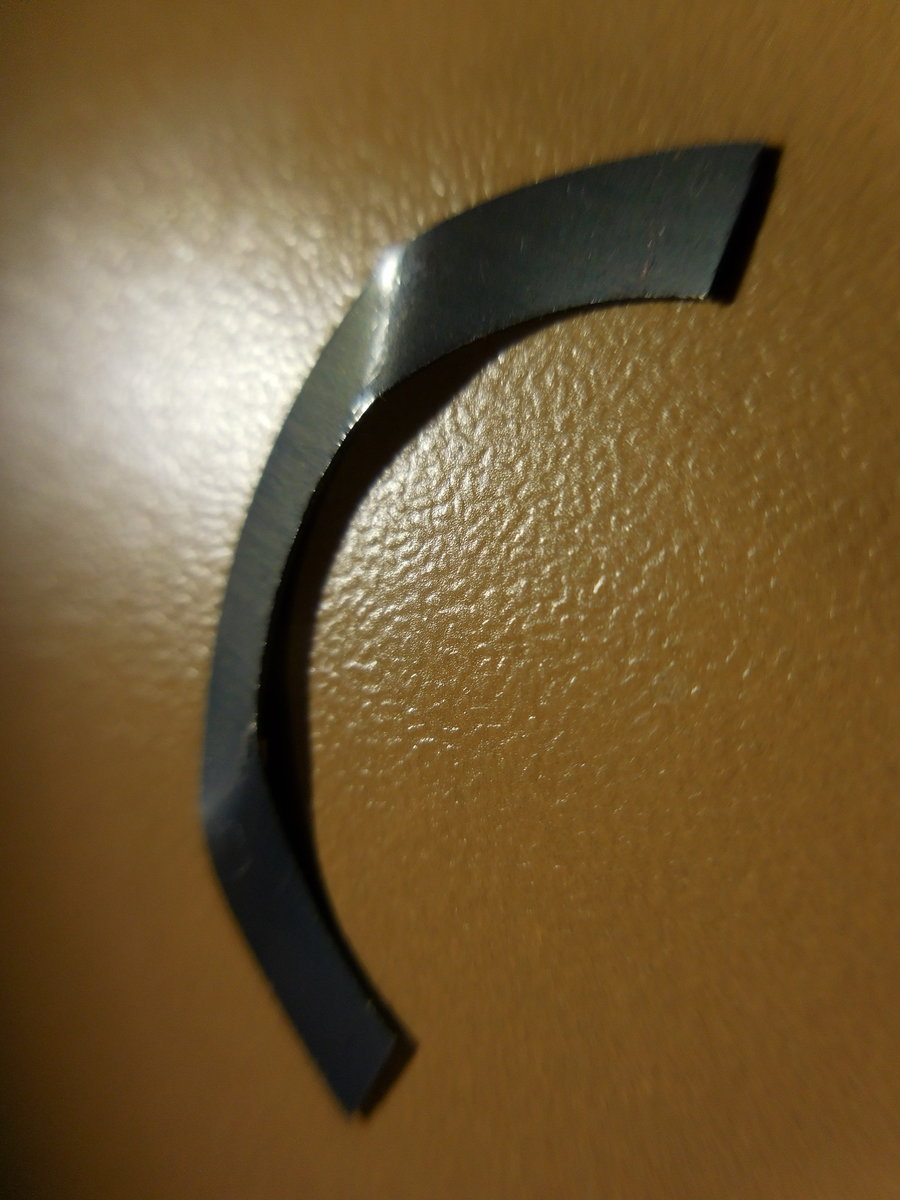

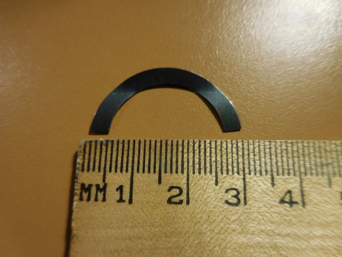

Any ideas? This found in oil pan.
SUBARU3 replied to SUBARU3's topic in 1990 to Present Legacy, Impreza, Outback, Forester, Baja, WRX&WrxSTI, SVXThanks so much!!!
SUBARU3 replied to SUBARU3's topic in 1990 to Present Legacy, Impreza, Outback, Forester, Baja, WRX&WrxSTI, SVXLooks like a common issue!
SUBARU3 replied to SUBARU3's topic in 1990 to Present Legacy, Impreza, Outback, Forester, Baja, WRX&WrxSTI, SVXCan I ask another quick question?? This same car is OBD2, although it's an early 1995. When reading the computer, EGR and CAT are never ready. I have read that they will never be ready on these early cars. Is that just normal. Car runs fine, no issues. Passed emissions like brand new, (tailpipe sniffer)
SUBARU3 replied to SUBARU3's topic in 1990 to Present Legacy, Impreza, Outback, Forester, Baja, WRX&WrxSTI, SVXThanks everybody! I have to do valve cover gaskets soon anyway and will look closely for the other half. Will it cause problems on the shaft with it missing?
I just changed oil in my 95 Legacy 2.2 AWD 105K . I decided to stick my finger in the drain hole to see if there was any crud on the bottom of the pan. I felt this loose object! I placed a magnet rod in the hole and picked up what is pictured. What is it? I have had the car since 1999 and there is no issue with the engine. This may have been in the pan for many years. It is steel and has a slight uniform bend in it....it's a perfect 1/2 circle. Ideas? Anything to now worry about all of a sudden? Todd
