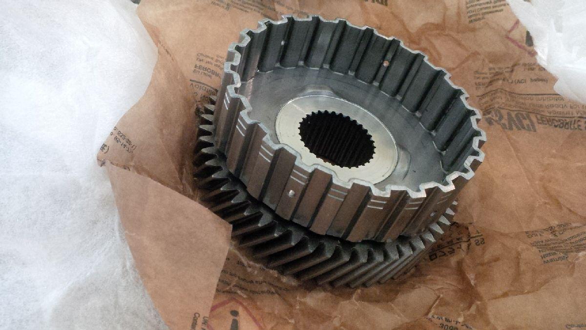

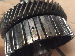

I started this thread about 5 years ago. I finally got around to fixing this issue. In 5 years I put about 15K miles on her. I replaced several things including the AT reduction gear. I choose not to file down the grooves. I figured I was doing the work myself and saving on that end. I am thinking about doing a procedure for this but for now I will list the part numbers I used. The transmission shifts like butter now. Now sure I even had the skill 5 years ago to do this. If you have not had your exhaust off in the past few years this task could be doubled in effort and price if you need to start replacing exhaust parts that you are cutting out. I replaced almost my entire exhaust about 6 months ago. I did replace the transmission control module 5 years ago and that did not fix the issue. Just denial of what the real problem was. I am guessing a shop would have been $1,800 for this entire job with parts. Next on my list is a complete AC system replacement. See you in 5 years 31337AA120 GASKET TRANS CASE REAR $9 31523AA410 PLATE SET- TRF CLUTCH $115 31942AA090 VALVE AY TRANSFER CLUTCH $95 31954AA071 Gasket transfer Valve Need 2 $3 31952AA030 PLATE-TRANSFER VALVE $2 31450AA260 GEAR COMPLETE-REDUCTION DRIVE $145 (This is the basket that has the worn grooves) 31377AA020 Ring Seal Need two for the half shaft $10 806536020 THRUST BEARING $8 4409 EagleBHP Transmission Mount $20
