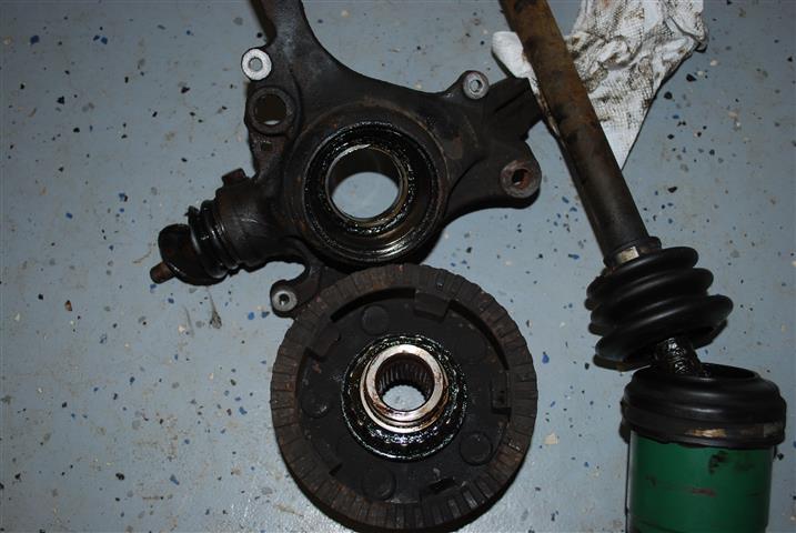

Wheel Bearing Hub Knuckle Troubleshooting
msmithmmx replied to msmithmmx's topic in 1990 to Present Legacy, Impreza, Outback, Forester, Baja, WRX&WrxSTI, SVXWhen I did mine it was clear from the markings that the bearing did spin so I replaced it with a Dorman hub I found on Amazon for $40. I also used a sealed bearing by GMB 758-0003 for my 98OBW "front bearing". The last job only lasted 2-3 years. I did use a new shop to press this last one in. I also just marked the camber bolt to avoid a front end alignment before I pulled off the knuckle. I would have replaced the whole knuckle and tried but bone yard knuckles are 15+ years old and rusted with broken speed sensor and ball joint bolts.
msmithmmx replied to msmithmmx's topic in 1990 to Present Legacy, Impreza, Outback, Forester, Baja, WRX&WrxSTI, SVXI did drop the brake fluid some but then the brake light went on. In the end is was several things on a 16 year old wagon. I would have bet it was the transmission but it was two stuck calipers, axle, ball joint, wheel bearing, hub and a rotor that all contributed to the problem. I have fixed all of it and if I had to use a shop I think this OBW would have headed to the bone yard. Thanks for the guidance and help. This summer is a duty c solenoid and clutch pack. I am going to finish a thread that was started back in 07 by someone on this forum.
msmithmmx replied to msmithmmx's topic in 1990 to Present Legacy, Impreza, Outback, Forester, Baja, WRX&WrxSTI, SVXHello, I did make sure it was at the full line. I pulled the wheel off and the caliper was frozen. I am going to put on a reman this weekend. One thing to note. About 6 months ago I rebuilt every caliper. I have around 1K miles since. Wonder if that kicked this off. I will report back when done.
msmithmmx replied to msmithmmx's topic in 1990 to Present Legacy, Impreza, Outback, Forester, Baja, WRX&WrxSTI, SVXDoes this make any sense? I just finished the job on the front Driver side wheel. Caliper, Axle, Pads, Rotor, bearing and hub along with a break bleeding. I am going down the road 40MPH and smoke is now pouring out of the rear driver side wheel well. I am not a real big believer in coincidences. Any ideas?

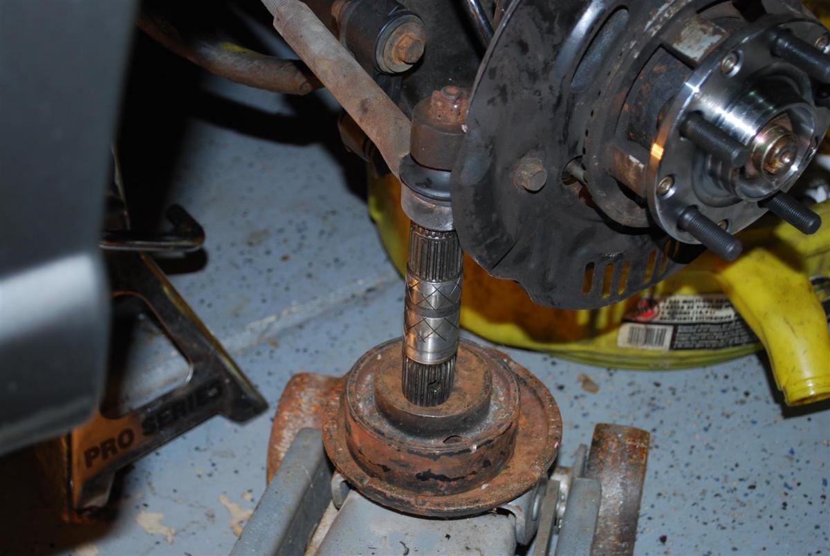

Tie Rod Install Question
msmithmmx replied to msmithmmx's topic in 1990 to Present Legacy, Impreza, Outback, Forester, Baja, WRX&WrxSTI, SVXThank You.. It worked like a champ. Now for some trivia for those that are bored. What did I use to bridge the gap between the jack and tie rod. It is from a Subaru.
msmithmmx replied to msmithmmx's topic in 1990 to Present Legacy, Impreza, Outback, Forester, Baja, WRX&WrxSTI, SVXGreat ideas. I will try the jack method first. Thank You
98 OBW 240K. I am deep into fixing a suspension issue and this is the last problem or so I think. The root cause of this is tracked on another thread which I will update when complete. I was connecting the outer tie-rod to the knuckle yet the castle nut will not tighten past 5 pounds. The threaded post on the tie-rod just spins when it gets any tension. Is my tie-rod end busted? I am hoping not as taking this off will pave my way to a front end alignment. A simple problem has turned into being pecked to death by a thousand chickens. When I list the parts I have replaced your head will spin.
msmithmmx replied to msmithmmx's topic in 1990 to Present Legacy, Impreza, Outback, Forester, Baja, WRX&WrxSTI, SVXSettled, I will grab one off eBay
msmithmmx replied to msmithmmx's topic in 1990 to Present Legacy, Impreza, Outback, Forester, Baja, WRX&WrxSTI, SVXHi Dave, I do not see any wear on the hub. Could it be too small to tell?
msmithmmx replied to msmithmmx's topic in 1990 to Present Legacy, Impreza, Outback, Forester, Baja, WRX&WrxSTI, SVXIt just so happens I have a spare OEM used axle from a last batch of parts I picked up. Does anyone reuse the bearing seals? They are 2 years old tops.
Hello, I am back. 98 OBW 240K. This is how it started. Out of nowhere the wagon felt very sluggish like something was holding it back. Drove it for a few weeks thinking it was the transmission and knowing my duty c solenoid is busted I was just waiting the clock out. Then it happened smoke started pouring out of front driver side wheel well. Now I am thinking stuck caliper. So I pulled the wheel off and started troubleshooting. Sure enough the caliper is frozen solid. Knocked it off with a dead blow hammer and then I saw a torn ball joint along with a torn axle boot. That forced me to tear apart the front driver side suspension to start getting everything fixed. Here is my question. When I unbolted the knuckle and pulled the axle out of the transmission the hub just fell out of the knuckle. Does this mean the hub was also spinning in the knuckle? I can push the hub back into the knuckle and get it to almost site perfectly. The shaft of the hub does not look worn but the race is still on so I can't be 100% sure. What do you guys think? Could the stuck caliper have caused this? The wheel did not wobble at all before I took this apart. Anyone ever see the two units just fall apart? I attached a pic so you can all see this wonderful mess.
