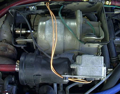

Yes, the AC comp is the fastes and best way to go for on board air. It's eazy to do, just cut the rubber lines as close to the unit as poss. then U can tell wich one is the pressure. on the draw side install a drip oiler, and a filter of some type. then run the wire from the cluch to an air compressor switch. That one in the pic. is from the air ride sys. on a Buick Rivieara, but LOTS of cars and trucks in the '80's had some type of air ride sys. and all the compressors are about the same.
For those looking for a good cheep on board air comp. go to the wrecking yard and look at '80's full/mid size American cars for one of these. They make over 110psi, are very quiet and last forever;)
