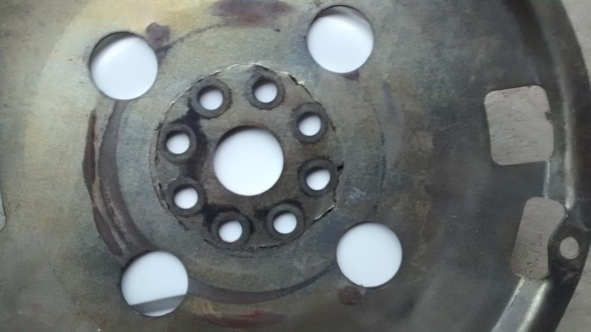

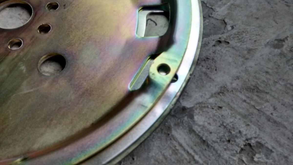

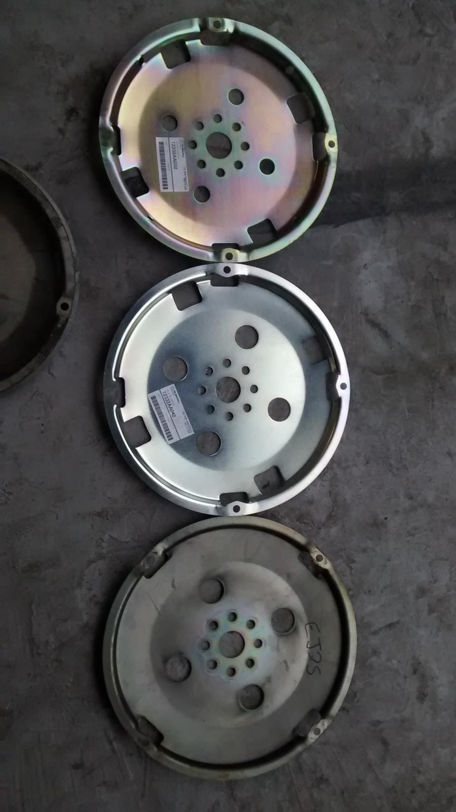

Txakura replied to Txakura's topic in 1990 to Present Legacy, Impreza, Outback, Forester, Baja, WRX&WrxSTI, SVXIvan nailed it. The only plate that matched this description was the 1992 Legacy Sport Turbo. I got the second to last one in the USA. Ivan and I were going to trailer park boys some kind of exchange on the border but the Predator drones scared him off. I tired to tell him the tin foil hat would keep the hellfires from locking on, but he wouldn't believe me. my cracked plate, yes we drove all the way to wcss and back with that (ignorance is bliss) top to bottom, 'normal' ej22, the plate only found on the 92 Legacy Sport Turbo and the EJ25 plate some schmuck handed my GF after she drove 110 miles without bothering to compare them ej 22 on top, 92 Legacy Turbo in the middle, ej 25 on the bottom, bolt holes are lined up, this is the diameter difference I hope by posting this that it may save some poor soul a lot of grief Cheers

Txakura replied to Txakura's topic in 1990 to Present Legacy, Impreza, Outback, Forester, Baja, WRX&WrxSTI, SVXturns out there is a third, it's between the ej 22 and ej 25 plate. early turbo plate according to Ivan. it is indeed half way between the two for OD and torque converter bolt locaton... since I now seem to have all three plates and need to fly to Japan or sneak into Canada to get one from Ivan

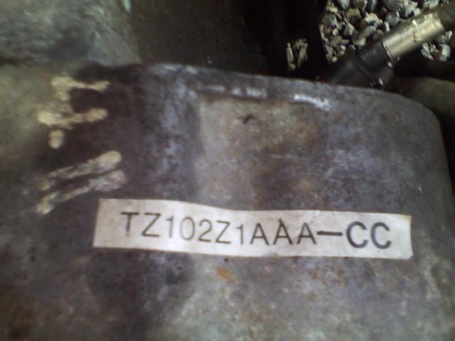

Hey transmission gurus, I have a TZ102Z1AAA-CC in the car and a possible TZ102ZABAA-CL to swap in. Are they are both 4.11? Does the full code reveal additional pertinent info to anyone in the know?
