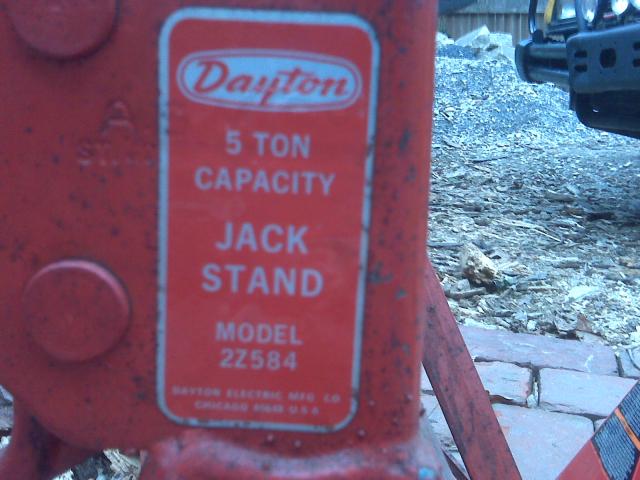

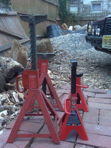

I found these locally on CL for $10. They're 5 ton stands. They make my 2 ton stands look tiny! My father-in-law has tractor work soon so these will come in handy. Anybody know about Dayton brand?

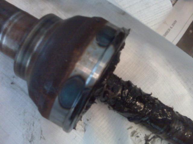

whew... blue spots normal, good to go! The concave side does face the spring clip (facing the shaft). After closer inspection and trying both ways, it now makes sense to me seeing the internals move within their range of motion. It's subtle, but the non-concave side actually catches slightly if its facing the shaft, ever so slightly. Thanks guys!
I am rebooting my front PS axle using Numbchux's awesome write-up in the USRM. I have two questions... First, how does the inner race in the DOJ get oriented when reinstalling? The FSM doesn't indicate one way versus the other. There is a slightly more beveled edge but other than that it seems very uniform, almost like it wouldn't matter. Does it? Secondly, I figured I'd reboot the CV as well, and found this scoring on the outside of the CV. What's this mean? There's no clicking or indication of failure. It seems like a result of really high temperature... grease bad or no good anymore?
