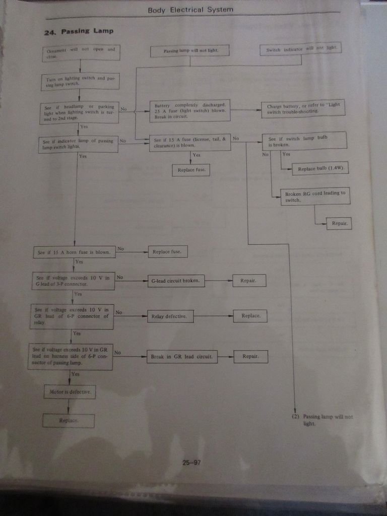

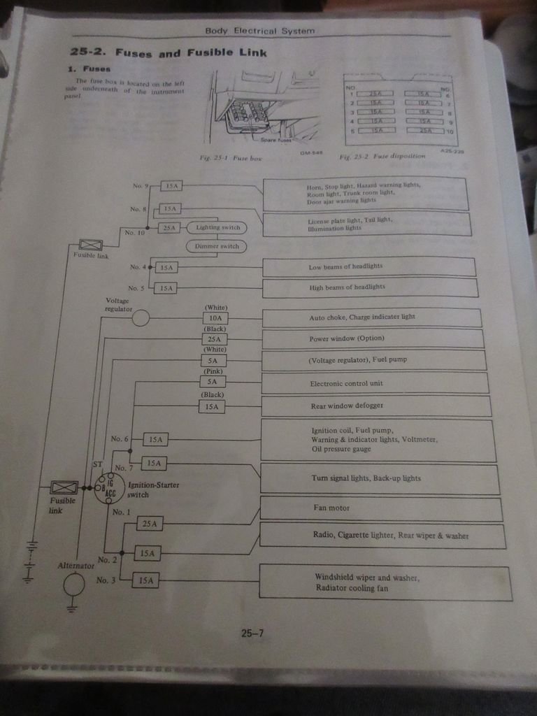

  5. Working on getting my passing light working too, maybe these can help you out, the black box relay looks like a frig electrical maze. Pictures are from a 81 factory manual I can scan them if you need better quality. Funny looked at the main wiring diagram nothing mentioned about the passing light, maybe it was an afterthought. Good luck

  25. I have an 85 factory subaru manual, I took a pic of the flow chart for code 64. I took a couple other pics of the wiring diagrams but for some reason the album will not let me upload them? I will try later. click on the picture for a bigger version. Good luck.
