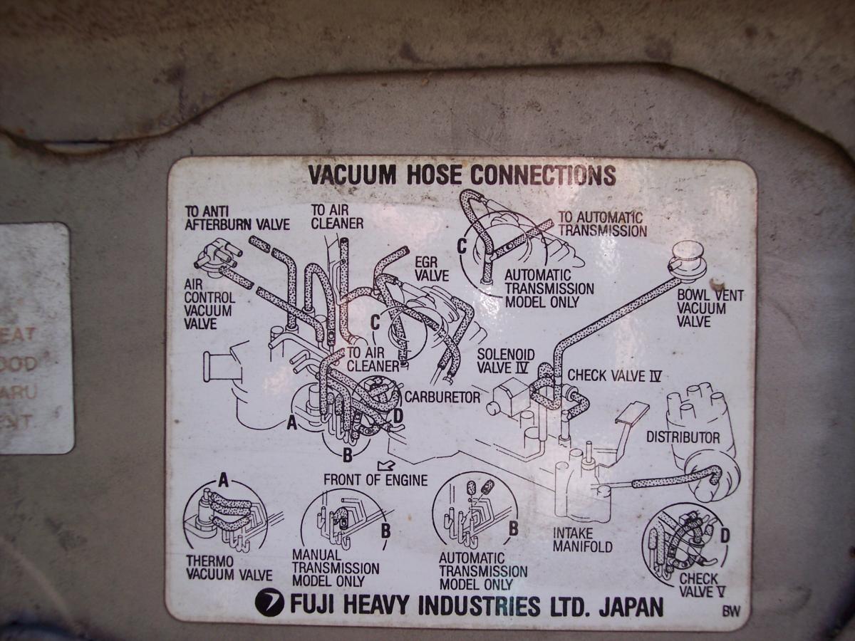

As far as the manifold goes, I screwed machine screws with loktite into all the unused vacuum ports and plates over the EGR ports. What I did find out here lately, now that the weather is colder and you need to defrost the windshield, it wont work unless you maintain a vacuum line to that dammit thing on the passenger side firewall. Other than that, the only vacuum line you need is for the distributor advance. Damned if it don't look plum sanitary in there now! Not happy with the funky air filter but I just saw a neat setup on here making an adapter to fit the stock Soob air filter to the Weber. My next project. -
