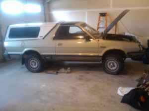

    New cv axle is in No more acceleration shakes!
