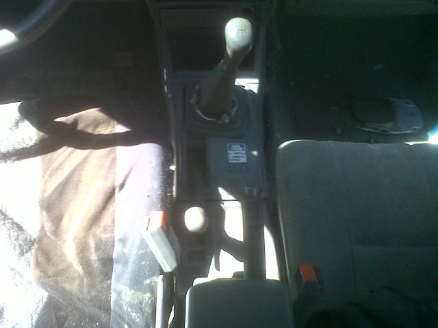

Hey guys! I completed my dual range swap but have some questions!! any help would be appreciated! So after my swap everything went okay,,, but eventually my clutch fork bent back,,, So my first question is: Are 4x4 clutch forks a little curved as apposed to 2wd clutch forks or did i bend it? Second what is the proper assembly for clutch forks?? i currently need to replace and have NO idea how to and my Hanes manual doesnt say how.... Car is a; 93 ,loyale, sedan, d/r swap, 5spd, 155k Thanks for any help, I can try to have pictures tomorrow.....
No it was a 5 speed prior to the swap. Just made It 4x4!
