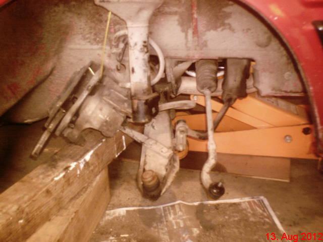

  20. Well it's all done. New bearings, seals and an outer axle boot. Most of the front end noise is gone and the play in the wheel is gone . I presume remaining noise is coming from the other front wheel but it is not enough to worry about yet. Reassembly went much faster than disassembly. The strut (which I had so much trouble getting apart) went back in easily by placing a floor jack under the knuckle and lifting up while guiding the strut stub. I used the washer/spacer technique for pulling the axle through and that worked very well. Hammer /screwdriver suggestions didn't work at all for me. Other problems I had to resolve along the way included: -- questions on seal installation, covered in a sidebar thread here: http://www.ultimatesubaru.org/forum/showthread.php?t=135413 -- banding on the boot replacement. The bands included in the kit required a special tool which I bought. Tried to use it and it just tore the buckles right off the bands. I returned the tool and bought some universal bands from Autozone for $3. No special tools required and they worked. Extra costs incurred for the project were: -- replacement bands = $3, -- 36mm socket =$17 -- gas for extra trips to the parts store= $20 -- big washers/spacer for axle pull =$5 With the original $36 for parts the total project cost out of pocket was $81

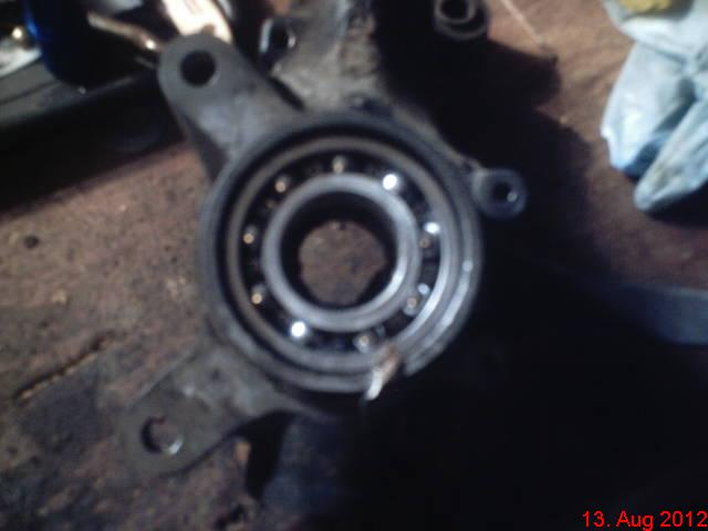

  21. After some research and dealings with the auto parts store I think I have this figured out. There are two type of seals, this is where I was getting confused. Apparently, some where in time, the vendors started substituting single type seals for double type seals. So when you ask for an inner and outer seal you may get one double and one single, as I did, instead of 2 double type seals which is what was expected to match the original equipment (OE). The OE seals, are the double seals, meaning they have a protruding lip on one side and the other side is flat and should look similar to this: These are installed with the flat side flush to the bearing so the lip is facing out. The single type of seals which have no lip and, typically, an exposed retainer spring on one side and the other side is flat and should look like this: These are installed with the flat side away from the bearing (spring side towards the bearing) and the flat face is flush to the housing. The double type seals are still around but you have to specify you want them and may require some lead time to get them into the store. These are definitely the better seals. If you already use sealed bearings, you may be just fine using the single type seals. Expanded use of sealed bearings may be the reason vendors are moving away from the double type seals. This is my best understanding and hope it helps. Another discussion on this was found here: http://www.ultimatesubaru.org/forum/showthread.php?t=108400

  23. '90 Loyale Sedan FWD Normally seals can only be installed one direction and to a controlled depth because of a flange on the seal. The wheel bearing seals I got can go on in either direction and the depth is not controlled by any flange. I didn't make note of the old ones when I took them off. Can anyone tell me the direction and depth of the seals when installed ? Inner Seal =========== The inner seal has an extended lip. I assume this goes toward the engine/axle joint ? Outer seal ========== The outer seal has an exposed retainer spring, I assume this faces toward the bearing ? For depth, do these go in until flush with the bearing or just until the top edge is flush with the housing of the knuckle ? thanks
  24. Decided to just replace the outer boot instead of the whole axle. Got the axle out - no problems there. I went shopping for the 2 bearings, 2 seals and a new outer boot and found a good set of prices at Costless Auto, about $36.00 I got the bearings in, went with the open style because they had a good price. Removed the old boot, cleaned out the joint and got the new boot on, just need to find a way to tighten the bands.
