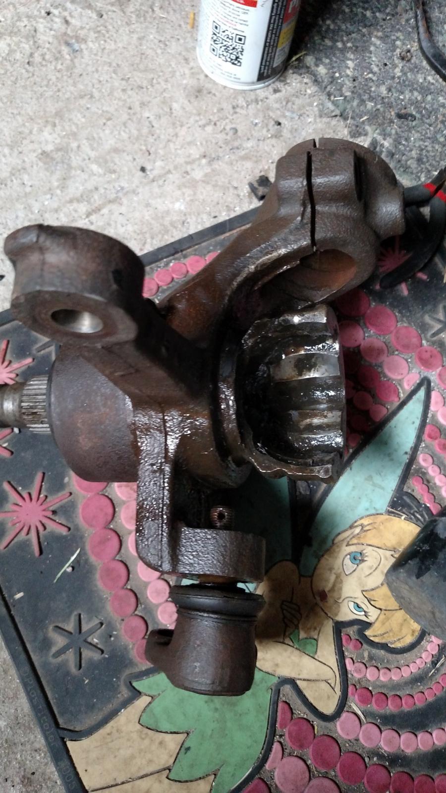

  2. I'm working on a 81 Brat. Doing the front axle, rotors, calipers, ball joint. Everything is rusted on. I soaked every nut and bolt with pb blaster and a super penetrant for 7 days. I only did that because I tried heating the seized parts and they still didn't budge. I used a gear puller and tightened it up best I can with out forcing it. Every day I went to spray it I turned the puller till the hub and rotor with the rusted on washers came off. The first axle popped right out with a good whack of a sledge. I did use a pice of wood to protect the axle. On the drivers side I did the same thing except the axle wouldn't budge. Since I'm doing the ball joint any way. I pulled the pin on the axle, unbolted the strut from knuckle and took off the crown nut on the ball joint connected on the knuckle. Using ALOT of force pushed the ball joint out of the knuckle Then removed the axle and knuckle as one unit. Placed the knuckle in my vise and slowly tapped the axle out. Good luck hope this helps
  3. I'm working on a 81 Brat. Doing the front axle, rotors, calipers, ball joint. Everything is rusted on. I soaked every nut and bolt with pb blaster and a super penetrant for 7 days. I only did that because I tried heating the seized parts and they still didn't budge. I used a gear puller and tightened it up best I can with out forcing it. Every day I went to spray it I turned the puller till the hub and rotor with the rusted on washers came off. The first axle popped right out with a good whack of a sledge. I did use a pice of wood to protect the axle. On the drivers side I did the same thing except the axle wouldn't budge. Since I'm doing the ball joint any way. I pulled the pin on the axle, unbolted the strut from knuckle and took off the crown nut on the ball joint connected on the knuckle. Using ALOT of force pushed the ball joint out of the knuckle Then removed the axle and knuckle as one unit. Placed the knuckle in my vise and slowly tapped the axle out. Good luck hope this helps
  4. this is all that was left of the axel
  5. well i ended up unbolting the ball joint from the control arm and finally the steering knuckle came off. i thought it would be a easy task but it looks like i did it the hard way. now that i have it taken apart do i just pull the seals one at a time till i get the rest of the axle off? this axle dosent have a hole for the cotter pin. is that normal? Also any suggestions on how to put it back together? i been useing the shop book but nothing has worked. thats why i ended up doing this the hard way.

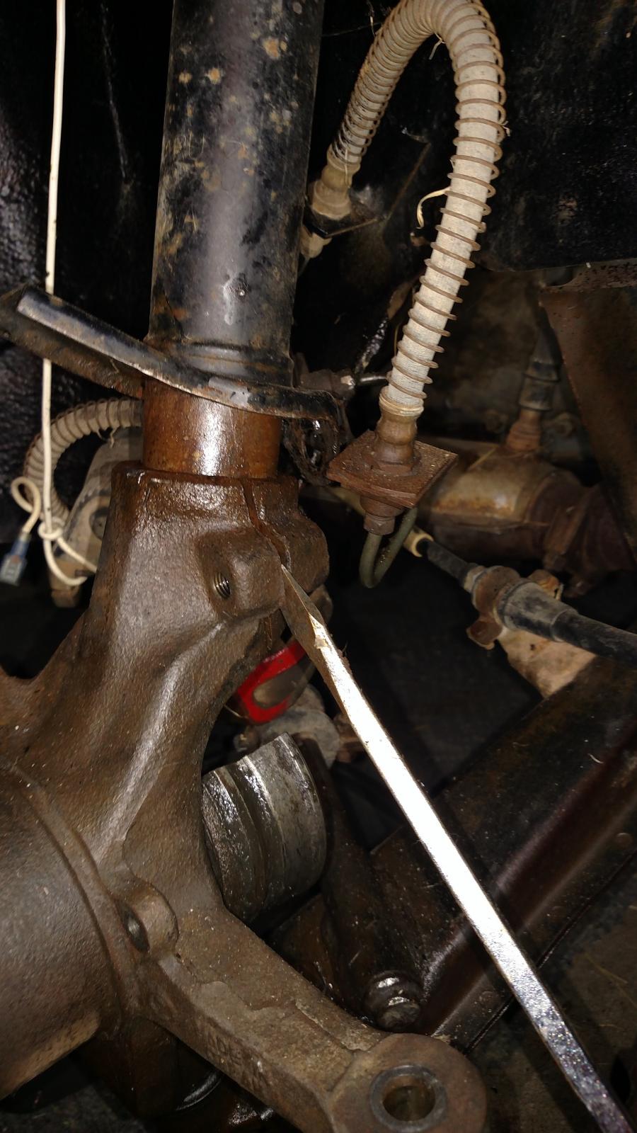

  6. strut wouldn't move with out having a screw driver wedge in. but wont move past halfway point. tips?

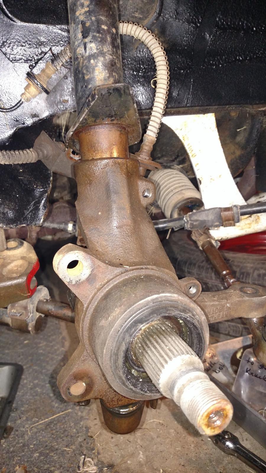

  8. Removed break calipers pb blsted steering knuckle getting ready to pull that and the busted CV joint out
