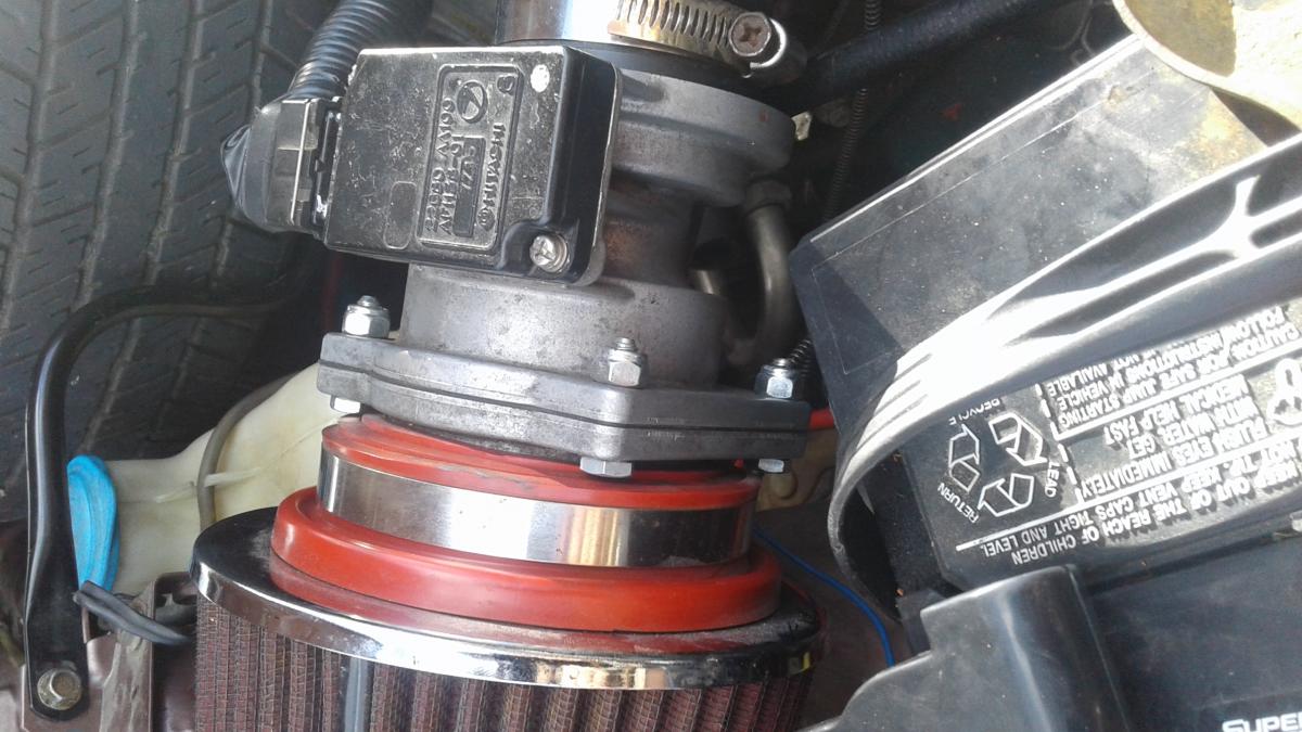

Codes cleared, maf cleaned, i just took a cutoff wheel and grinder and made my own maf adapter. Ran and drove great yesterday, think my oil pump needs a reseal because its ticking, but this tired old ea81 is on its way out, for my almost complete freshly built hicomp ea81, i didnt want to be working out the bugs on a brand new motor still in its break in period, and the way it flooded and backfired the first couple cranks, im glad i did it that way

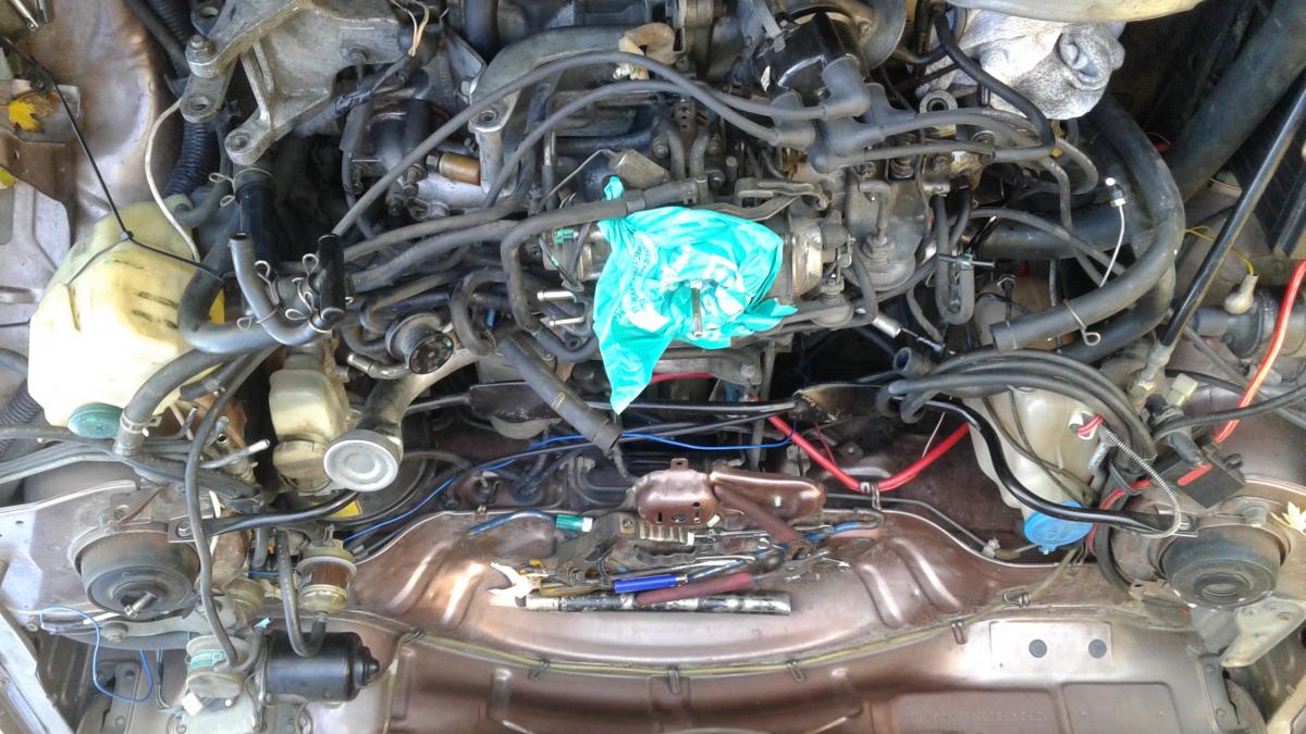

My carby when i started the swap. Also forgot i tried to clear the stored codes and it won't start with the plugs connected
