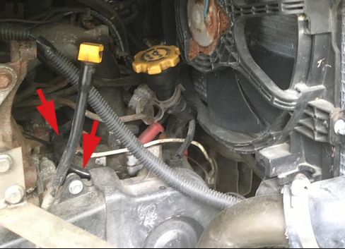

heartless replied to omacdon2's topic in 1990 to Present Legacy, Impreza, Outback, Forester, Baja, WRX&WrxSTI, SVXok that is not stock equipment on a subaru. have no idea what that is, or what it is for the location suggests something cooling system related, but sorry, no idea

heartless replied to omacdon2's topic in 1990 to Present Legacy, Impreza, Outback, Forester, Baja, WRX&WrxSTI, SVXare you referring to the black tube that I pointed the arrows to? if yes, this is a fairly common failure - this is a coolant tube, and it is still available new, but will also require you to pull the intake to change it (means you will also need intake gaskets) in a Subaru, this is a fairly straightforward job to do and does not take that long - but being this is in a VW bus, you may face other challenges - working space wise.
