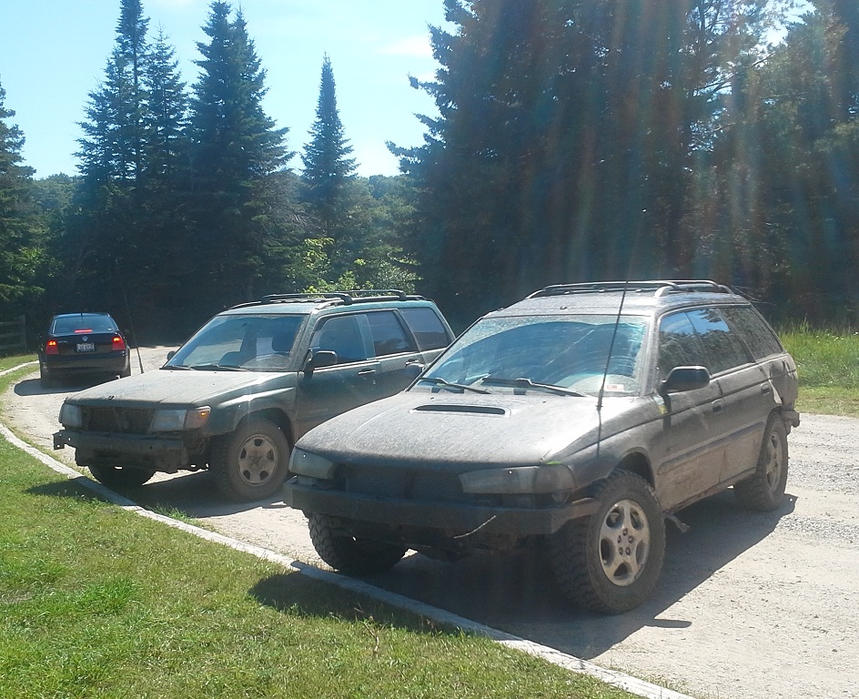

Here are some pictures from our UP trip.  It will probably be a while before I can edit the 10+ hours of video down to a reasonable length.
