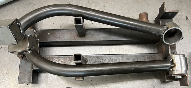

We decided to tack up a couple trailing arms for B's eventual billet rear knuckle swap.large.IMG_0740s.jpg.26e665c62ce8164e47b60b71d0e3fdf6.jpg

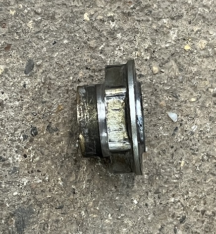

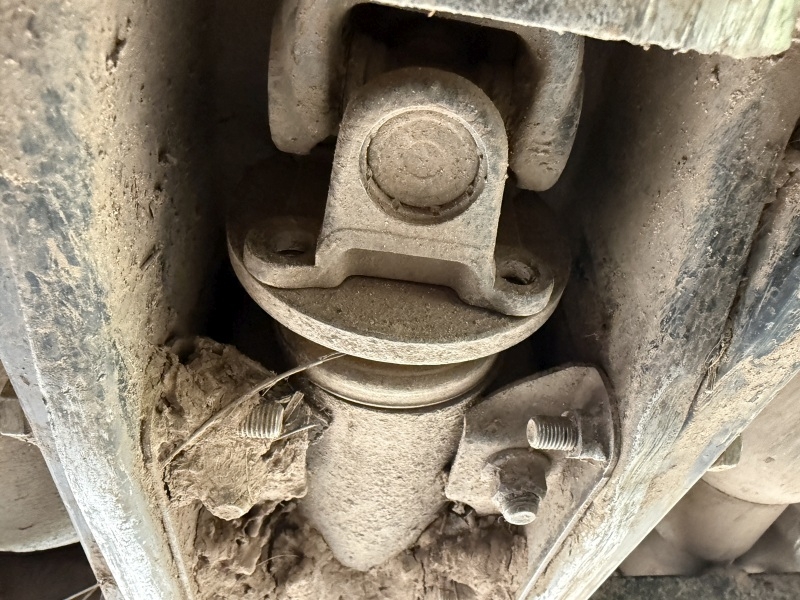

Our main focus was solving the axle issue in the 2002 Outback and I think we accomplished that.
The axle in place was definitely getting overextended and the worst case for that is slightly above ride height, so not surprising that it was more of a problem when the car was overloaded.
We measured a bunch of axles.  Unfortunately it took us a bit to realize/remember that the axles for the press in rear wheel bearings in the strut cars are a slightly different spline than the bolt in wheel bearings in the multilink cars.  Again, so much for Legos.  Of course most of the axles we have are for the strut cars.  The axle that had been in the right rear measures in between the pair I recently got from a junkyard.  So it might be slightly shorter than the one it had replaced which might have been the main problem.  Any of them would have probably been too short at the most extended position.  I added a 1/4" thick spacer between the axle and the wheel bearing.  With that in place there's a millimeter or two of plunge travel left at the most extended position but it will still go to full droop and be close to the limit of bottoming out the inner CV.  I vaguely recall making a thin spacer years ago but there wasn't one in place when we've taken it apart.  To still get a decent crimp on the axle nut with the spacer I modified it in the lathe.
A contributing factor might be that we replaced the rear diff bushings the last time we replaced the axle so the diff can't move around as much now.

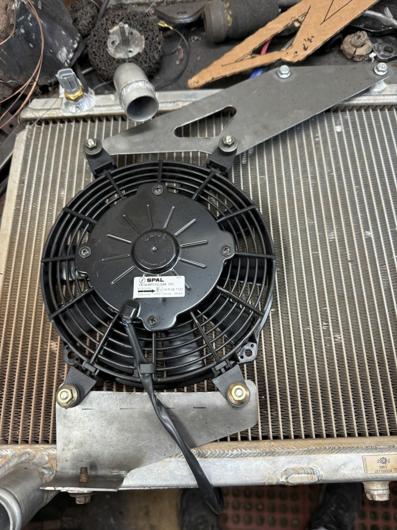

The main thing I worked on was mounting the full size Dodge van heater core and 8" electric fan under the passenger side hood vent.  B also pointed out there is room for about a 10" puller fan behind the driver's side of the radiator.

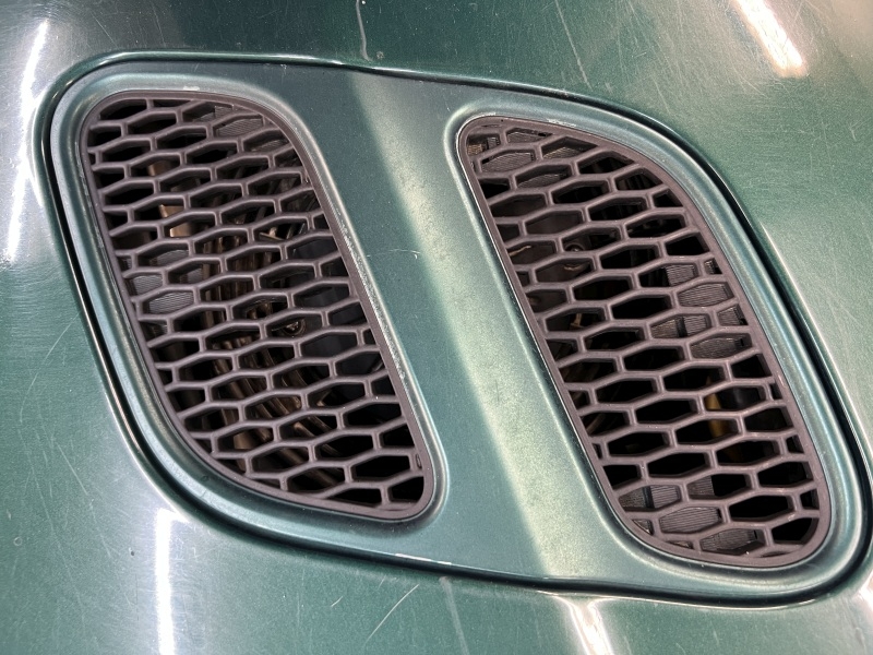

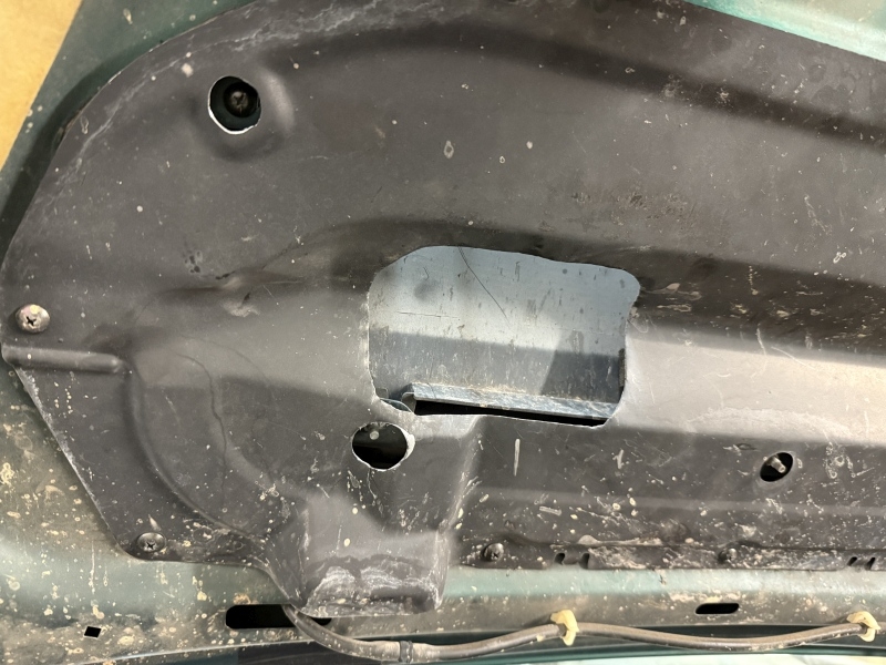

Fan lines up nicely with the hood vent.
Need to paint those brackets.  I might get some valves so I can bypass either the heater core in the summer or this one in the winter before I bother plumbing it in.  If anyone knows of any good selectable tees with the right size barb fitting on them I'm looking for one.  The only tees I've found are fairly expensive and threaded so then I'd have to get barb fittings too.  I could get one or two of these:

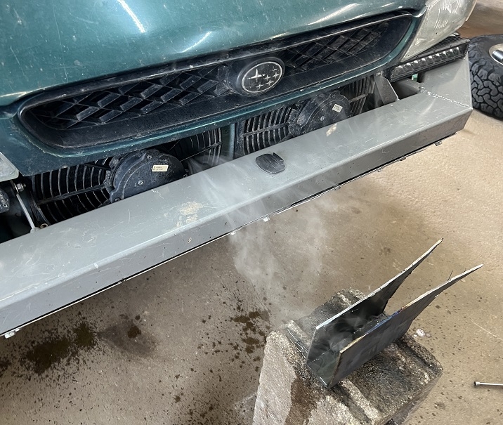

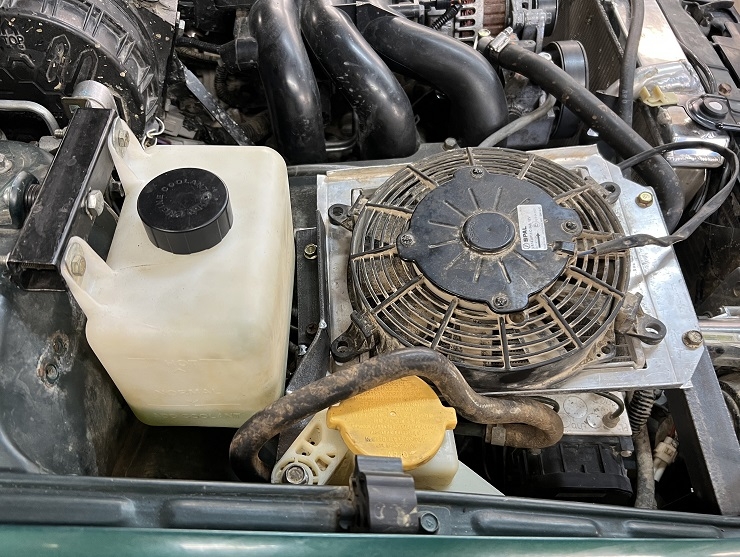

Painted the brackets and installed the extra cooler and fan in the Impreza.  Spliced a couple spades into the wiring for the passenger side fan (which kicks on second) for the small fan.
Here you can see it lines up with the hood vent fairly well.

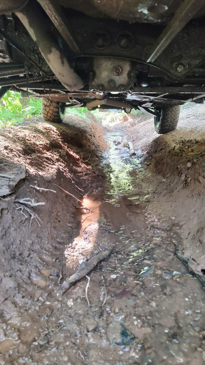

Sunday we started heading back on various trails. One of them eventually became deeply rutted and I didn't think I could get through without taking off a mirror so we turned around.
We came to a fairly long and deep water crossing where beavers had flooded a road. There was a muskrat swimming in it when we pulled up. I walked it and it was just below knee deep for a couple hundred feet. I drove through it in the Impreza after we removed the fan fuses. There was water over the front of the hood for a good portion of the crossing and we realized we should have stuck the gopro on. B crossed it in the Forester and then we put the gopro on the Impreza and I crossed it back the way we came and then back again to proceed. At the top of the hill right next to the stream was a cool old furnace of some kind.

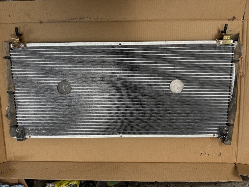

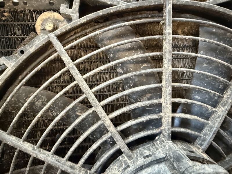

Best picture I have of the condenser fins (well OK this is one of the worst areas).
Replaced the condenser, slightly different (a little shorter) but it fit alright. Made some brackets and put the worst paint job I've ever applied on them for a puller fan on the driver's side of the radiator, wired that in with the driver's side pusher fan.

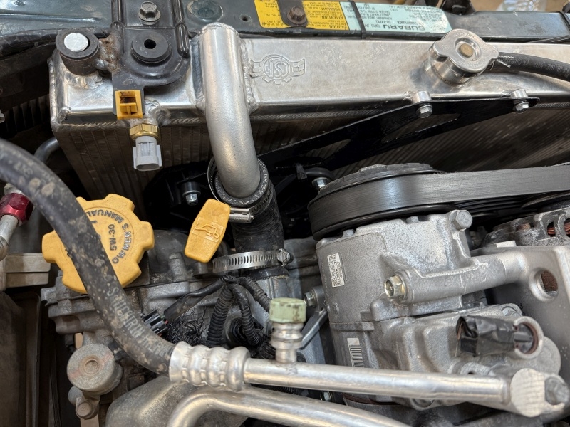

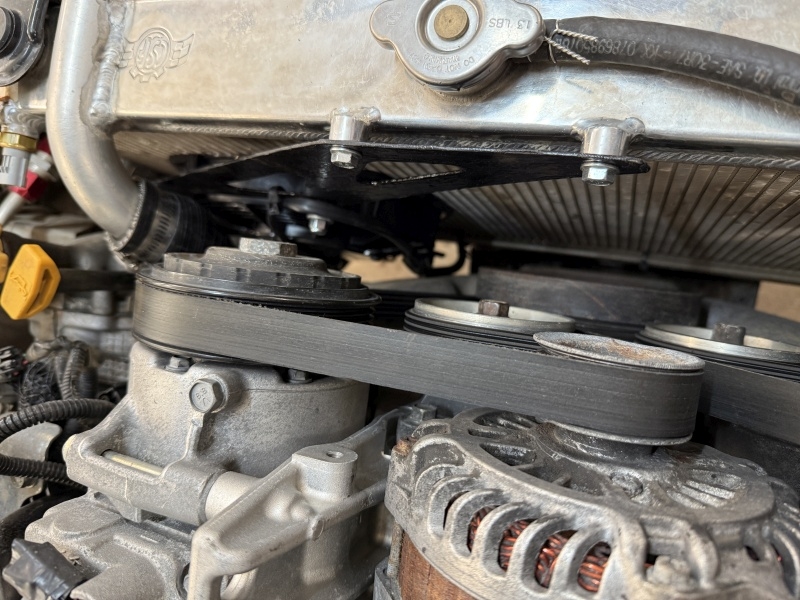

Also turned up some bungs for temp sensors and had someone weld them on top and bottom of radiator.
Hard to see in these pictures but the puller fan has some clearance to the engine.

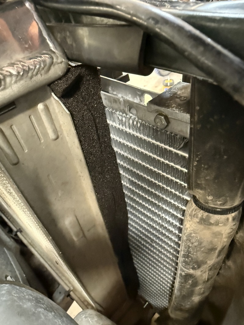

I glued a couple pieces of sheet metal on the fins where the center of the fans had been rubbing a bit.  Have had that problem in the past and this seems to solve it.
Sealed the sides between the radiator and condenser so hopefully less air can go around the radiator.

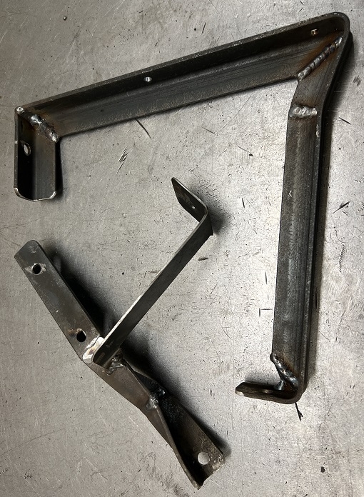

B did most of the fab work/fitting for a fan/heater core bracket to fit a 1980's Ford Econoline heater core (slightly bigger than the Dodge one that started leaking). Set this up so we can add a second one underneath after we remove the ABS unit. So far though, even without the extra heater core, temps seem stable even driving in stop and go traffic in 90+F weather with the AC on. And the AC works well. Cruise has not worked a few times I've driven the car in the last month or so, but then will work the next time I drive it, and usually works. One time I drove the car the clutch engagement was near the end/bottom of the travel, it's normally (before and since then) closer to the middle or top/start of the pedal travel.  All other times the clutch has felt normal.  After the last off road trip and I washed the car the rack had leaked some power steering fluid out of the slightly torn driver's side rack boot. Power steering was not always self centering with poor assist at low speeds for a while and the reseroir was very low but seems to be back to normal now and hasn't noticeably leaked in a while. Epoxied a couple of the studs on the hood scoop. Used a screw in the one broken off clip and clearanced the steel baffle plate so I can get at another one of the hood scoop nuts with the steel plate installed.

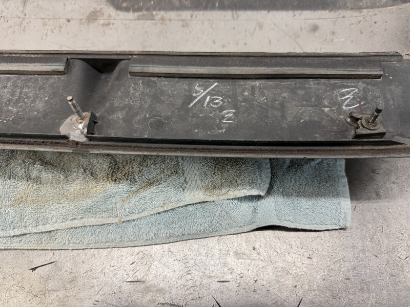

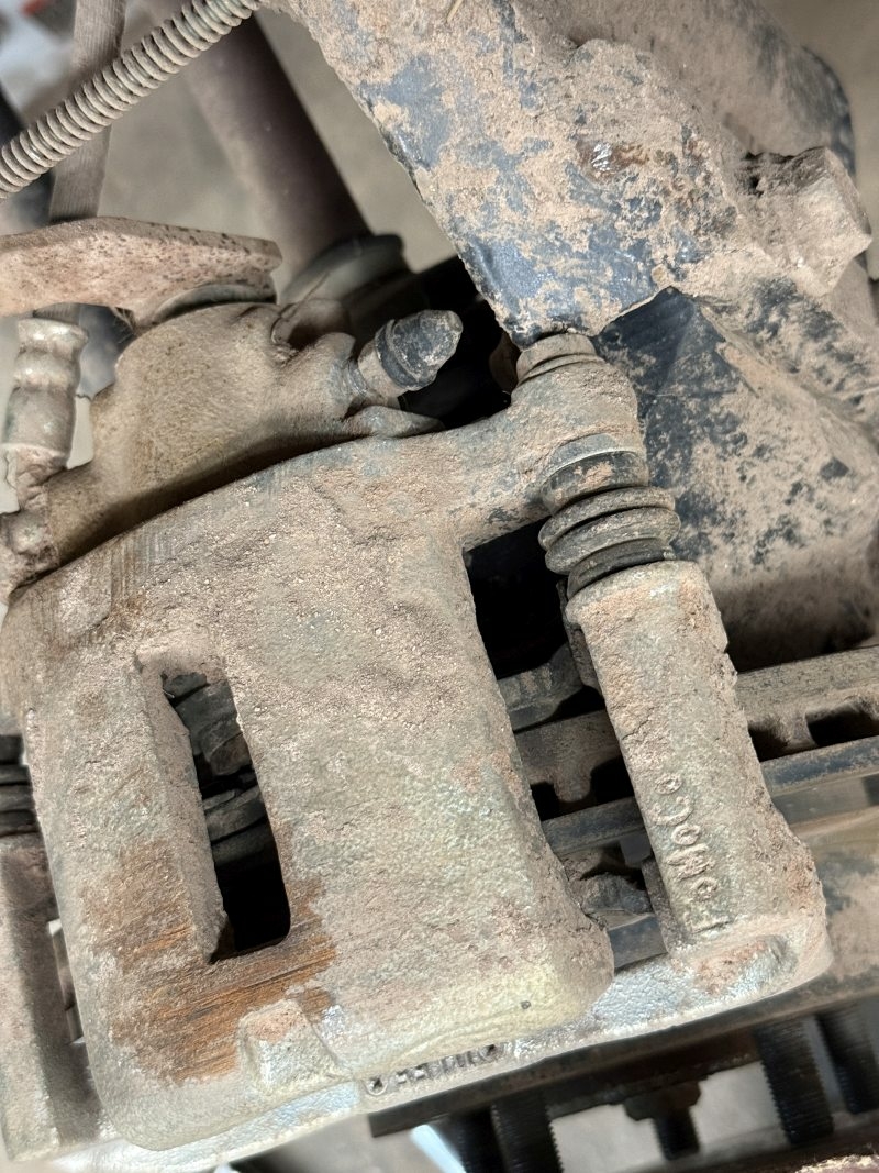

Car has pulled to the right slightly for a long time, we've checked the alignment a few times and it always seems good.  The right rear brake seems to drag more than the others.  I was going to replace the caliper and then discovered one of the bolts was starting to rub on the strut housing due to brake pad wear.
I unbolted both the calipers and ground clearance on the strut housings where those bolts were hitting (or going to hit).  So far this doesn't seem to have solved the problem but I might drive it a bit more first.
Oh wow, didn't foresee that issue with brake-to-strut clearance! Would be interested to see another angle of that.

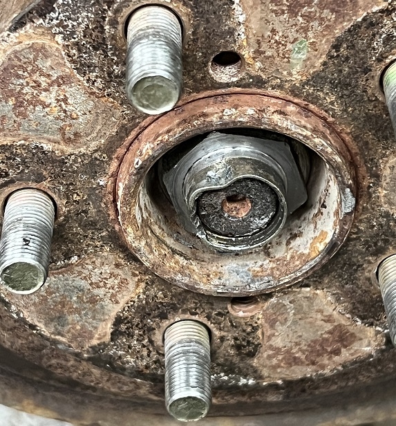

Tried to figure out which front wheel bearing (I assume) on my 2001 H6 OB is making noise but even using B's multi microphone noise identifying system we still can't tell.  Neither side is loose or seems to get hot but at least one of them is making a lot of noise.  Definitely louder or quieter when cornering so I assume wheel bearing.  We replaced one of the rotors we thought was pulsating figuring it'd be an easy try and it maybe pulsates less but did nothing for the noise.
