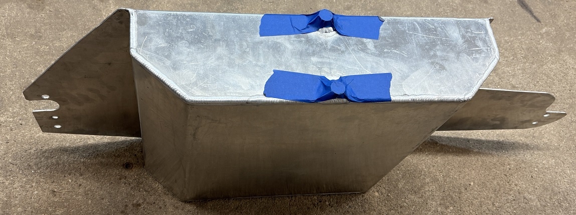

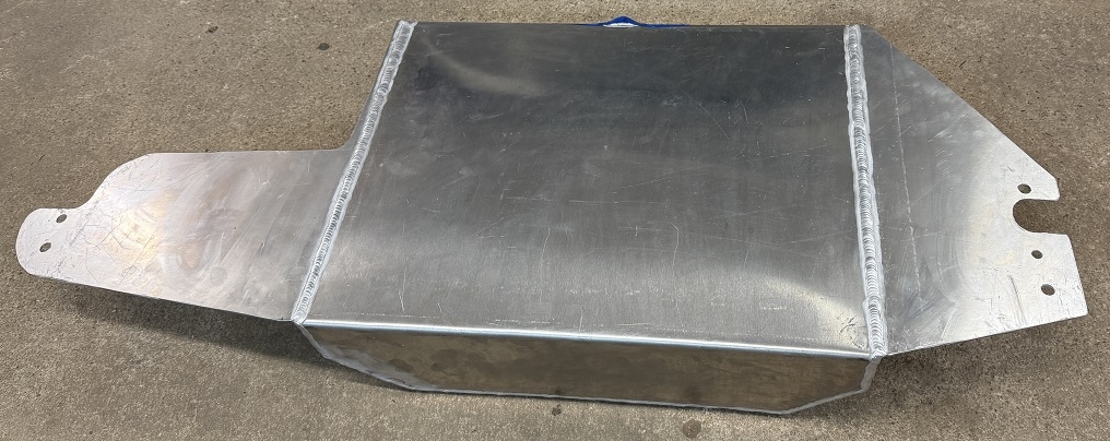

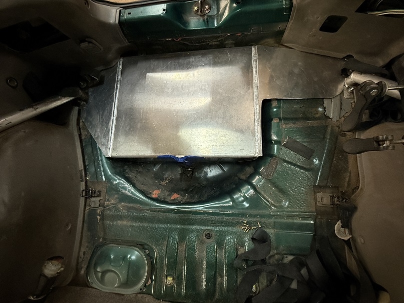

B and I worked on the secondary fuel tank for the Impreza.  I pressure tested it and flushed it out, seems like it doesn't have any leaks even at 30psi.  I got the mounting flaps carved up so it fits and matched up the bumper mount holes.
We had to do a little more hammering in the spare tire well.
We came up with a plan on how we want to mount the fuel pumps and run the hoses.  I need to get another pump, some hoses and fittings.  Going to try to get wire connectors for the ABS wires so we can use those for the fuel pumps since they're already running front to back and will never be used for ABS again.

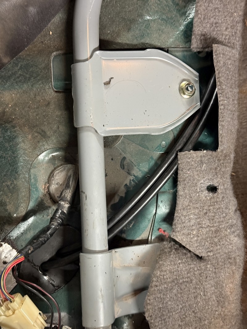

You think those ABS signal wires are heavy enough to run a fuel pump, or are you just using them to trigger a relay?
Good thing you have a cabin air filter.
Good point I'll take a look at the gauge of those wires.  Won't be under much pressure so according to the internet it'll draw 4-5 amps and even 22 gauge wire should be adequate.  Definitely not getting any relays involved.
Thanks again for the cabin air filter tip.  We were discussing how full of junk the evaporator would be without it.  Like the one on the black Outback was.
If you're planning on using a full-pressure fuel pump to deliver to the engine bay, the ABS wiring definitely won't be adequate. Plenty of people say the stock fuel pump wiring isn't adequate lol. But if you're just using a transfer pump to move from aux to main tank, maybe the current draw will be low enough.
I’d set it up as an aux Fawcett pump to transfer fuel from the aux tank to the main tank. Far simpler than trying to run a second high pressure pump and work out valves/relays to switch fuel lines to avoid back feeding and sort out the redirection of the returning fuel (unless you run a deadhead setup with zero fuel return).
This sort of thing is something I want to do with my brumby under the tray behind the cab where there’s a decent cavity.
Personally, I don't think I would trust ABS wires. Small gauge, and twisted pairs. Maybe use all 4 rear ABS sensor wires as positives, and then ground to the body
Using this calculator, default voltage drop and temperature, 14v, 5a, 12ft run, they recommend 14g. Alternatively, 22 g wire has about a 20% voltage drop.

Thanks for all the advice on this.  Good to have someone else looking over my shoulder making sure to at least warn me when I'm doing something I shouldn't.
Yes, we're just using these as transfer pumps.  One for each direction since they all seem to have a check valve built in, the only reversible ones I can find are pretty expensive.
14ga seems overkill for 5A.  I use 16ga for almost everything.  Will take a closer look at the ABS wires for sure, I like the idea of just using them for power and then grounding the other terminal of the pumps.  Will probably see what other wires are running back there we're no longer using too.

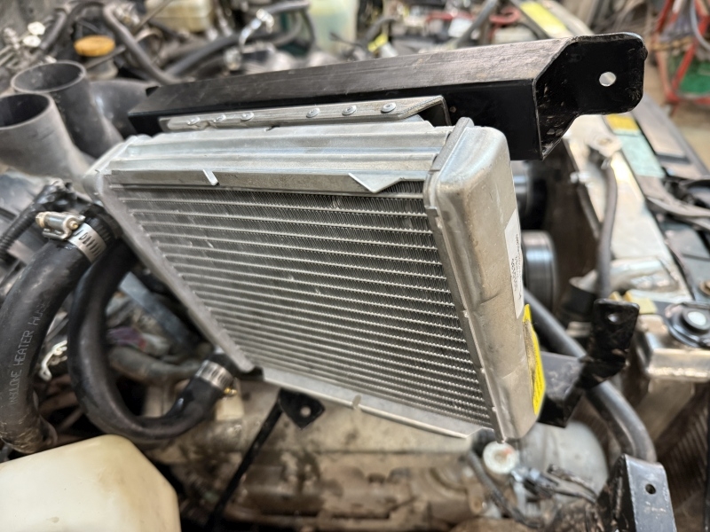

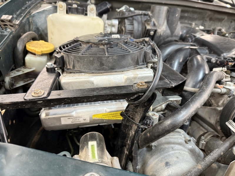

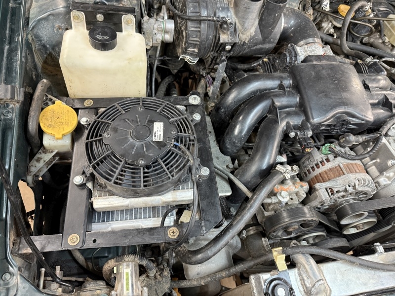

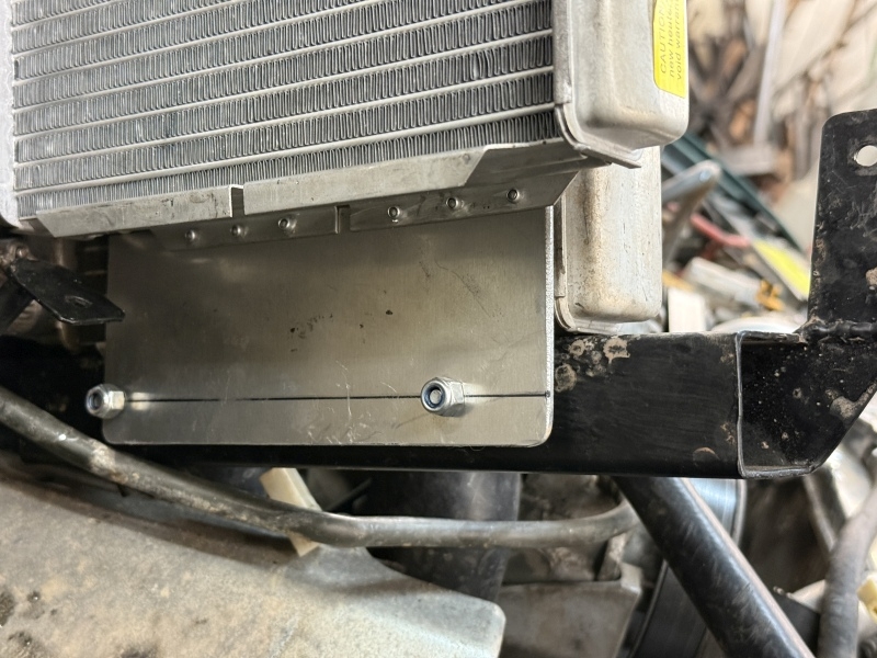

Yesterday we worked on my Impreza.  Still seemed like the radiator and condenser were pretty dirty so I got a long nozzle air gun and tried a few different modifications, this seemed to work the best.  Plugged the end (M6x1) and drilled a .15" hole in the side.  Then you can get that between the radiator and condenser and blast out one or the other.  We got quite a bit more debris out.

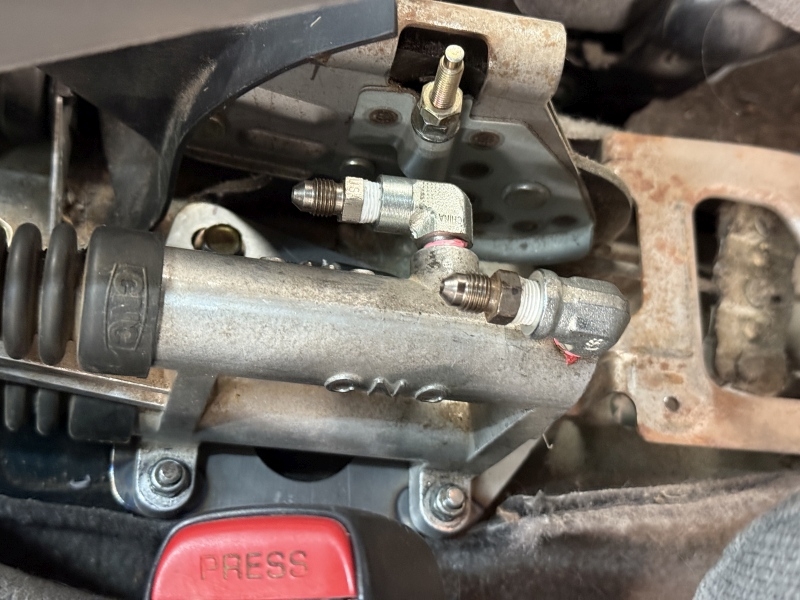

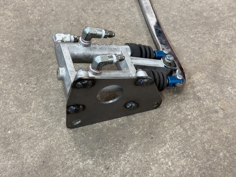

One of the two main projects I wanted to do this winter on the Impreza (other being the gas tank) is installing the cutting brake from the black Outback.  I made this bracket to bolt it next to the parking brake.

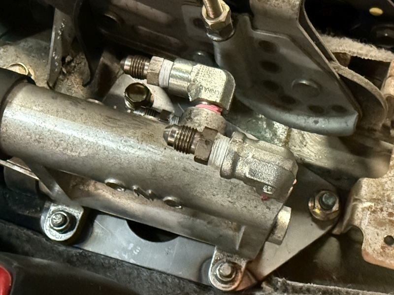

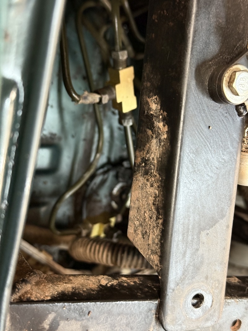

B replaced the ABS unit with a couple of tee fittings.  The one for the fronts is our solution for those lines.  B rerouted the braided stainless line we had in the black Outback from the master to the cutting brake, it was still in good shape.
Bolted to the cutting brake.
Bolts down using two stock fasteners on the top of the driveshaft tunnel.  It backed right up to the storage compartment in the center console so I plugged the normal feed location and plumbed the line from the master to the top (former bleeder location).  This lines the handle up with the coin holder in the center console (haven't cut that out yet).  Handle will be bent too.  I made and ran new braided stainless lines from the cutting brake to the bulkhead fitting under the back seat that feeds the stock rear brake lines.
We spent quite a bit of time and brake fluid trying to bleed it.  I eventually got it to the point that it was driveable and I could lock up the left rear tire but the brake pedal and cutting brake are definitely spongy.

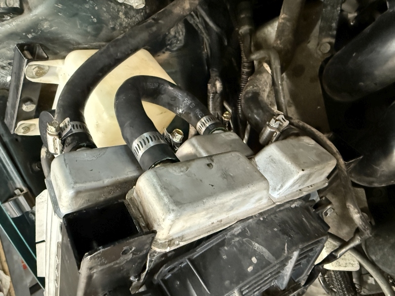

Related to this mod was adding another heater core under the one I've been using.  Hoping it will give me a little more insurance against overheating.  Plan is still to put the two small puller fans on the main circuit in hopes that the pusher fans don't have to run much.  They seem to shred plant matter and jam it into the condenser and radiator.  B and I did some mockup and made a couple brackets to bolt the second one on underneath the original.
That hose linking the two is definitely not ideal but I don't think it's closed off and will probably open up under pressure.  I do plan to put a barbed elbow in there to help though.  Should make sure the one closer to the fan is getting coolant first too.

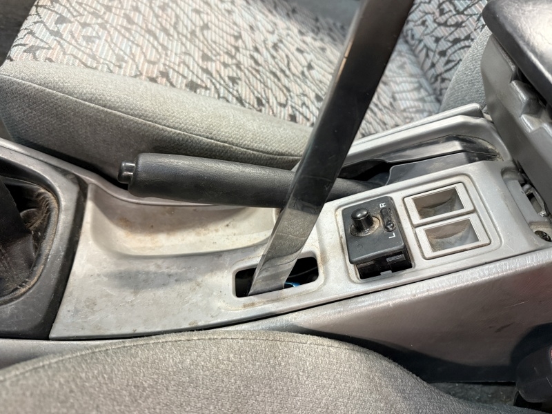

The cutting brake? Not heard that term before.
I’m assuming it’s a device to lock up one wheel at a time on the rear?
Eg: push forward to lock the right rear, backwards to lock the left rear, have I got this correct?
Poor man’s locker 😎
Edited by el_freddo
Poor man’s locker 😎

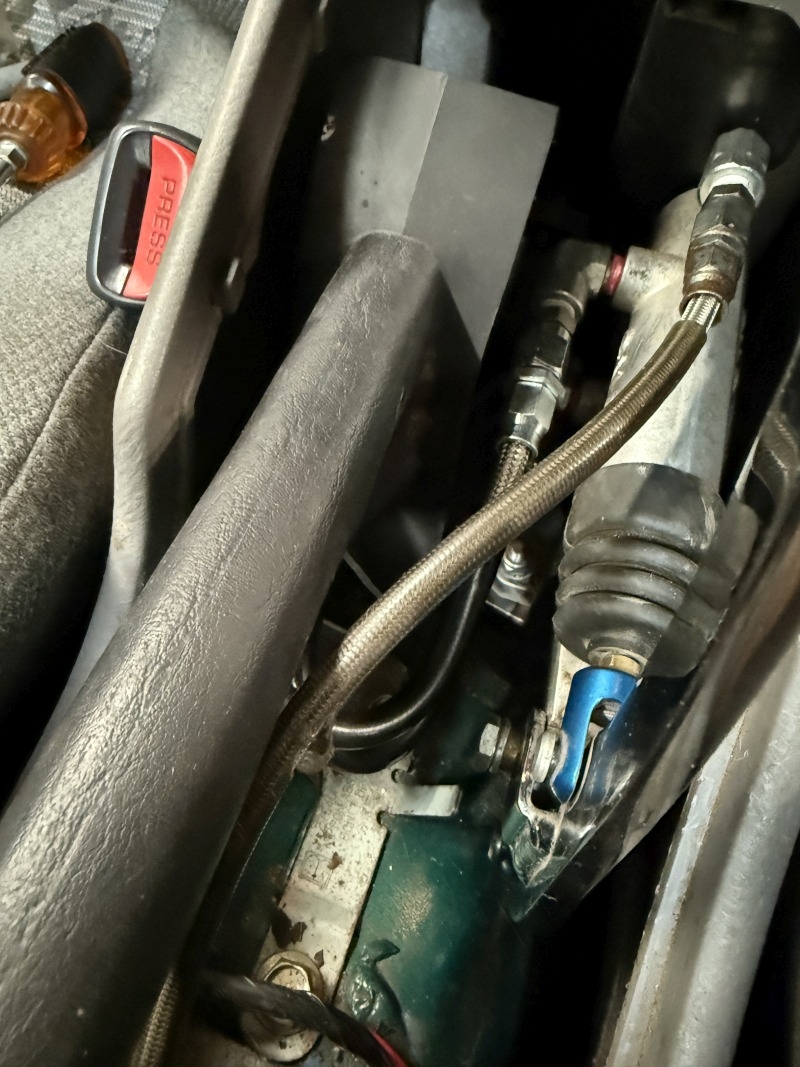

Yes except I have mine plumbed the opposite from your example.
It sort of works as a locker but mainly it's used as a steering brake.  It's my favorite kind of steering brake.

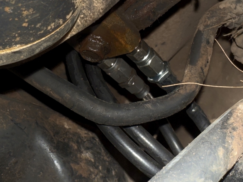

This shows how we ran the lines and how close the brake is to the center console compartment.
Center console reinstalled, handle lines up perfectly with one of the coin holders.  Mirror adjustment switch doesn't go all the way back in.
Ran the lines under the carpet and through the stock grommet under the back seat.
Connected them to the bulkhead under the seat.
I tried a different bleeding procedure which ultimately didn't seem to be an improvement.

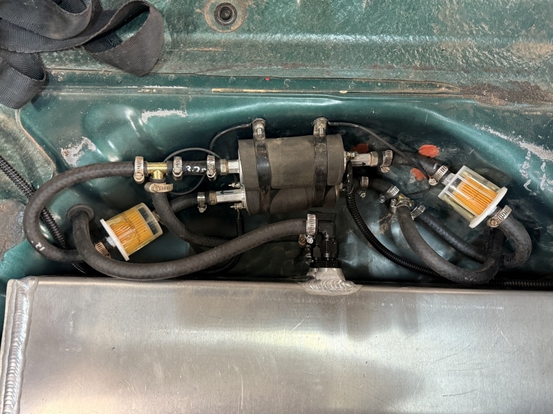

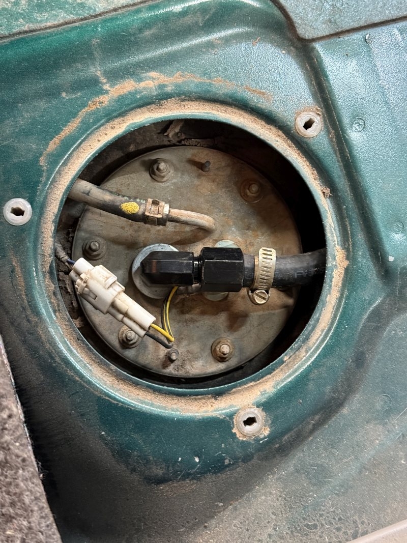

We finally got the secondary fuel tank project finished.

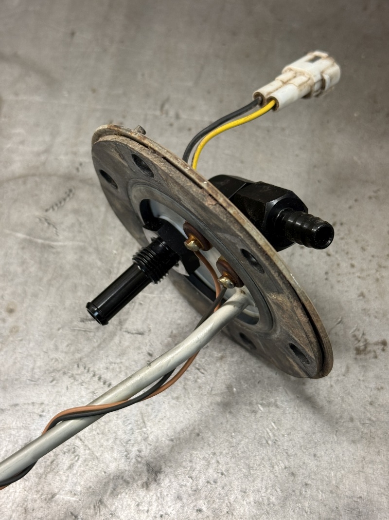

Added one fitting to each cover plate of the stock fuel tank.
Ran a fuel resistant hose down the side with the main pickup.
Mounted, plumbed, and wired the fuel pumps in the spare tire well.
It will probably take about ten minutes to fill or empty the tank.  Seems to work in both directions by watching the clear fuel filters, listening, and watching the fuel gauge.  Definitely looking forward to putting the extended range to use.

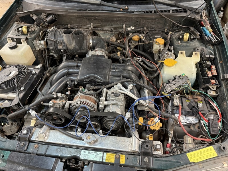

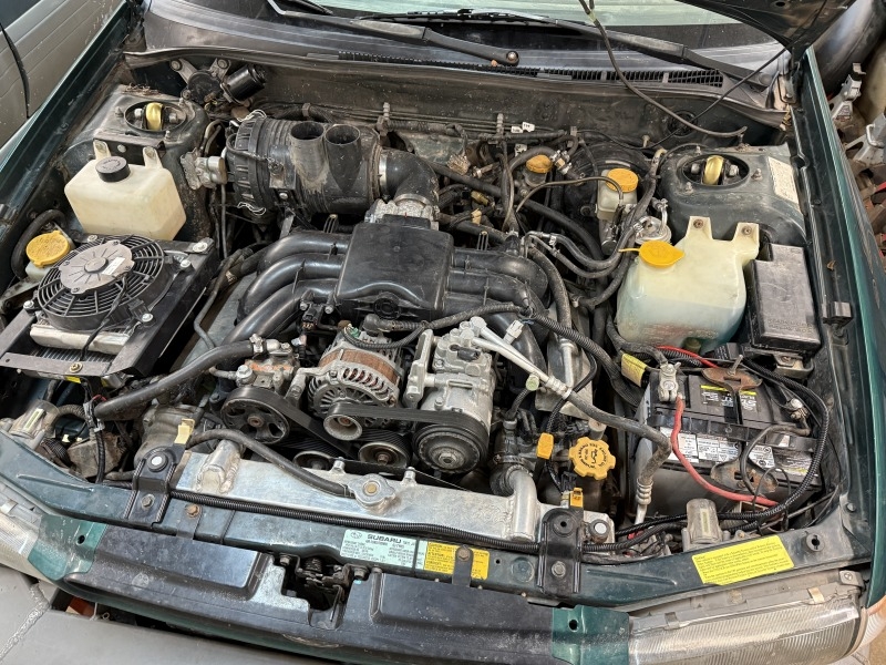

I rewired the fans.  Two small puller fans are on the main circuit.  Two pusher fans are on the sub fan circuit on a larger fuse and relay.  Main goal here is to push less debris into the condenser and radiator.  Another potential benefit is not blowing the fan fuse when driving in deep water.
I also wired in the temp sensors we added to the radiator earlier this year.

Have driven the Impreza a bit more and the bottom radiator temp sensor continues to be at ambient temperature the majority of the time.  One time after I was only stopped for ten or fifteen minutes it and the intake air temp had soaked up to about 50F and stayed there for the short drive home.  It seems that the ultimate temperature it reaches is in the 190sF at the top of the radiator and 220sF at the top of the engine.  That sensor on the engine is probably less accurately calibrated and generally just reads 10F or so higher than the ones in the radiator even when the car's been parked overnight.  I bumped up the temps the fans are coming on at so they're not running all the time once the car warms up.  220F on the engine temp sensor is basically when the temp gauge just starts to creep up above the middle.  Have now seen a temperature drop of 180F across the radiator (it's been cold here lately), so I think the radiator is doing its job.

Radiator bottom temp has been interesting.  Once the engine is up to temp the bottom rad temp will be anywhere from 100F-200F, never changing very quickly.  Occasionally all three will be within 10F.  Does seem like being stopped and/or periods of high load will cause the temps to creep up but not real consistently.  Block temp sensor and top rad both stay around 190-210F in normal city driving.

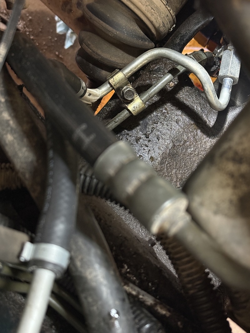

Think I fixed my power steering leak.  Replaced the return line from the rack which I'm almost positive was leaking.  Thing isn't even 30 years old, disappointing.  Replaced both o rings where the lines connect above the crossmember.  While I was at it I simplified/shortened the return line routing a bit.
