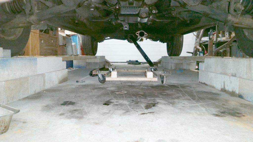

I have a rig to drop the Trans. I could come up with a way to test pressure. I have full FSM for 86 and 90.
Awesome. I guess its time to open up the FSM too the auto tranny trouble shooting section and follow the tree for "no drive in any gear". I still think you should drop that pan first. Keep us posted.

Setup for dropping transmission.
