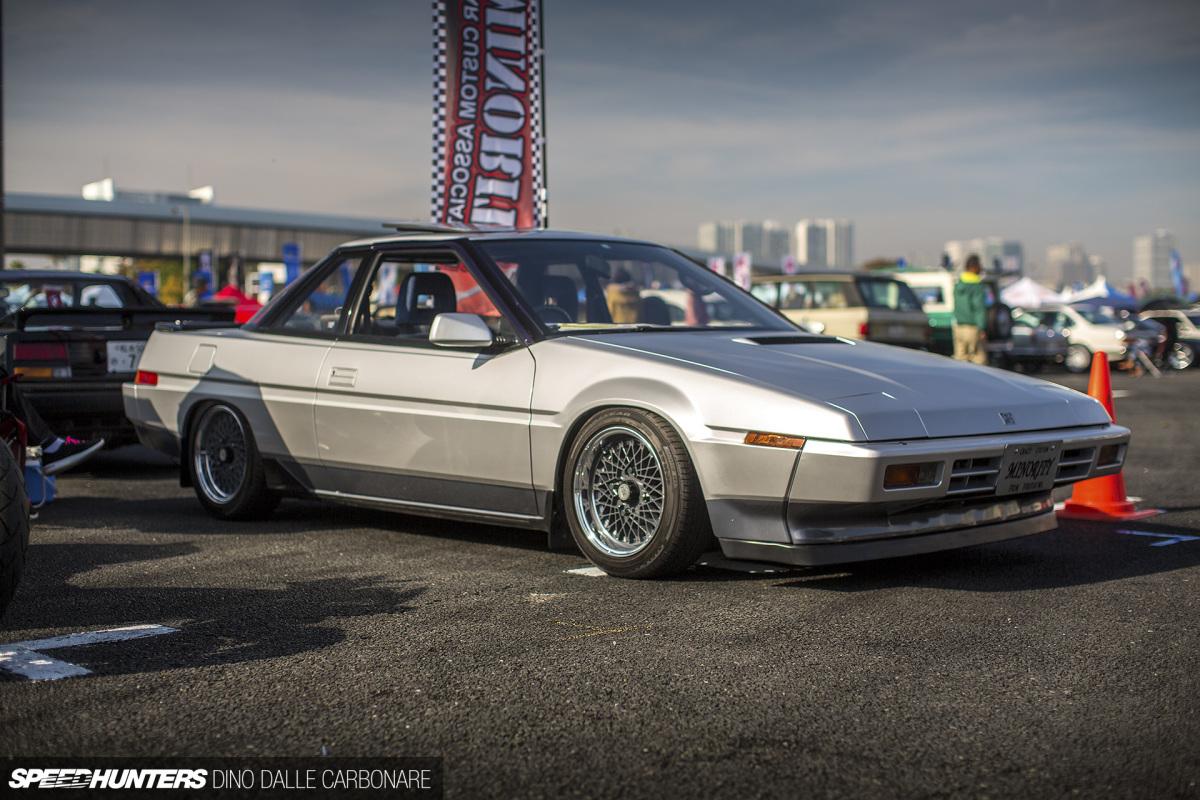

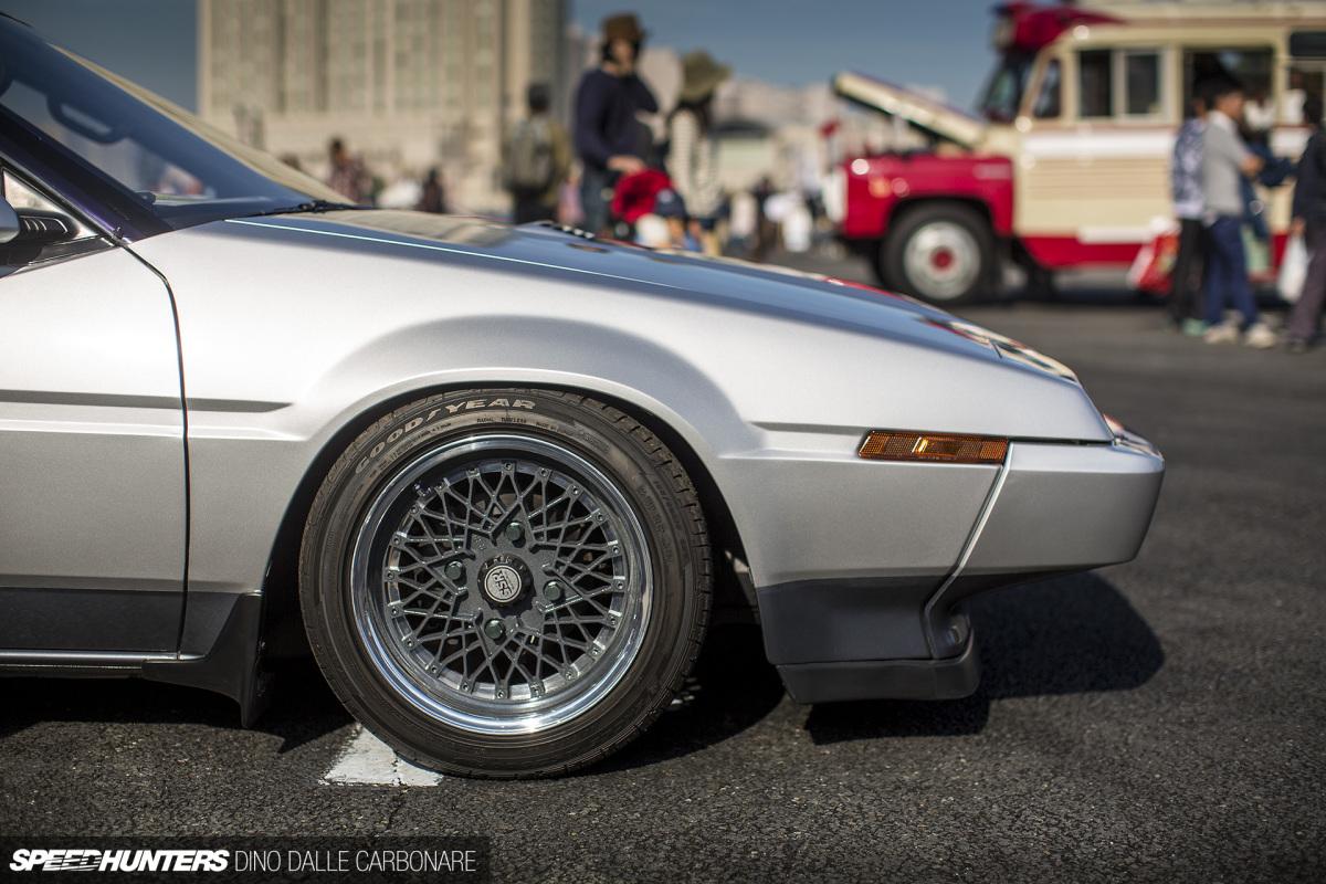

Blech, that's a terrible offset. So many better options.
There are several options for 4x140 nowadays, just expensive.
I REALLY like the ssr formula mesh wheels, $551 shipped, I want a set so bad for my xt!
