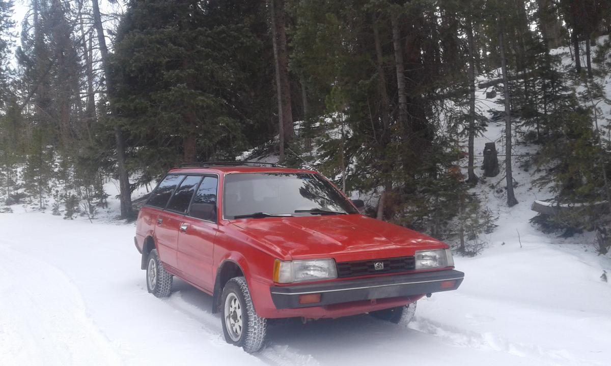

February 18, 20188 yr Post up a couple pics and specs on your ride! '80 GL Wagon 8 inch lift with SJR strut tops EJ25D 5 speed D/R Sammie transfercase 4.16 gears 30x9.5r15 Maxxis Bighorns Long travel rear shocks RCI 17 Gal fuel cell

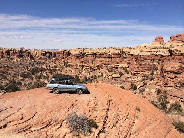

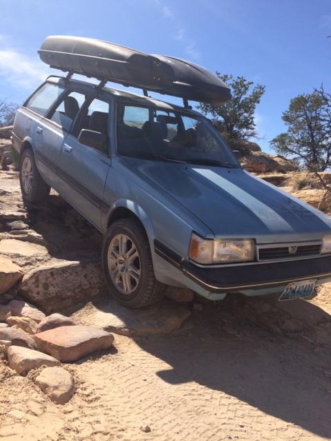

March 14, 20188 yr Nicely done.I think you have everyone beat as far as specs go. '84 GL wagon Homemade 4" lift. Original EA81 engine. Stock Hitachi. Junkyard 4 speed. Rear disc brakes and LSD from '86 turbo sedan. 29" BFG KM2 tires. Properly machined 6 lug hubs. Edited March 15, 20188 yr by 81EA81

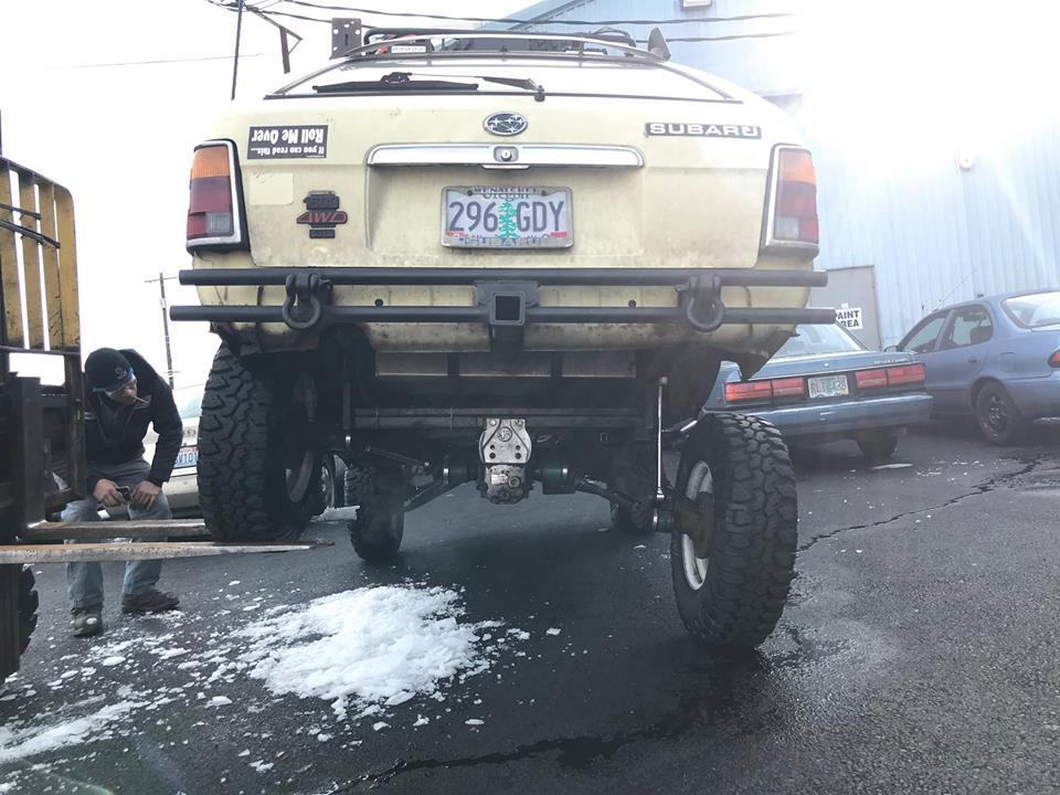

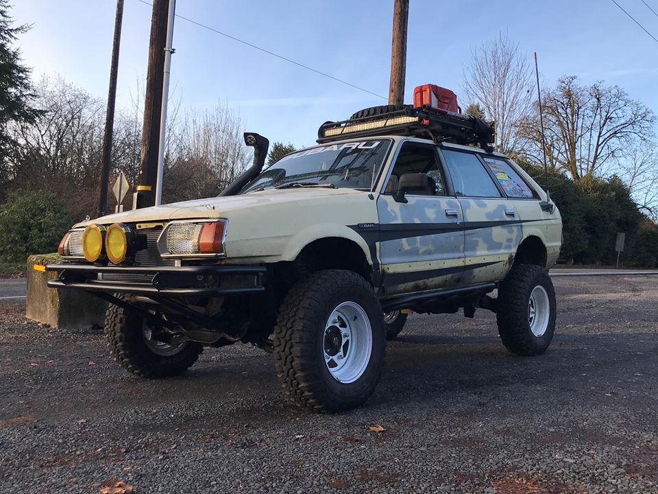

March 15, 20188 yr T-bone 84 GL 8 inch front/7 inch rear lift. Chopped and plated reinforced front Radius mounts. Cross braced rear. EA82 front axles, crossmember/ suspension w/ 1 inch extended, sleeved, radius rods. secondary front shocks (ea81 rears Lightweight subframe connecting front and rear lifts, also serves as carrier bearing mount for 5 spd driveline. Cross braced rear suspension blocks. Long travel (14") rear shocks with wheel well tower modification/punch up. Armored sump, rear diff and gas tank. Dual E-brakes. Welded rear. Snorkel. Forester fenders w/recycled quad fender mudflaps. 93 ported EJ22 w/ OBD 1 manifold/harness. Hacked IAC idle control. Hacked cooling fan control. 5-Spd, 3.9 D/R 4wd trans. 31x10.50 Wintercat studded snows. IMG_2879 by Dans Subaru, on Flickr

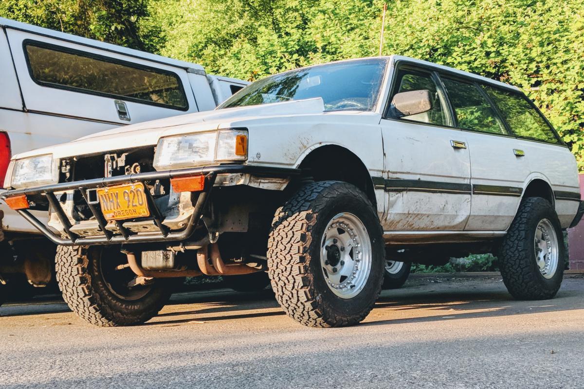

April 11, 20187 yr 82 Brat DL 5 spd DR w/ Jerrys kit EJ22 with ADF adapter and SPEC stage 3 clutch rear disc brakes reupholstered interior GL dash swap HID head lights full LED conversion 4" ADF lift EA82 front springs clocked torsion bars lowered bump stops PS conversion 6 lug conversion 15" Method Standard wheels 215-75-15 BFG AT TA KO2 Restored Snug top STi Spec C roof vent all new bushings new struts/ shocks new brake lines WALBRO 155 GPH fuel pump Custom 1 piece rear drive shaft JVC head unit with 4 kenwood speakers modified 1st gen A bar Nilight 22" light bar and 2 pods In the works: tube lower control arms and Forester knuckles/ struts/axles, Sway-A-Way rear torsion bars Edited April 13, 20187 yr by iluvdrt
