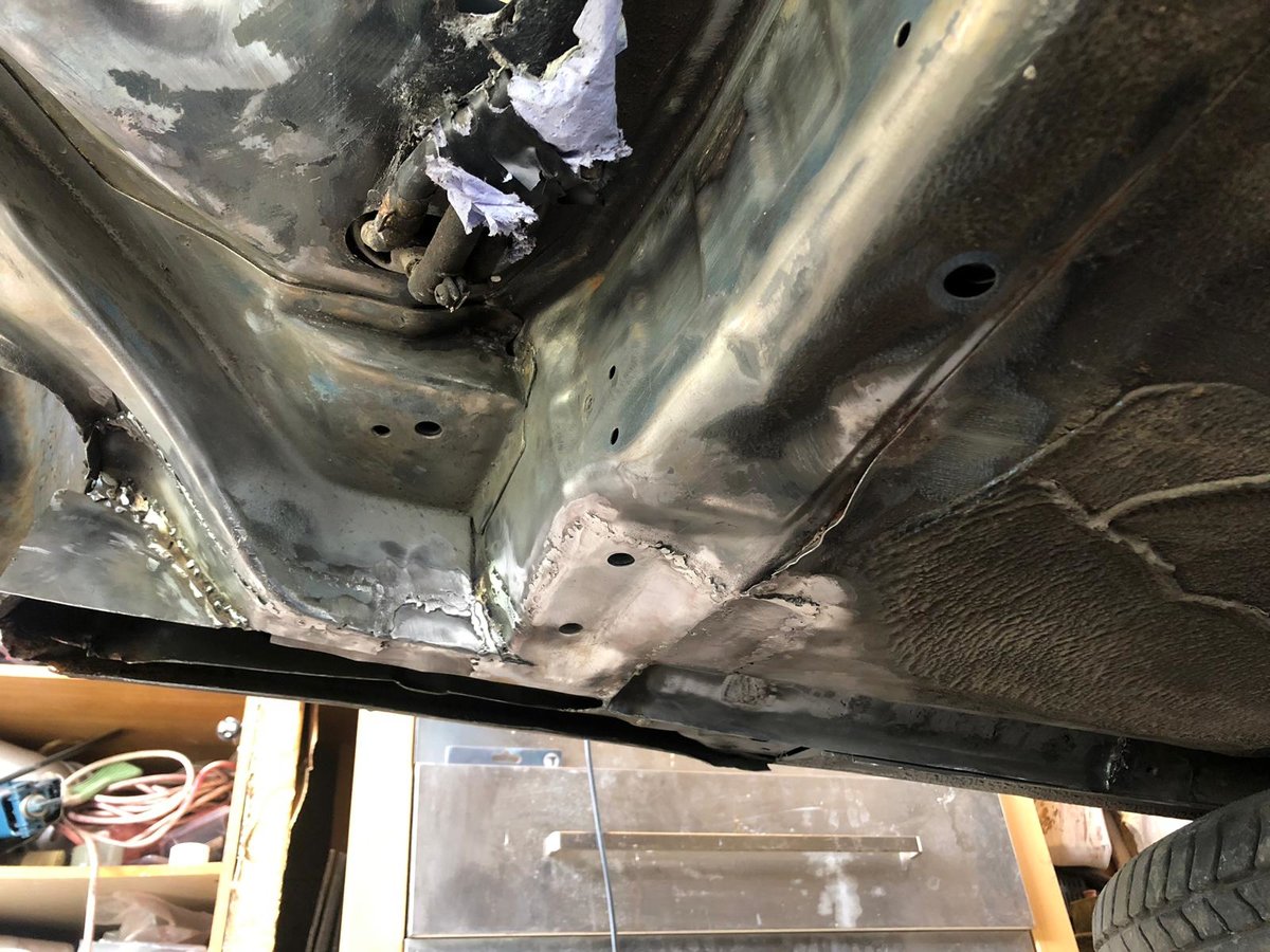

lovely day here on the coast of Wales.

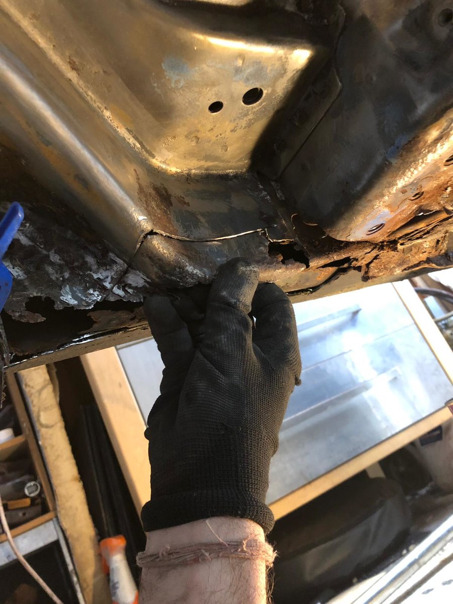

today, I need to add metal to my rusty sills ( rockers) and rebuild rear suspension attachments.
my welding skills are improving
i hope not to burn myself to much today #upsidedownwelding
i have to weld these pieces in ( see pics)
ive cut out all rust, removed surface rust with acid.
Today I will start to tack the metal in place and fabricate other pieces.
its quite a lot of work to shape and bend the metal. Plus not losing any  lines or dimensions.
ive already done the other side.
so this is less daunting.
After ive repaired this section the rear underside is fully repaired. Behind the cabin floor pan.
i will epoxy prime, base coat in correct 572 space metallic blue and 2k clear.
(my car was originally painted 518, blue and white, i’ll respray whole car original colour in future.)
i can think about reattaching  the rear refurbished suspension and brakes to the car.
i still have the rear wheel arches to do too...

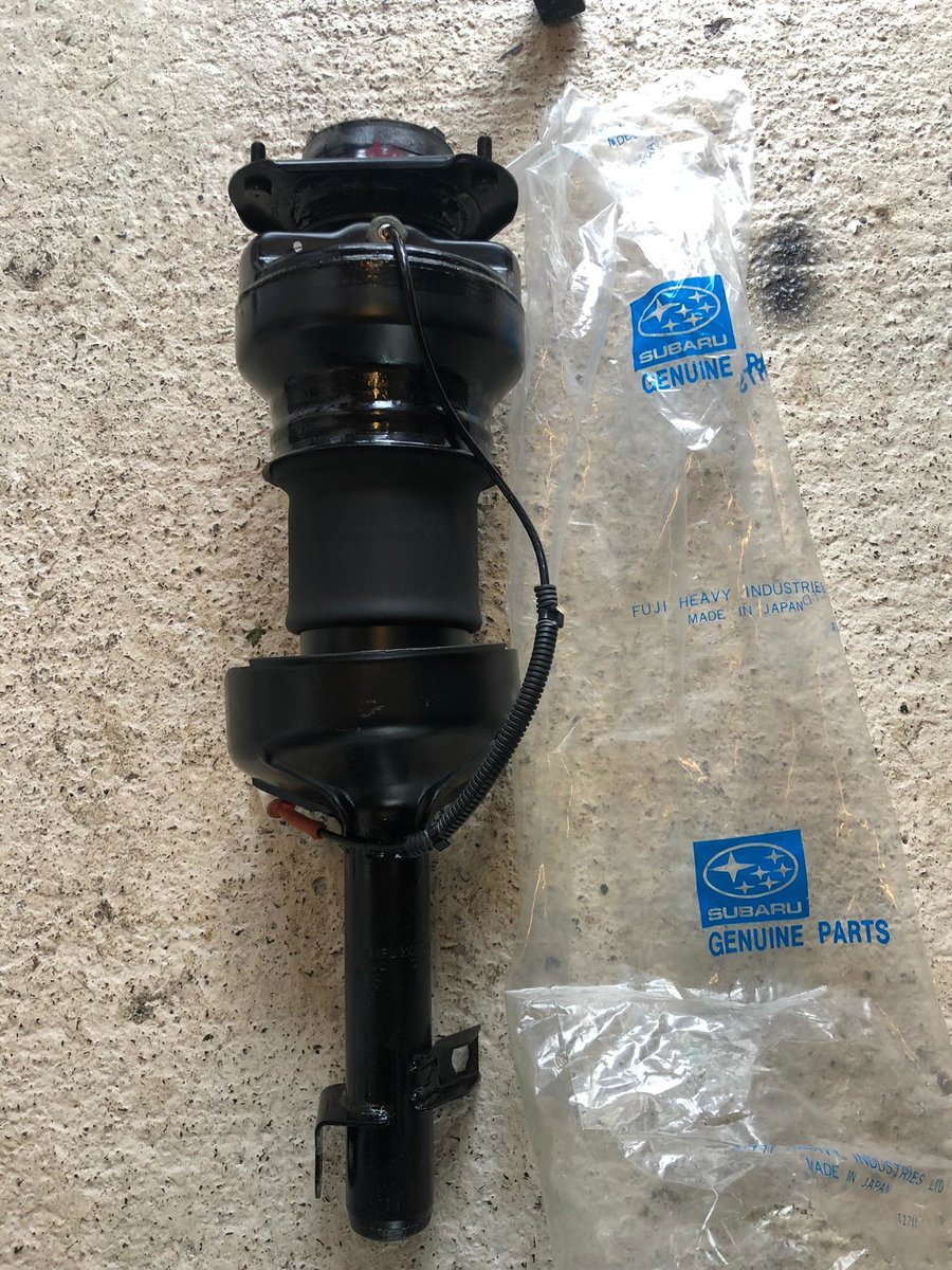

The bottom pic is of my most prized possessions... one of 2 brand new (old stock) front air struts..
imported from USA!
anyone got a pair of rears they want to sell?

We are just mere men incapable of performing actual miracles, but I think your xt will be to differ! I know she is feeling the love. But patience and persistence pays off!! Excellent!
Those struts are gorgeous man you must be stoked!

Afternoon guys.
hope your all well.
here are some pics of progress to date.
ive finished welding underneath (rear)
ive cut out the rear wheel arches and some inner arch too.
i had to use the rubber wind deflectors as my template to remake wheel arches
As rust has eaten the metal away behind them!
i very happy with the results
ill have them welded up next week and hope to weld in place next week.
finally the rear bodywork is nearing an end.
