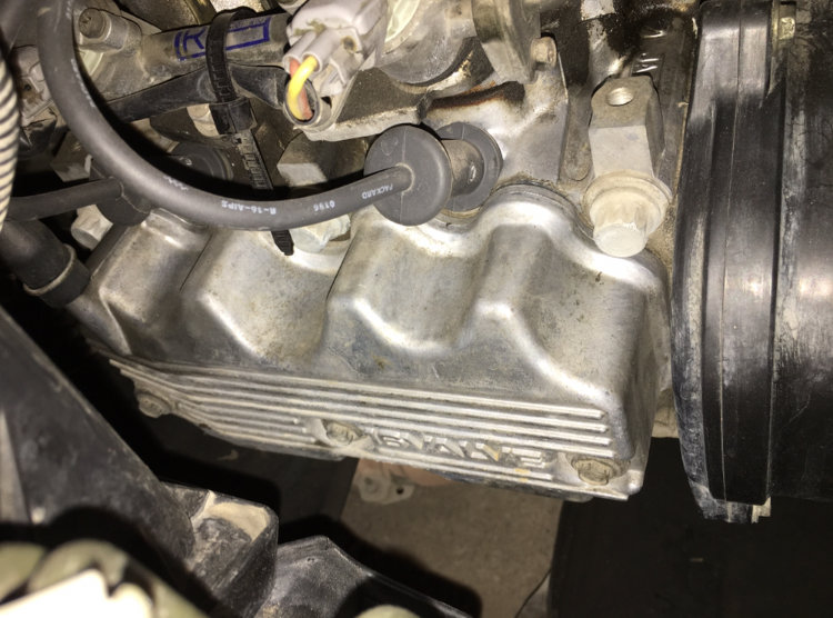

Whilst my Fuji-built EDM Legacy from 96-97 would ‘appear’ to have the interference NA EJ22 (eg. solid valve tappets- I haven’t actually checked that yet), it does however have dual exhaust ports.

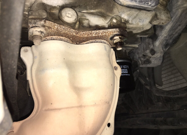

The heads and headers on the 96-97 EDM NA EJ22:

Apparently (according to the dealer) my heads have solid adjustable valve tappets, but combined with dual exhaust ports.
