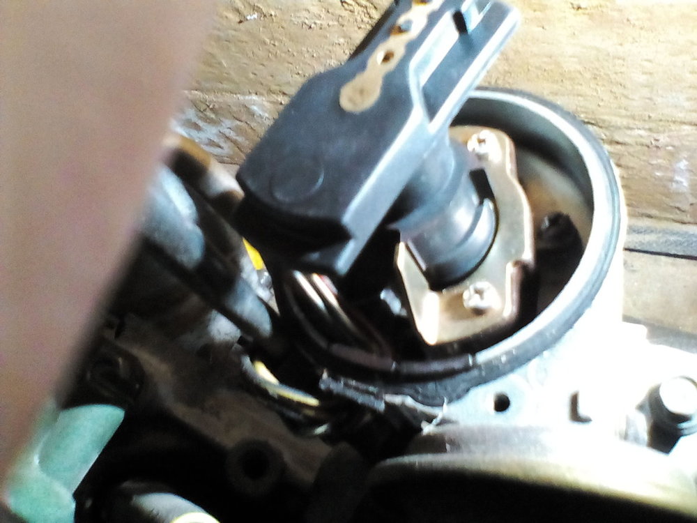

Thanks for all the replies you guys. I've had problems with this car since I've had it. I have another thread I can link to in a few minutes that tells about the troubles I've had. Since I replaced multiple sensors and what not, the #3 head gasket went out and was leaking coolant into the cylinder. I had a set of heads cleaned up and given a valve job, installed good used lifters, and got the 2 special o rings from the dealer for the cam tower. Car is running now but it seems to be firing too late. The cylinders getting filled with too much fuel or whatever. And I'm only getting about 22mpg. Before the head gasket went out I tried to check the timing and it would die when the connectors were hooked up also. I just don't know what to do now so i can time it accurately.

I pulled the distributor before the gasket blew and noticed the previous owner or the owner before them had pulled it too. There was a mark where the rotor should be when at tdc on #1, same thing with the gear on the bottom of the distributor. That was when I found out the car would die when I tried to hook up the green connectors. I got it as close as I could to where it would run at the time. It runs well around 3k rpms, but it's just drinking the gas.
I would do a total do over starting with checking the belt alignment with distributor pulled.
Line up the center III and verify cam pulley marks are as such Drivers up passenger down.
Then bring it around to zero on the timing marks to the pointer and drop the distributor back in and that will set approx mechanical timing and then connect #1 plug to the cap and that will be the starting point towards success... going off what somebody else scribbed is not always good place to start.. they could have used that for a mark for When they pulled it out..  which is indeed ttc for cylinder #1 but not always full proof.. who knows if it even the right distributor/gearing..

The way I set my early turbo static is to get #1 on TDC not#2
Then nudge it to the timing mark
Then pull cap to line up one of four points of star thing on post with the other thing as depicted,and ensure rotor is pointing at #1 terminal post in cap underside
Fires up and drives nice every time

I just pulled the distributor again tonight, making sure #1 was at 0* tdc and placed it back in the cam tower in the middle of its adjustment. I plugged the green connectors in and timed it to 14* btdc. After unplugging the green connectors, there is no change in how it runs.
