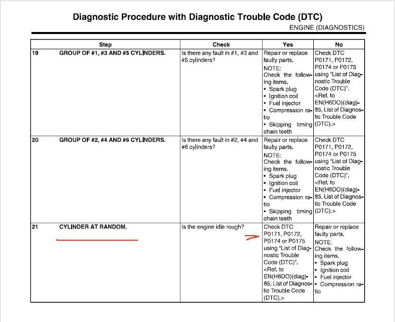

In the FSM, the diagnostic for misfires on all 6 (the last of 21 diagnostic steps, but the only one that addresses all 6 cylinders) and no other codes is:
Repair or replace
faulty parts.
NOTE:
Check the following
items.
• Spark plug
• Ignition coil
• Fuel injector
• Compression

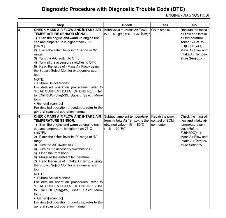

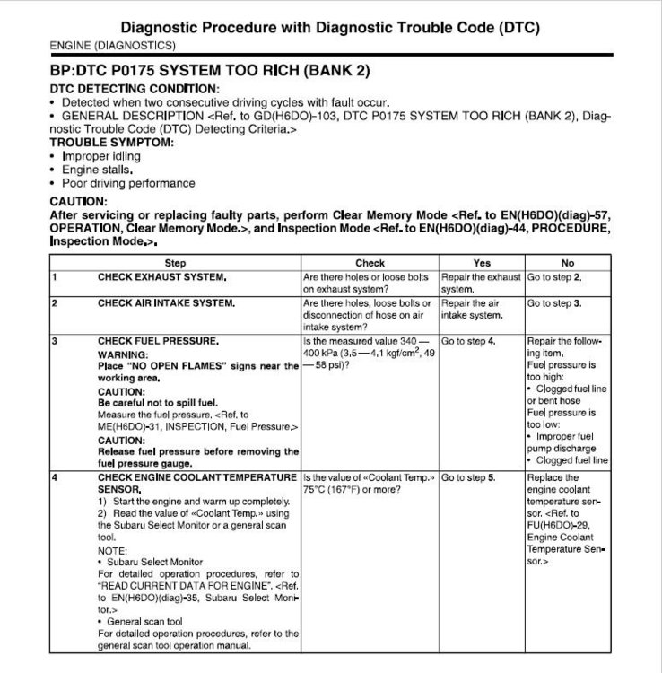

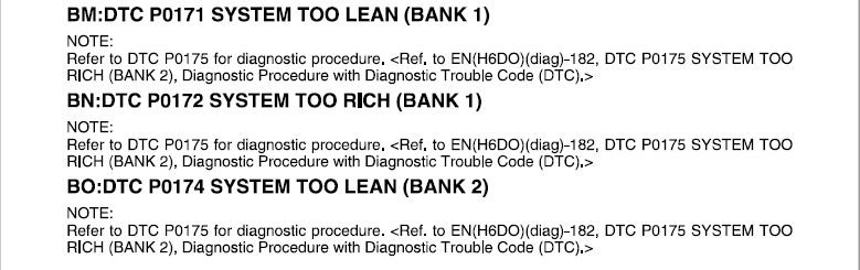

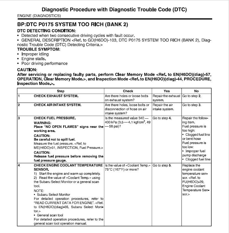

I found this in the FSM. Hope it helps.
It shows 6 things to check that can cause misfires on all 6 cylinders.
